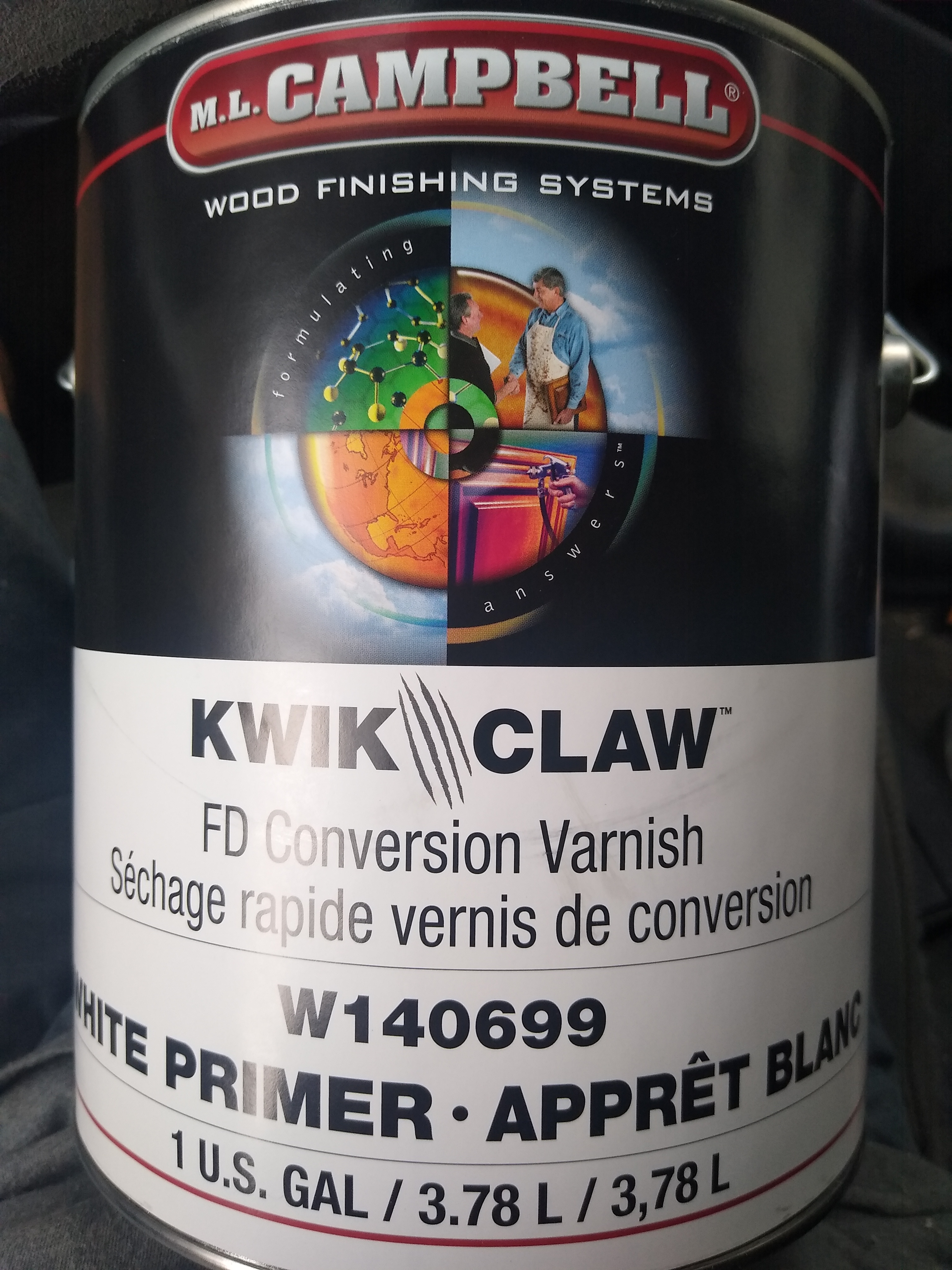

For those of you who are using MLC product
They will be phasing out clawlock 2 and it's been replaced with kwik claw
Still a 10:1 ratio catalyst
It is a fast drying primer, ready to sand in 30 minutes
When I asked my supplier if they had any,he said yes and gave me a gallon to try it
I did last week
It does dry very fast.after drying the surface felt pretty gritty but when I hit it with 220 it got very smooth!
And it didn't take much to sand
The specs says to thin 20% but I felt like it was a bit much
It got very thin,so I will call and talk with my sales rep and see what he says about that
Other than that it seems to be a good product

Here is the PDF for the PI sheet for Kwik Claw
MLC_Kwik_Claw.pdf
10/23/21       #3: MLC new post-cat primer ...
It doesn't actually say how much time to pass before sanding. Only that it is quick to sand.

20 - 30 minutes recoat time indicates that the material should also be ready for sanding, no?
I prefer Level Sealer with colorant added if I want a high build, quick drying catalyzed primer.
