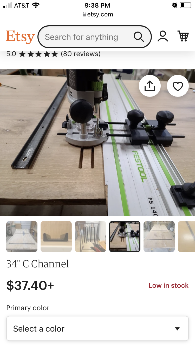

Going on the premise that it will come back eventually, would it be possible to force it flat right now by adding c channel to the bottom? I have a friend who has used these quite a bit to hold them flat. After all, a wide slab will be prone to cupping with the plainsawn grain in the middle and the radial grain at the edges.

The link didn’t work, how about a picture instead.

I should be using C channel.....I have not. While surely will help with future movement; I am skeptical it would work to "force" it back to flat

No one "should" be using steel under a wood table. With properly dried wood and worked with the understanding of how wood moves, it's totally unnecessary. How many centuries of table making do you think have gone on with no steel under a tabletop? I've been working wood for 50 years this fall. Not once have I put steel under a tabletop.

i've done the c-channel (uni-strut) thing before to try to "reflatten" a table top. it didn't work for me. your experience may be different, but i think it will be a fruitless adventure. the guys doing this, and for reasons besides keeping it flat, are doing it when the piece is already flat.

Rich C, why is it no one “should” use a piece of steel to hold a top flat? If a design or style doesn’t call for the use of a breadboard end, or apron below, what is wrong with it? It does the job. While the design and style are not of my liking, someone must like them as you see a lot of them being made these days.
With the radial grain at the center of a wide slab, it will always want to have some face deflection from flat during seasonal changes in humidity, properly dried or not.

To me it's about craftsmanship and study of your medium of your choice. I know that flat sawn from juvenile trees (or logs sawn through and through) will always move or cup, so I don't use it. I never use flat sawn wood for a wide tabletop so I have that advantage. I don't ever have to fix up something that will be known to cup or move. Slapping steel on the bottom has been done wrong so many times, and it causes more trouble when slots are not used for the screws. That C channel system has very short vertical legs. That is where the bending strength is. I also know that uneven finish or lack of air moment around panels is also a disaster. It's been written about very often and I trust the knowledge of the others that came before me.

Well Rich, I guess you can’t teach an old dog new tricks. To clarify my point, we are not talking about slapping steel on the bottom. The C channel is very rigid, much more so than angle iron. It clearly has elongated holes to allow for movement. On a 10’ long top you could put 4 or 5 of those on and it will help immensely. I have seen many wood island tops made this way. The last one was made of two15’ long, 21” wide Bookmatched Sipo boards. In the modern style of the kitchen, those where the only way the maker could hold them flat. I’d consider that use of the metal “necessary “.

Are any of the SAPFM guys putting channel iron under their tables? The lumber that came out of old growth 500-1000 year old trees used in early American furniture is nothing like we see today. The high end shops on the east coast were using Cuban Mahogany boards that were 3-4' wide. White pine in Maine could have been that same size if they weren't marked with the King's Broad Arrow for ships masts.
I agree with "the google", that steel channel is not rigid enough to take the cup out of a 46" panel. But honestly we don't know the thickness of that table top. If's 6/4, It definitely has more strength than the steel.
Finally, reinforcement under a table is not a new trick. Consider a tilt top table that has two large cleats under the table for strength and to serve as the hinge members.
