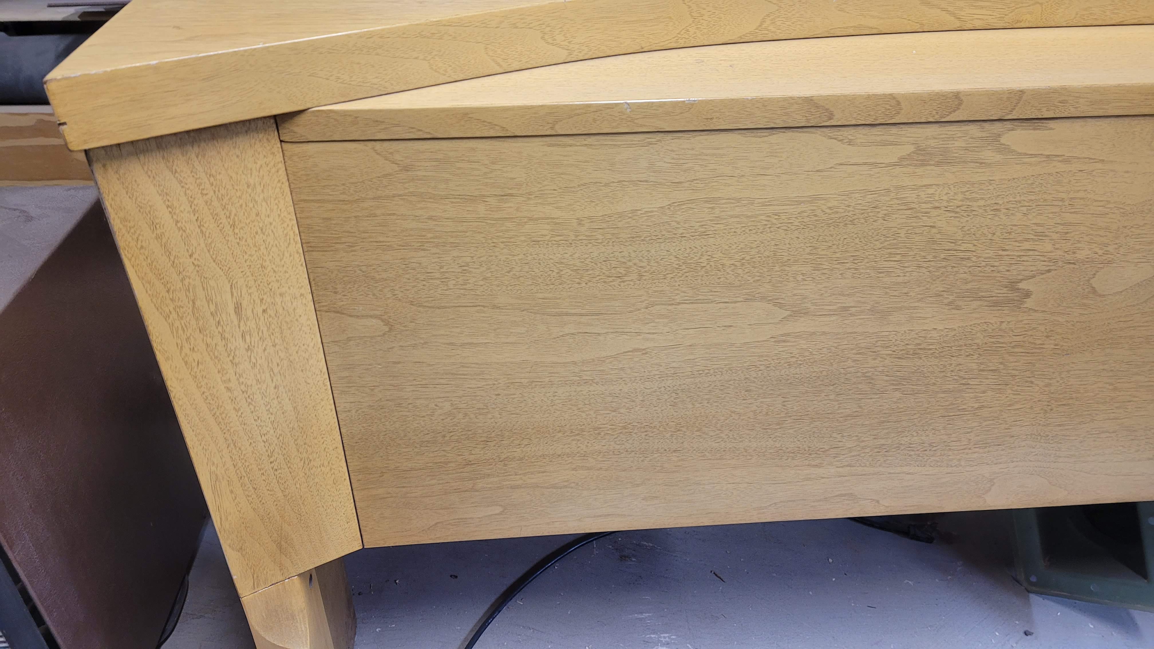

I have a customer with a double bed headboard that wants me to make an identical king size one. It's from the 50's or 60's and has an "interesing" finish over the mahogany plywood and a little bit of solid wood.
The grain is clearly visible. I can see that there's a clearcoat on top of whatever lacquer or stain was used to give it that color, but I'm unsure what the right approach is. If anyone has done something similar, I'd appreciate any guidance you can offer. Thanks. John

Bob Niemeyer  Member
Website: niemeyerrestoration.com
Taking a look at the photo it is bleachtone and glaze, Mohawk sells the products. Fun to do if your a experienced finisher. If you are a new at finishing you will be frustrated.

John Member
Thanks very much, Bob. Yes, that looks like it might have been the process used. I only spray WB's so Mohawk's products aren't going to work for me. The cost of the Bleach Tone plus Reducer plus whatever pigment combo I'd need would add a big hit to the materials cost of the project as well. I'm always up for a new challenge but the $'s aren't going to add up so I think I'm going to pass on this. Thanks again for the info. I might have taken it on only to end up with an impossible challenge given I can't spray solvent-based products.

I used thinned acrylic craft paint on a MCM sewing machine cabinet followed by blond shellac on a repair for our daughter-in-law. Can't say it's a long term fix, but matched perfectly on a 70s Japanese collectable piece.

We use the industrial wood bleach to get that color but it is labor intensive.

You can buy a pint or quart of high white tint base at any big box store that sells latex paints, have it matched to the sample you provide and go apply it to the project.!!
You will need to thin it down a lot start with 1 part of the latex to 4 parts water, spray as small of an area as possible, ( hopefully on a surface that won't be seen) and adjust mixture as necessary.!!
When applying...cut the material feed knob down where only the fjnest mist of paint is coming out and increase your air volume as muck as you can to break up the latex into as fine of particles as possible. Your looking to achieve a translucent affect, not a totally opaque one.!!
When I was doing this in Fl. Each coat would dry in 15-20 min. Before another coat..( if needed) could be applied over the first. On a piece of any size, such as a night stand or coffee table, that meant I could start applying the second coat immediately after the first one.!! You can try this if you like and if not, keep it in mind for a similar future project or to just increase your skill level.
PS: also check the piece your copying by scraping an unseen area to make sure it is either a natural light colored mah. Or if it has been bleached, if bleached, do the same, prior to the above.!
