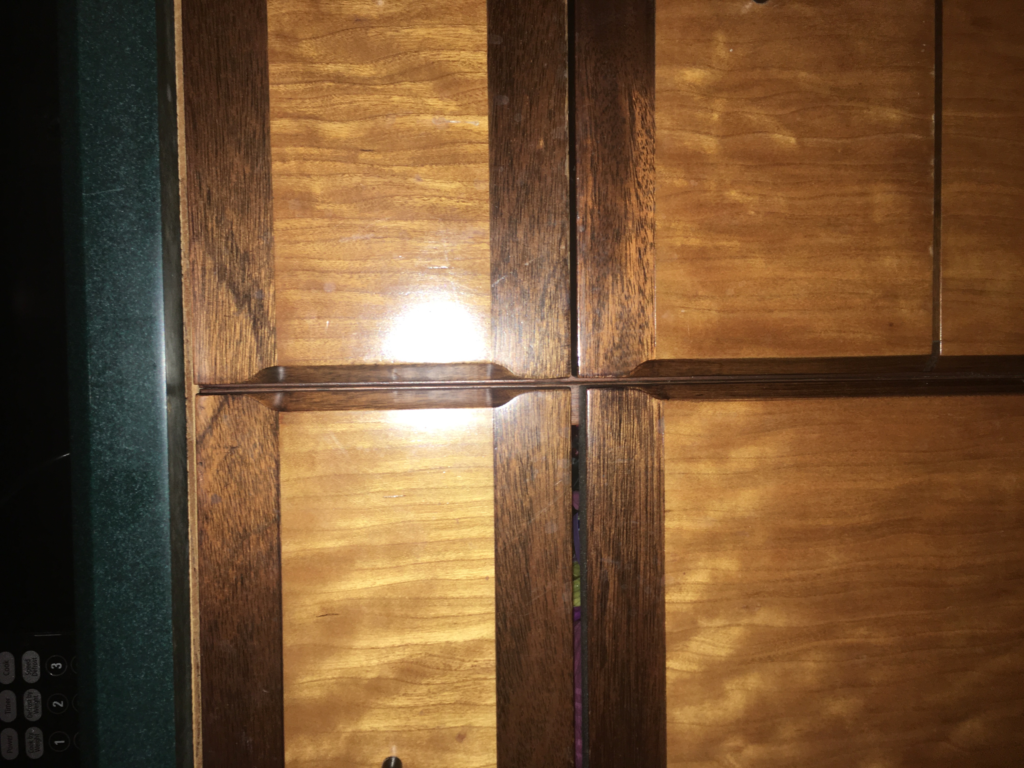

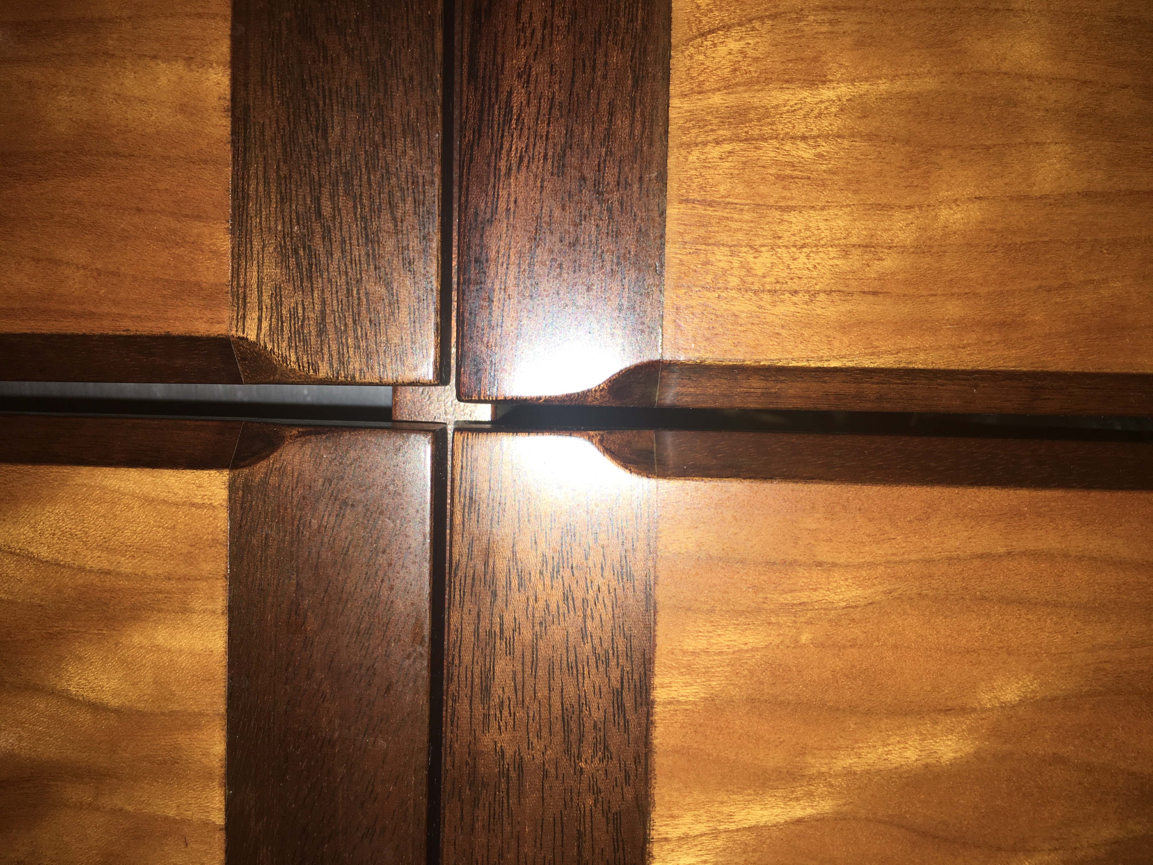

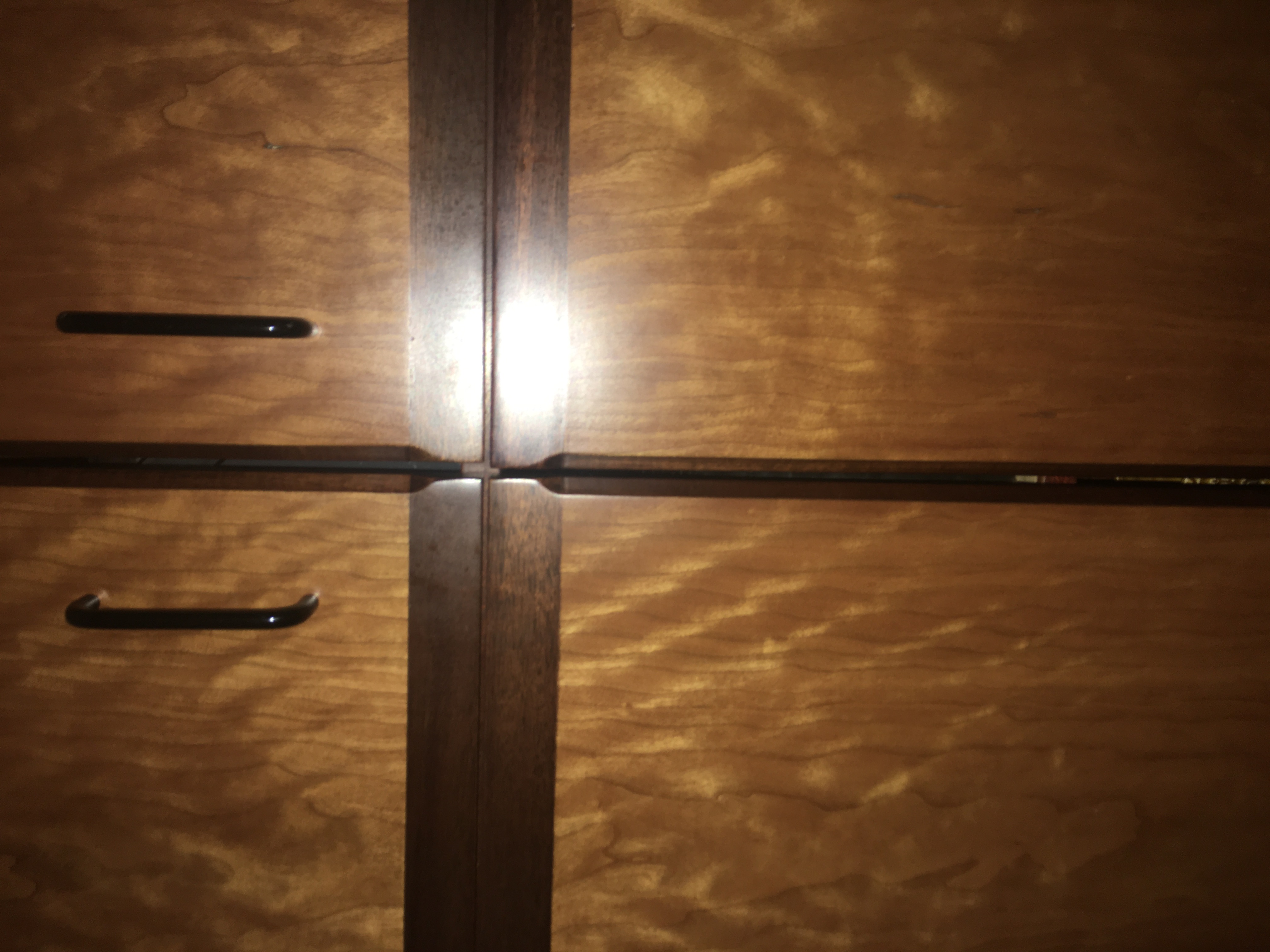

Mark Member
Images posted:

Your correct...A VERY challenging finish.!!
First thing I do is compare the color of the woods on the old panel to the new ones. This usually requires removing a small area from each wood and then touching up and recoating..
That's easy for me, but could be a problem for others. Your pics offer little help, if they had been taken in indirect sunlight they would have offered a clearer representation of the colorations.
