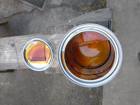

dr Member
Steven,
This is how Bloxygen works.
View higher quality, full size image (591 X 443)
3/7/22       #14: Skinning ...
Steven Zawalick  Member
Website: http://www.bloxygen.com
Well I certainly don't like to see that and have spent thousands of hours and hundreds of thousands of dollars to deliver an effective tool to prevent that. Bloxygen works, but it takes special care to be effective. That's MAJOR oxygen damage. It looks like that finish was exposed to oxygen for a long time, sealed without purging, or perhaps was damaged by exposure to heat. As I said earlier, there are only three problems we've ever seen:
1. Not Enough Gas Used: The entire storage container must be purged. You cannot use too much gas.
2. Slow Lid Seal / bad seal: Once the container is purged, the lid must be immediately sealed into place. Make sure that the lid is spotless and dent free to create an airtight seal.
3. Bad Finish: Once oil-based finishes absorb oxygen and skin over or gel, they will continue to have problems during storage. These finishes will never be the same. Start with NEW finish and use Bloxygen each and every time it's stored.
It looks like this finish was left open for a long time or perhaps finish from a secondary container was returned to the primary.
Our instruction manual is good and is here:
http://nebula.wsimg.com/7265e7cd47932371439c31d9cfd51a78?AccessKeyId=CB3A0C59E36B3
4210C41&disposition=0&alloworigin=1
Our Best Practices Video is here:
https://youtu.be/MlyzF6lC2PI
I'm very sorry this did not work for these leftovers. I'm happy to send you a replacement can of Bloxygen. We make it here in the USA and stand behind it. Please send me your address. I'm at IronWood.Designs@pobox.com.
3/7/22       #15: Skinning ...
dr Member
Steven,
Don't worry about a replacement can. The picture was taken a week after it was sealed with Bloxygen and the can was a 1/4 full. Let's put to rest this, I am going with Argon.
