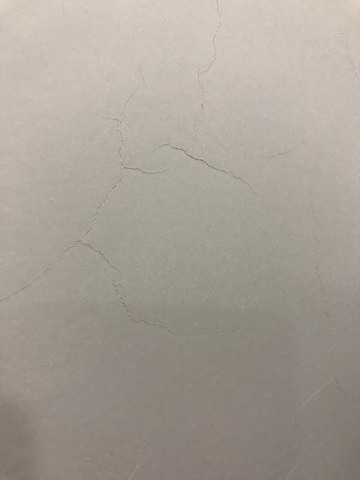

Hi everyone.
My issue is, the final coat cracks.
We renovate cabinets and sometimes we have to deal with hand painted cabinets, we always spray one-three coat of shellac primer and two coats of final paint(water based Milesi). In this case we don't know why final coat craks. It looks nice for first few days and few days later we can see cracks. Never happened before, but what I can confirm there is some reaction between previous paint and new coats as this issu arises on surface with previous paint.
Any ideas how to solve this problem?
Thank you

Too cold and the shellac primer didn't cure? Too quick of recoat? With the crackle look, seems like incompatibility between products to me.

Are you using a 2 parts paint?
If so it could be that you're putting a hard finish on top of a soft finish
If it was originally hand painted,it could be a latex paint
And that's....NO BUENO!

RichC: we do standart process and we spray 2 kitchens a week, but never happened before, so not sure if this would be the case,anyway thanks for feedback.
Mastercabman : se use Shellac primer as first(1 coat) and than 2 coast of final paint.
We did 3 hand painted kitchens(latex) in last 3 months and tryed different tactics
1 kitchen) sand hand painted surface with 120 grit, then 2 coats of primer and 2 coats of final paint and final sanding between coats and no issues.
2kitchen) sprayed 3-4 coats of primer then hard sanding and then 2 coats of final paint and sanding between coats
In both cases the final product was looking great,but here we're lost.

Can you not get pigmented finish in the same brand as your topcoat? Crackling always happens when you apply a fast drying finish over a slow drying one that is not fully dry. If you stick with the same brand throughout the chemistry problems will belong to the manufacturer instead of you.
