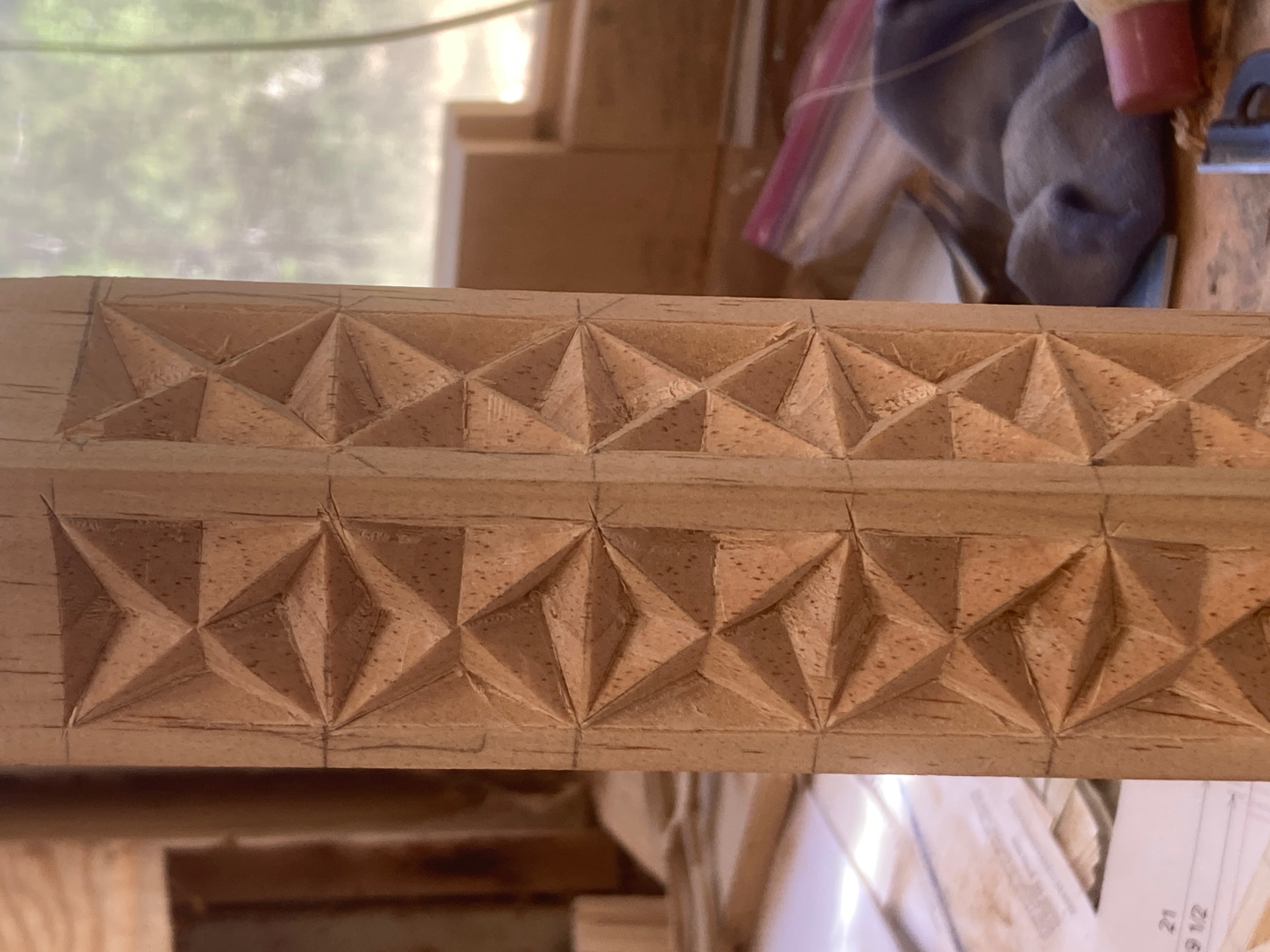

I have a credenza that I’m finishing that has a bunch of chip carving on it. The finish is going to be a dye, 2 seal coats, glaze and topcoat. What I’m wondering is if someone has a neat trick for scuff sanding the seal coat on the carving facets. I was thinking about some sort of abrasive brush that I could rub around in there by hand. Trying to get in with sandpaper or a scrubbie pad would be enormously time consuming. Any suggestions?

Sanding sponge like the surf prep?
Or sanding pads?

I would just cut a male plug with matching angles to the carving and apply adhesive backed paper to the male. Attach a little handle to sand those quickly and not risk rounding/rolling edges

Dremel or Foredom with 3M scotchbrite wheels for the lazy alternative. They conform to the surface and are not aggressive enogh to cut into the arises.

I would not use anything powered. You'll burn through the sealer on the sharp corners. I contact cement foam backed 320 grit 1/4" wide strips on thin pieces of solid wood sticks. I cut the wood about the thickness of popsicle sticks

Im with Rich. Flat backers or a male profile with adhesive back paper. Youve got enough work in them that trying to machine sand any of that is going to be a total muting of the details. The bonus is the scuff is super light so its super fast. Sucks but its what you signed up for when the carving was specified. Even a paint stick shaped to a point with adhesive backed paper or a plastic putty knife shaped would be as fast as you could hope and keep your detail sharp.

For something like that I would apply your stain and then seal with a thin wash coat of sealer. The washcoat can be scuffed with a scotch brite pad very easily as trying to sand a full sealer coat smooth. Don't apply a lot of pressure so you don't sand through the stain, just get it smooth. Now when you apply your full coat of sealer it will already be smooth as a topcoat and won't need as much sanding and you can move on to the rest of your schedule.

Well...presuming your going to sand the wood itself meticulously, as smooth as possible, you can use the micro mesh fingernail files in a very fine grit like 800-1200, to smooth the surfaces. They will allow you to cut the shape you need.!
