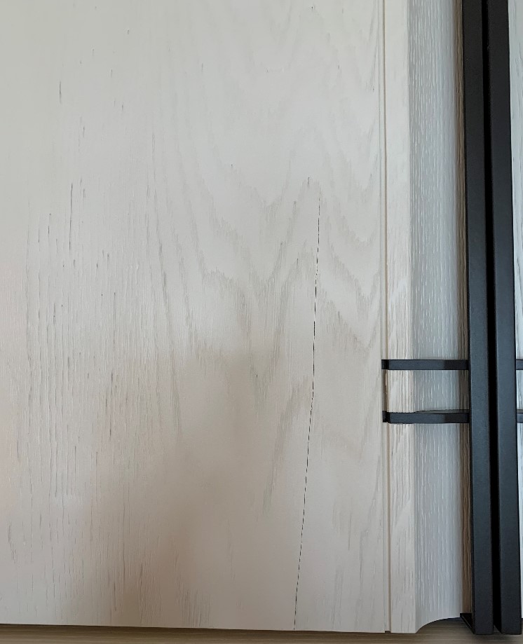

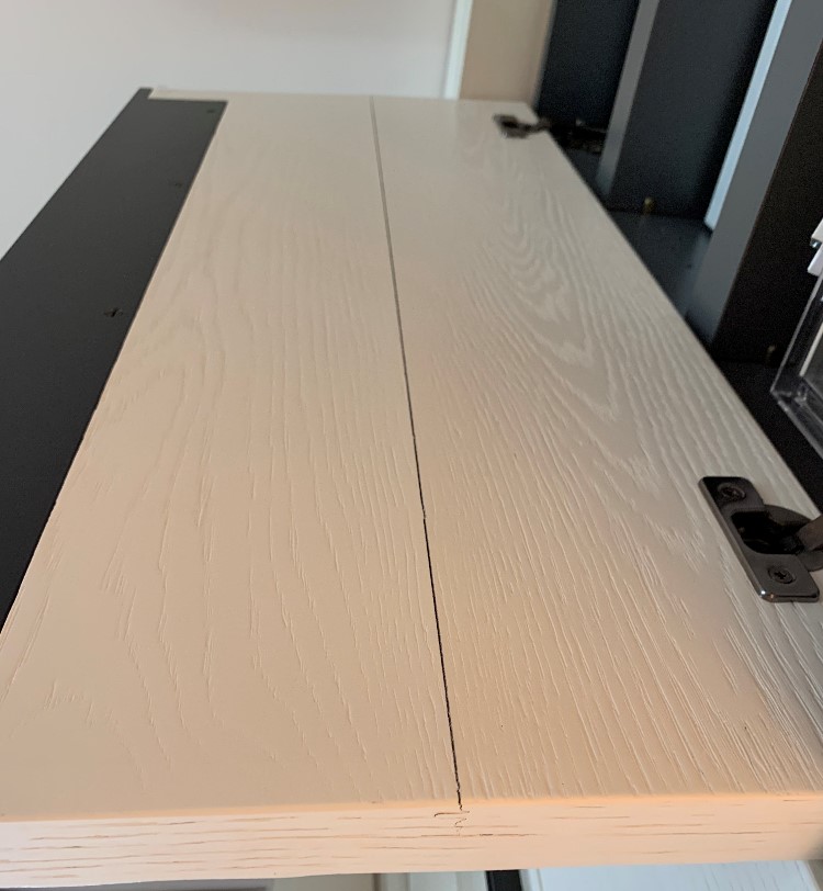

2 year after installation we have some cracks on doors which were fabricated as 3/16" thick solid, PS white oak (front and back for balance) on an MDF or baltic core. It's a painted finish so we can go over the repairs.
My question is suggestions for what to use as filler? Epoxy? Bondo? Something flexible like the DAP Elastopatch?
The doors have remained flat.

No surprise to me. 3/16" flat sawn acts like lumber, not like veneer. The cracks should close up this spring. With the paint so thin to show grain, any filler would have to be masked off so you don't fill wood grain near the cracks. I'd definitely use something flexible since the wood will continue to move.

Thanks Rich. I'm thinking the same way - something flexible. I think the DAP Elastopatch might do the trick. Apparently you have to wipe it smooth, probably with mineral spirits or naptha, because it doesn't sand well.
The designer insisted that we do this so that the fronts could be hand scraped up to 1/8" deep. That didn't help the stability lol. Of course we warned them. Surprised they lasted this long.

I'm not a fan of the elastic filler idea. It will bulge out in the summer and look awful. I don't have a suggestion for an alternative though.
My only idea is to rout the back seam as a vein line and refinish. Bondo the front split with a caveat to the owners.
I think these photos should automatically pop up when anyone posts about sawing their own "thick veneers " as a warning.

Tom - thanks for your feedback. I've also wondered about the bulging. The cracks are quite small so I think it would be minimal and may just be the best option. We've had 100% success using thick veneer for both fronts and stair treads in PS and RS oak on several projects. The only issue was where we were forced to edge glue the pieces. And we don't resaw. I purchased this from a trusted vendor who produces only high-end flooring so we went into this with the best set up possible.
