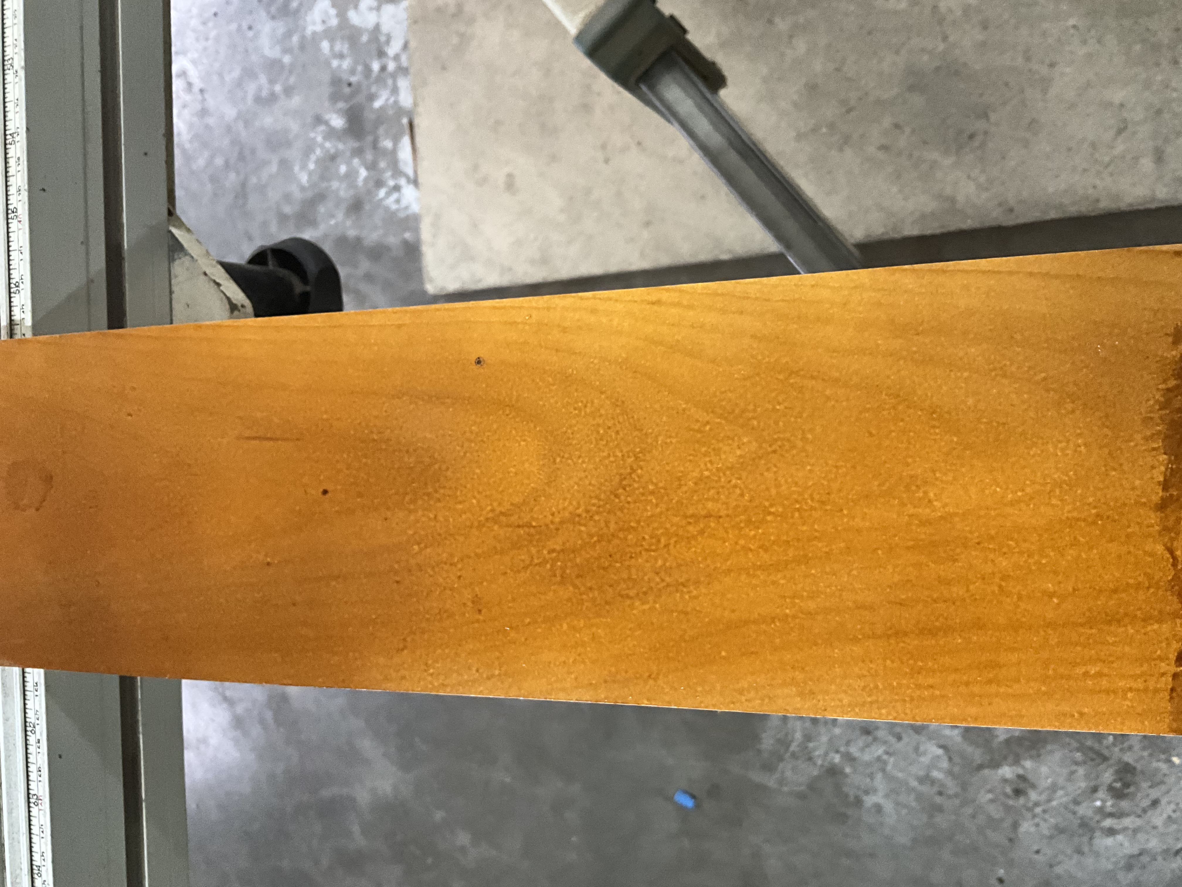

I’m having problems spraying this material. It’s very fast drying. I did thin the material with alcohol. That has helped. But the surface doesn’t seem to level.. And I get light spots on the surface .
I’m running a hvlp cup gun at 30 psi.
The tip is 1.7 mm. It seems the best.
I have other guns with a 1 mm 1.4 mm
but couldn’t seem to get enough material to come out of the gun.
I’m confused.

By the look and color of the sprayed surface, unless you have added color to it, my educated guess is your using orange shellac...am I correct.??
If so then as Leo mentioned, this is almost always applied by friction polishing of the surfaces, more commonly known as French polishing, though it was not really invented by the French.! There have been times when others elsewhere have brushed it on, but brushing does not produce a deep looking high gloss mirror finish, that friction polishing does.!I would strongly advise you to use the next best thing which in this case would be Nitro cellulose lacquer, which can be sprayed sanded and polished to a very similar glossy finish in a very quick amount of time, as compared to the French polishing method.! If you do so, any help you need on using it can be found online or in books or here if absolutely necessary.!
