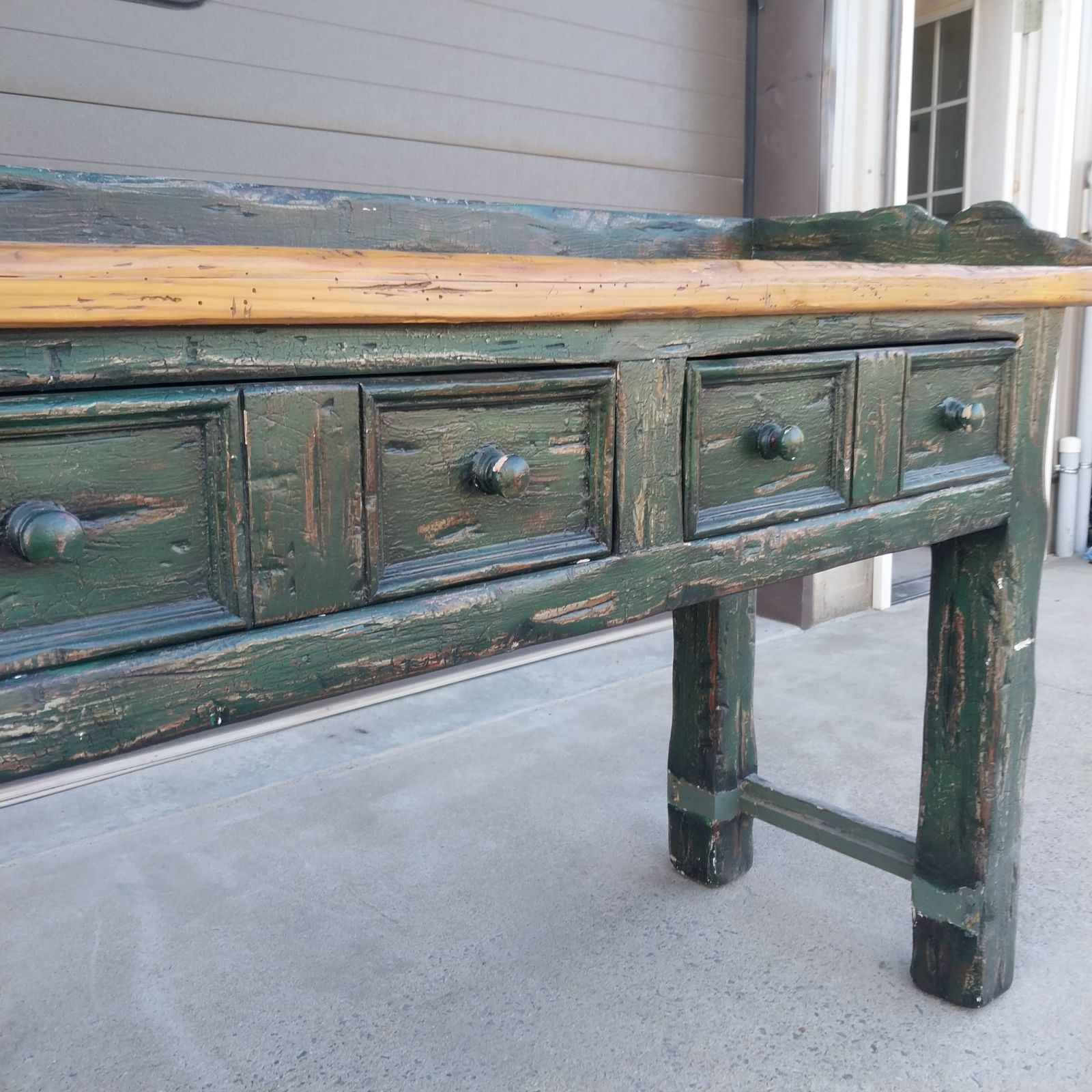

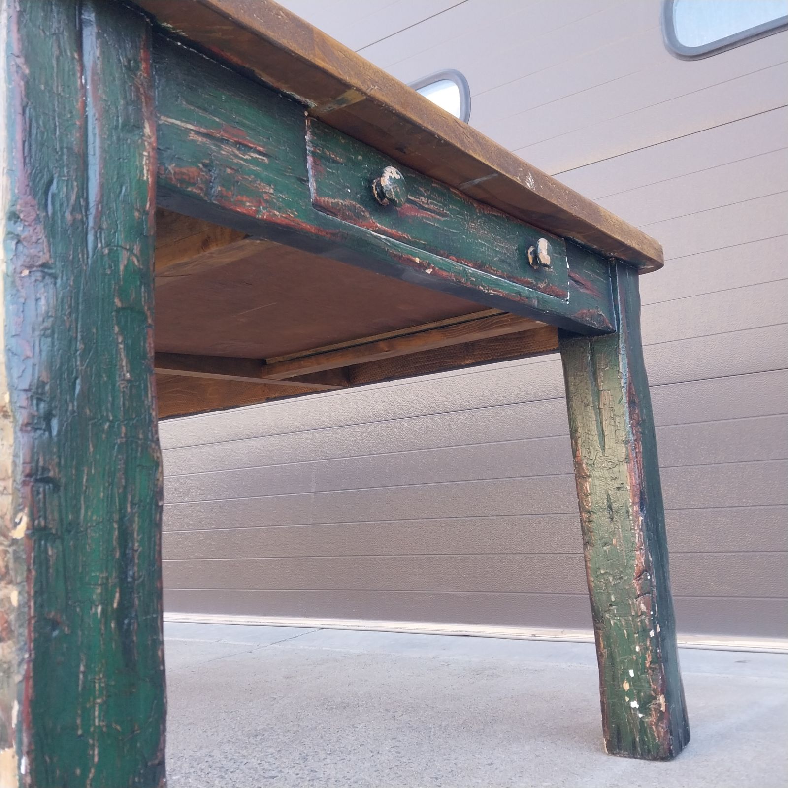

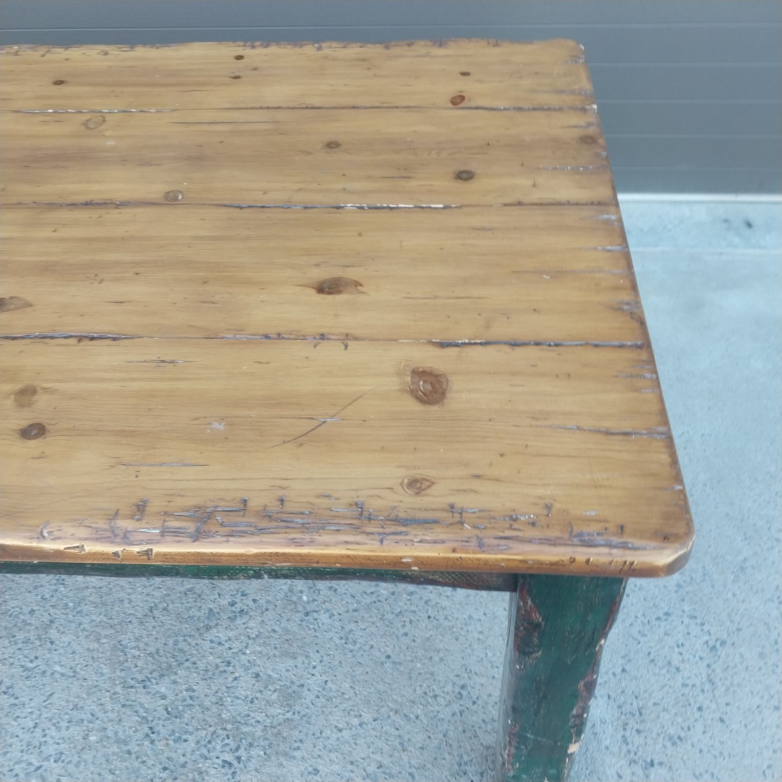

Been asked to remove this old varnish and paint. I need ideas? Chemical stripper? Walnut blasting? Sander? I don't know where to begin
View higher quality, full size image (1600 X 1600)
2/8/24       #2: Removing paint ...
JeffA
You know these aren't old pieces. It was purposely made and painted/finished to look like this. Good luck getting all the paint out of those deep gouges and distresses. So what is going to be done to it after the paint/finish removal? That's kind of important as to what is needed.
2/8/24       #3: Removing paint ...
Bob Niemeyer  Member
Website: niemeyerrestoration.com
Chemical Stripper if want to get it nice and clean.
2/8/24       #4: Removing paint ...
Riley
They want to put a clear coat on everything.
2/9/24       #5: Removing paint ...
herb johnson
acrastrip i believe they make a h20 stripper
