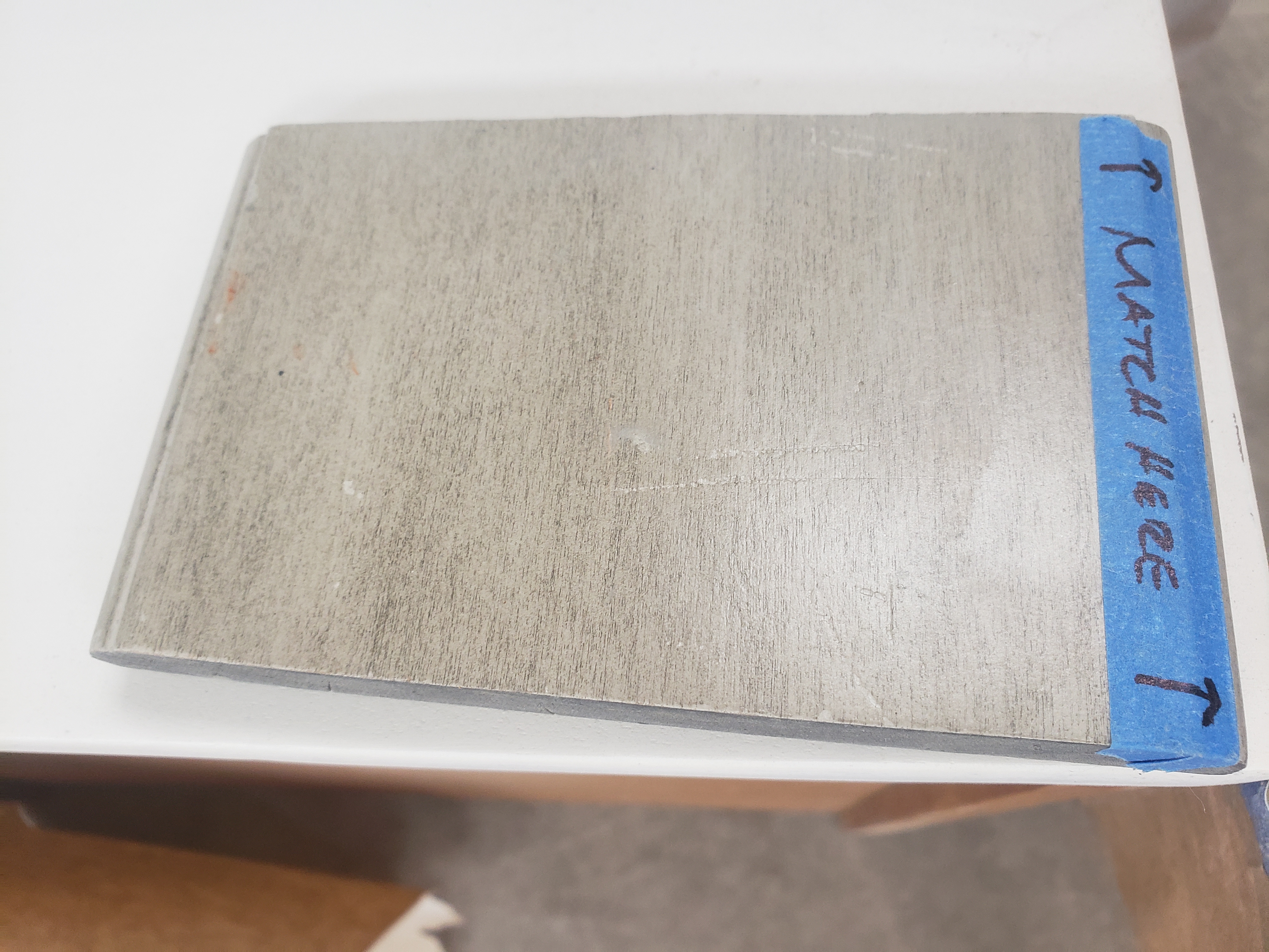

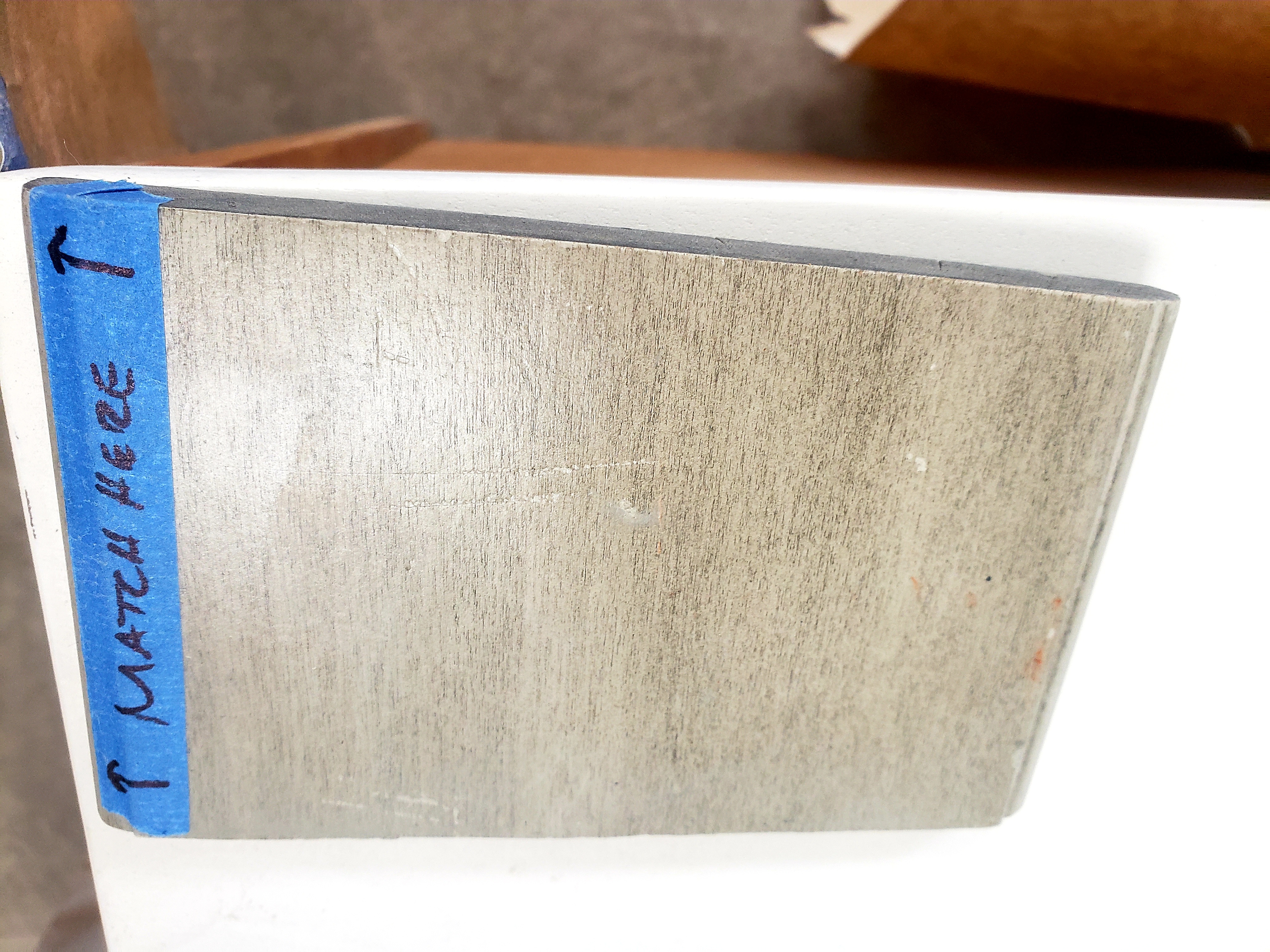

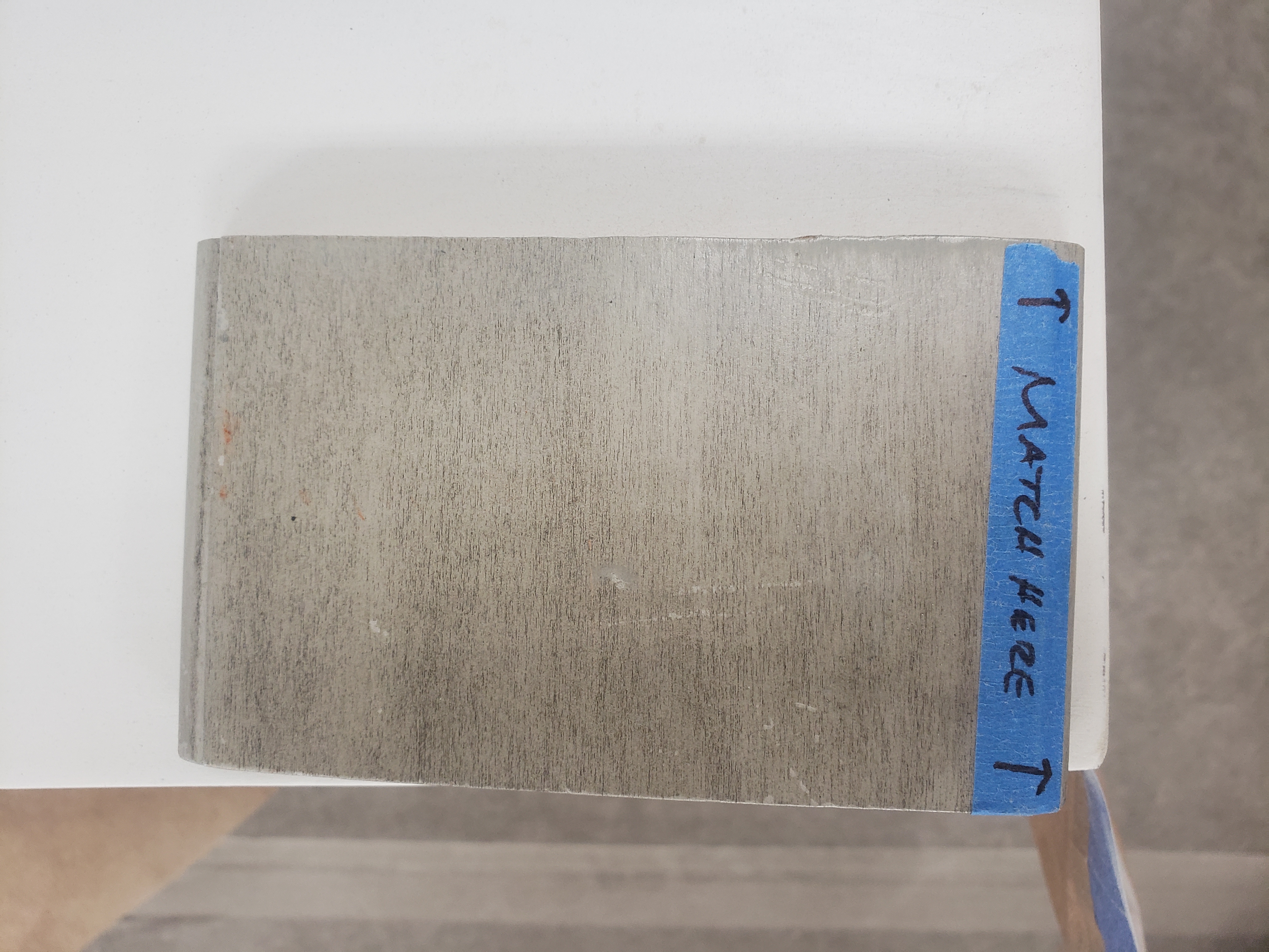

Im looking for any advise on achieveing this stain match. Looks like a grey base with a blue or black glaze. Thanks

Luke,
Pretty standard finish these days - well, we sample this type of finish a lot.
1. rift walnut / mahogany
2. prep 120 or150
3. wire brush
4. light sand - smooth to touch 180 or 220
5. paint thin (!) coating of white/off white - just enough to obscure the wood color
6. washcoat topcoat- 50% cut box coat - don't bury it!
7. thin glaze - black/burnt umber/ maybe touch of yellow oxide and/or red oxide
8. remove 75% + glaze cross grain and/or circular motion with rag to let glaze catch in open pores
9. let it dry. remove balance of glaze to match job sample with red or green scotch brite
10 blow off, tack and top coat
May sound laborious, but it is pretty quick and easy peasy once you get in the rhythm.
