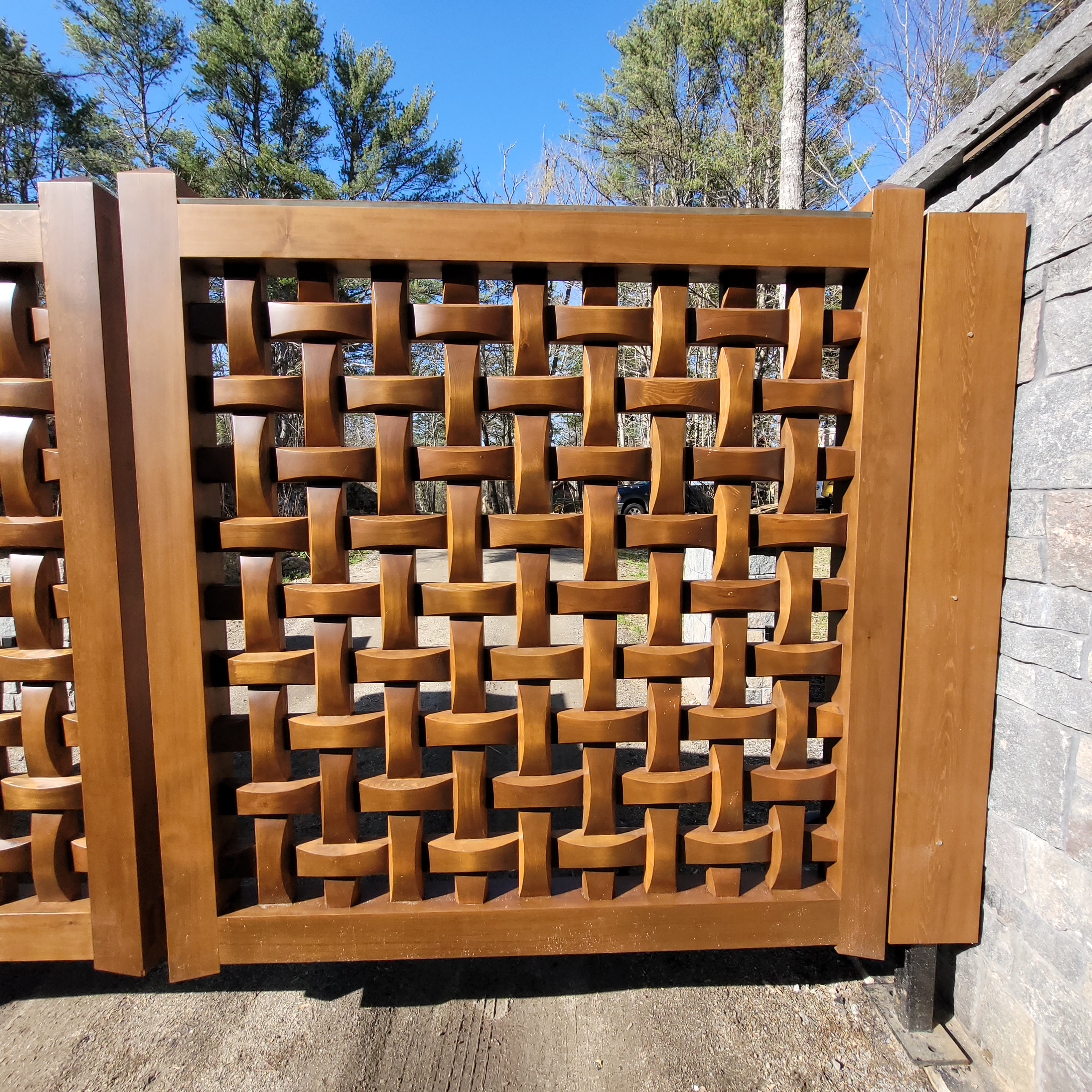

Then figure out how many square inches there are in the 3" wide joints. I'll bet lunch that the 3" joints, in toto, have more surface than the conventional rail/stile joints.
The two gate jobs below have 3" wide joints, except at the perimeter frame, 1-1/4" long, glued both sides.
One gate has 150 joints in it, for 1125 Sq Inches - almost 8 square feet! The other has more.
Historically, the doors you describe often had wide quartered or rift planks at the core and 3" framing, molding, etc. applied on each side. The t+g joints in the planks would run behind the applied framing. The tell was at the edges.

3/8/23       #3: Heavy door construction ...
bob Member
Thank you!
Sort what I guessed... that the sum total of all the intermediate rails might do the job.
