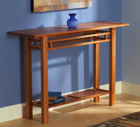

Ken Culbertson
Here's a hall table that is similar to what I am making. So tell me a little more about the battens
View higher quality, full size image (450 X 409)

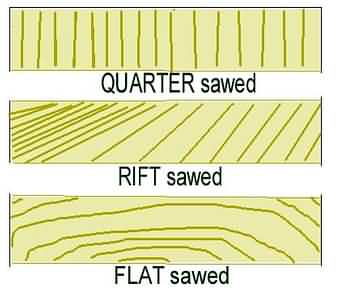

The flat sawn plank is similar to the attached pic and this would general mean some bowing at some point. Over the last few years I've attempted to learn new techniques here and there, but classes that would interest me are expensive. Am saving some funds for next year for a week long class in Philly that takes teaches Nakashima's work. Classes are expensive. So if the good wood workers would offer classes at a more reasonable rate I would be taking them. Am just a forester -- not the doctor that's into wood working or retired engineer or the successful businessman, etc. They have the professional Grizzlies, Delta Unisaws, etc. So if they would have the classes then I'd take more. The one in Philly is $1100.

nicko
that table design in your picture would definitely look good with bread board ends.
it has a little bit of a Greene and Greene look to it.

The most simple method for milling a log into planks, plain sawing, involves making a series of parallel cuts through the log. This method is quick and leaves the least amount of waste. Because of the directional tension across the grain as the wood dries, ages and wears, flat sawn boards can be subject to cupping, twisting and bowing. Often, dry boards will absorb moisture from the atmosphere and will become distorted. Plain sawn lumber has a large variety of appearances based on the angle of the growth rings relative to the surface of the board. Often, these rings can be nearly parallel to the board, creating large, open patterns. When the angle of the growth rings nears perpendicular to the surface of the board, there are tighter stripes across the face of the plank.

To help guide you with your original question , design with wood movement in mind , now with each application you may have different parameters .
The design you have shown is not one that allows for movement imo .Slice the board into veener and make a stable top the correct thickness or redesign would be my choice .

I think Ken already knows that but is looking for an solution to his unforgiving design . Where the cleats going to go with the design as it is ?
After a degree and a career in forestry he knows little about wood movement or design but the table pictured looks nice .
