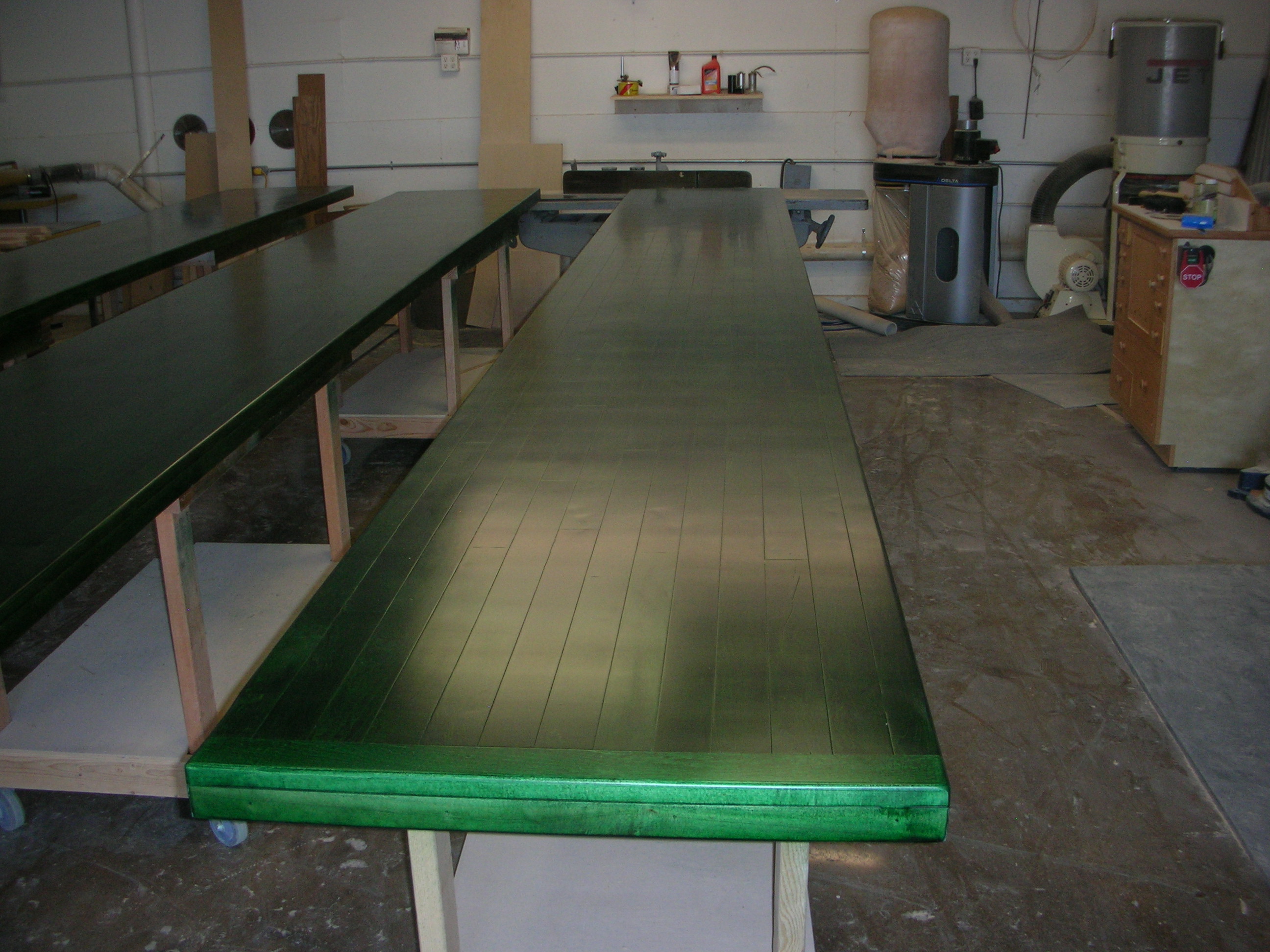

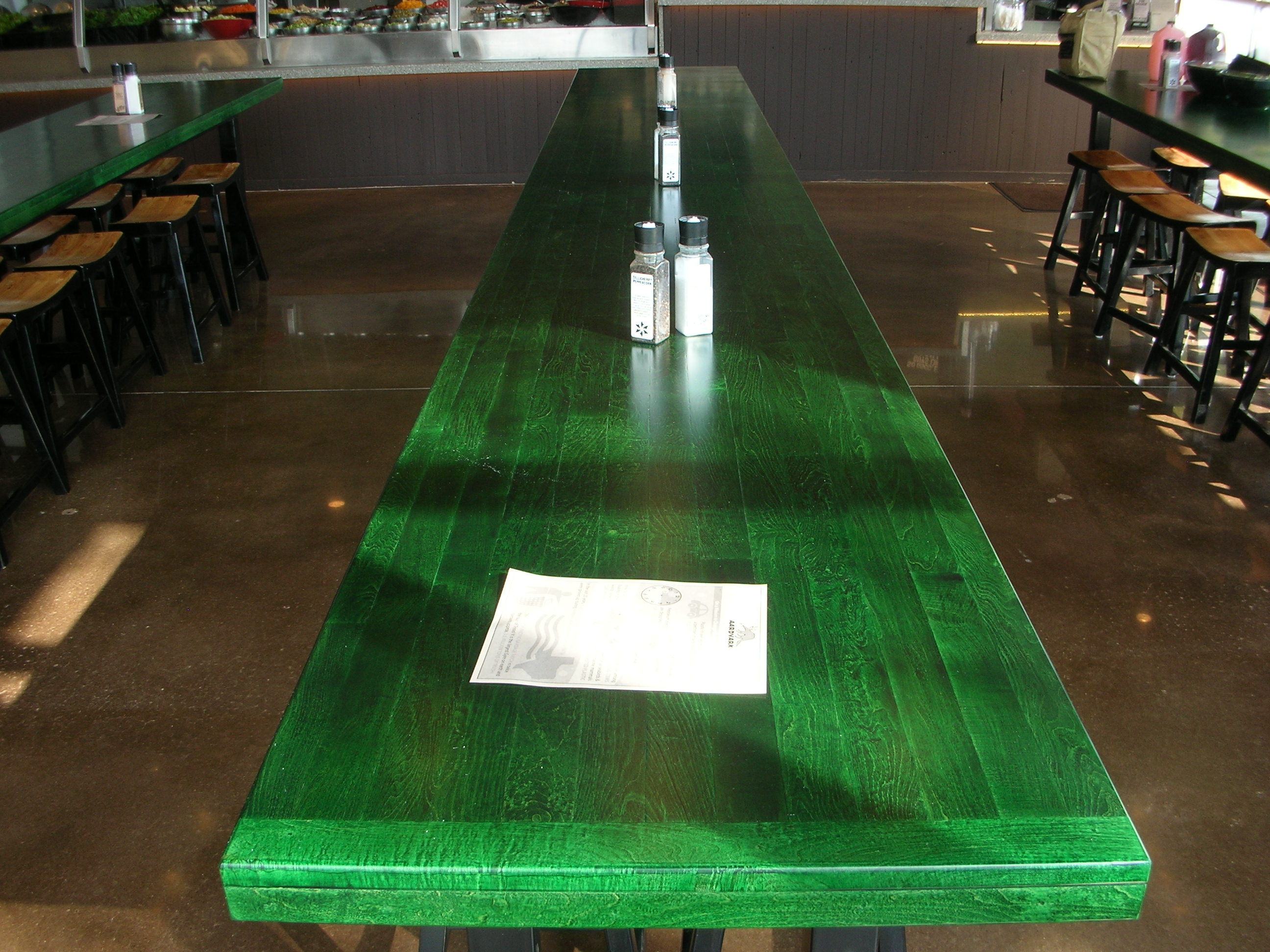

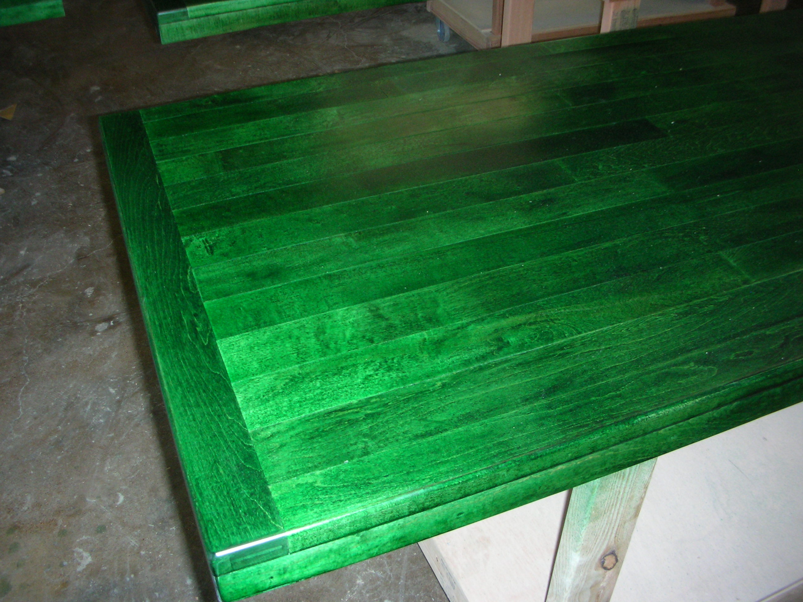

Shouldn't be a problem as far as attaching the boards to a substrate, however I've not done it with boards that width or with redwood. We build restaurant tables with repurposed wood. These tables are reclaimed gymnasium flooring with 1 1/2" particle board substrate. They are 30" wide, a total of 2 1/2" thick and 18 feet long.

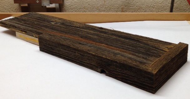

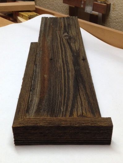

Thanks for all of your input, I bought a couple of the boards ($5.00 each) and made a Nativity Scene as well as these samples. They are bone dry so will run them through the planer to flatten one side which will be glued and brad nailed to shop Maple ply; edged to give it thickness. Drawer unit on bottom same treatment but basically drawer boxes with the boards screwed to them to allow for any adjustments needed. Most definitely tell the client that wood can move and things may change -- he likes the look of the images attached which were simply wire brushed and top coated with varnish. I like your outlook Jesse on the wood movement, I suppose that ignorance is bliss!

Website: http://www.awwtx.com
Jessie, I wanted to ask you about your comments. The tables I posted were tongue and groove flooring attached to substrate in the same manner as general flooring. I recognize there will still be some movement even though the material is over 50 years old. How, then, should I have configured those tables?
12/6 #14: Reclaimed Fence Boards on Plywood ...
I went to a local college with a great woodworking program, loved it, and have been building furniture and casework for about four years. I'm a pretty crafty fellow, come from a long line of engineers, and have some good design sense. But I'm not even close to telling older or at least more experienced cabinetmakers how they ought to build. I was just poking a little fun at how often we woodwebbers tell each other what will and will not work. I think the tables are awesome, and they look well-made. They are more balanced than a lot of panels that also "work" even if they "shouldn't". I think if you laid up that flooring on a 3/4" substrate it would probably have some problems. But maybe not. As an aside, I often hear the idea that old wood won't move, and I don't find that to be true. I think often old wood is just stable wood in the first place, and stays stable in old age, as we all hope to.
12/7 #15: Reclaimed Fence Boards on Plywood ...
I appreciate your comments. I'm always looking to learn, and try to better myself on every project.
I agree with ongoing wood movement for the most part. If the old wood is not substantially altered, in my experience it remains pretty stable. If milled heavily, it reverts back to a new wood behavior.

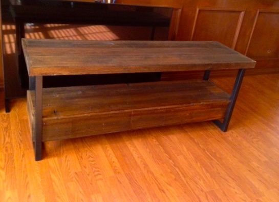

If you're still following this thread here is a link to the final project. Also a picture of it sitting in the clients home. Hard to eliminate the distortion but you get the idea. Appreciate the input you all gave, thanks -- John
