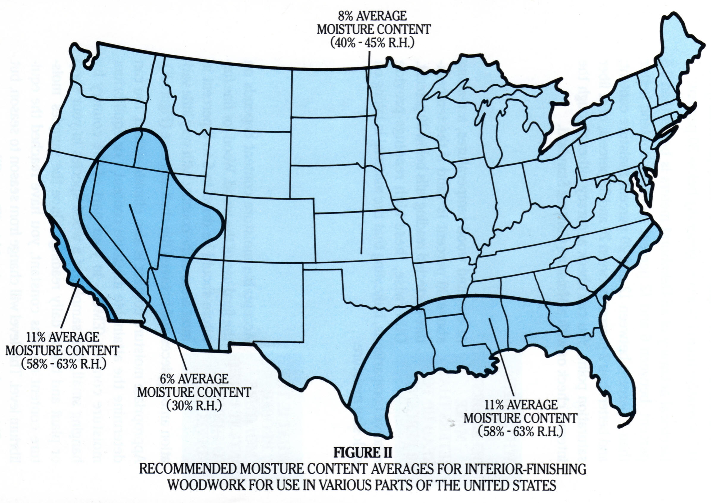

You quite simply are losing moisture from the face, and/or gaining moisture on the underside of the tops. This will continue until the tops reach the EMC for the area they are to live in. See the map.
When lumber is kiln dried to the correct MC, it is 'fixed' somewhat, making the material more stable.
I suggest the OP find a better lumber supplier - or dryer - if he is seeing as many problems as he describes. My experience with commercially dried lumber is very good, with only a few exceptions over the years. Most of those are from reaction wood, but some are from poor drying. They are easy to spot, right at the first rip.
Checking for case hardening is easy to do before the wood is received. If it is present, reject it all. Once they get a load or two rejected, they will either straighten up or go away.
View higher quality, full size image (2391 X 1692)

This map is fantastic. I happen to live and ship most of my furniture to the "11%" region of the western United States. Do you know what the %R.H. stands for?

RH = Relative Humidity
