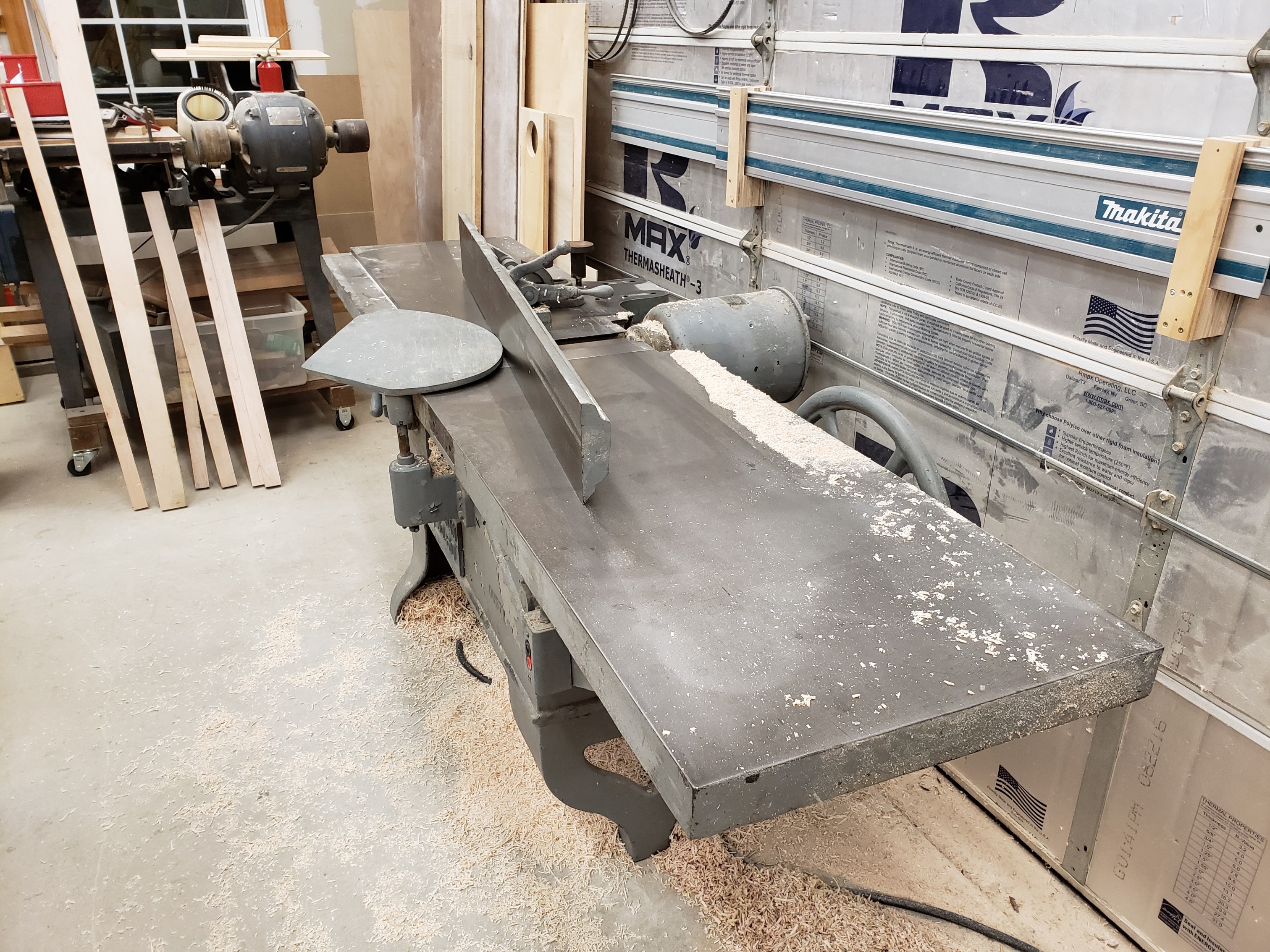

I recently acquired a 12" Porter Jointer with a 5hp, 3ph motor. I have only single phase power supply and am weighing a VFD vs. new single phase motor. Has anyone successfully installed a single phase input VFD for this application? Though I read/hear that 3hp output is the limit for these, I see some new single phase input VFDs that claim 5hp/3ph output . Curious if anyone has installed and can recommend one of these drives?

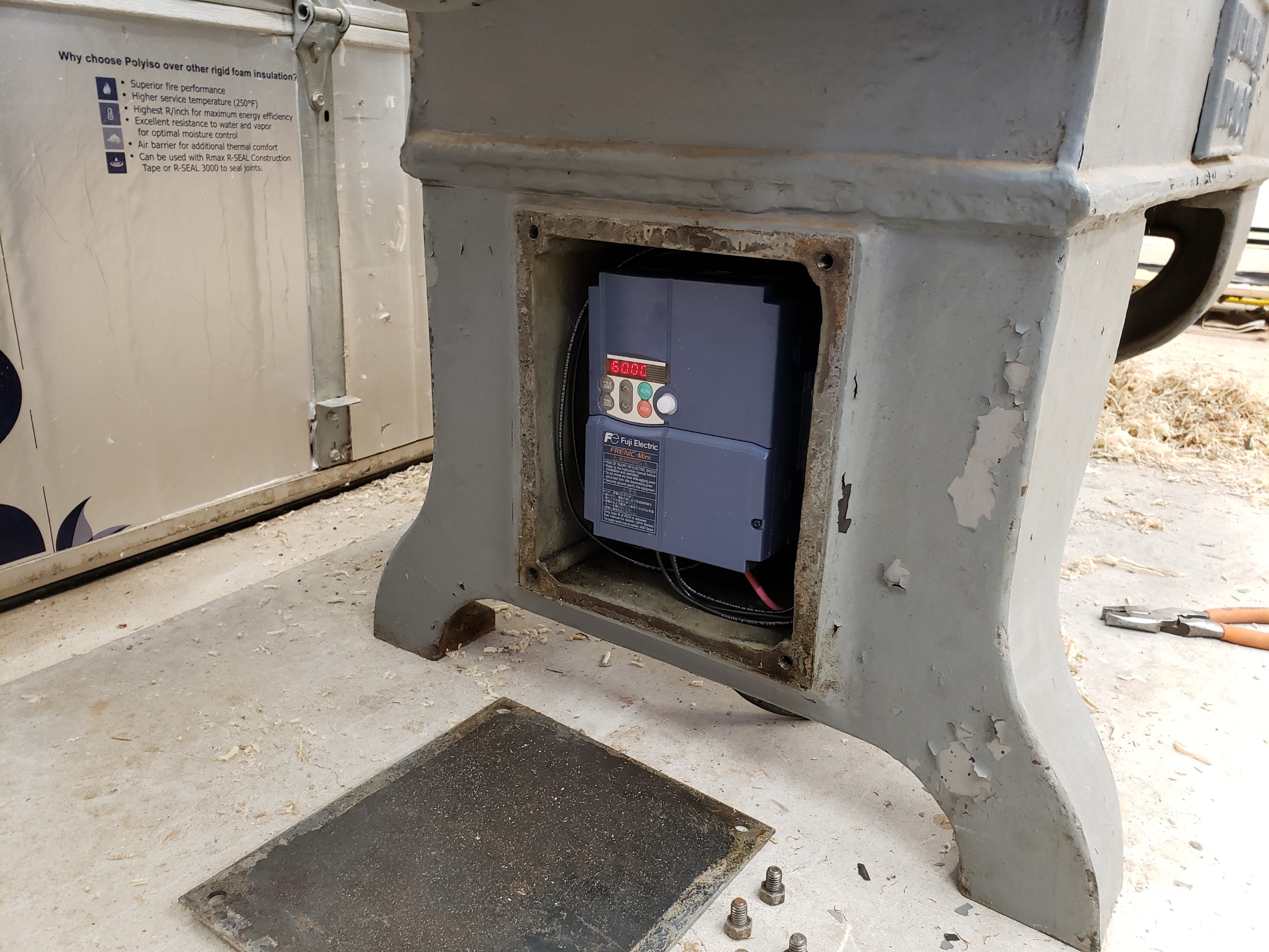

Ignore the hp ratings on both the motor and vfd.. 3hp vfd outputs 12 amps (up to 18amps for 1 minute) most 5hp motors are 13 to 13.5 full load amps, and hitting that with a hand jointer will be all but impossible.
Imho get the 3hp fuji and be done with it. A motor swap will require a new starter and cost significantly more than the $250 you will spend on the vfd.
Incidentally I'm running a 16" newman (5hp DD) on a 3hp fuji

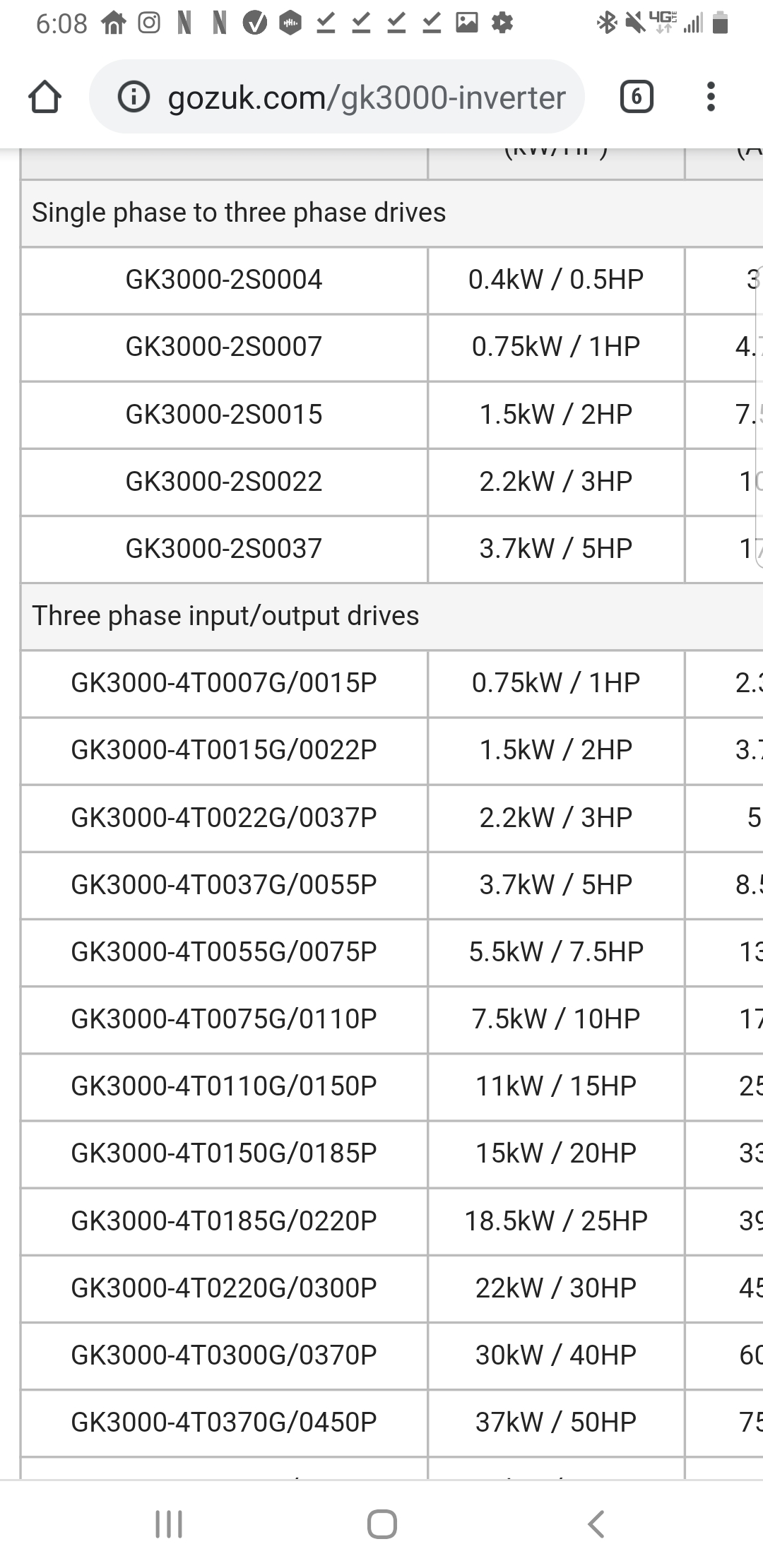

It took 10 seconds to find a single phase input 10hp VFD.
http://www.gohz.com/10-hp-vfd-single-phase-input-to-three-phase-converter

Rich, you might want to double check that... they dont make a 7.5kw (10hp) vfd for single phase input
Its 10hp with 3ph input and likely 5 to 6.6hp at best when run on single phase.
dont believe everything you read on a reseller sales page
