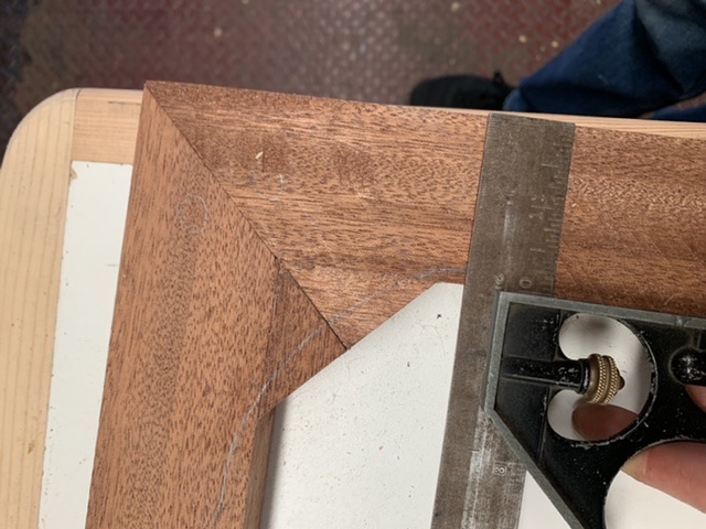

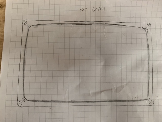

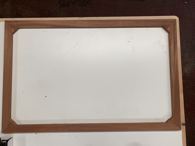

I’m working on a mahogany repro/homage of a Danish modern mirror. See design photo on paper. I planned to use a router
On a long arm the way you’d cut out a round table, but it turns out that the arc radius is huge, way more than 10’. Any suggestions on how to cut the arc of these rails and stiles? The mirror frame is 30”x50”. The arcs are not the same and they tighten a great deal at the mitres.
Any suggestions welcome.
Thanks.

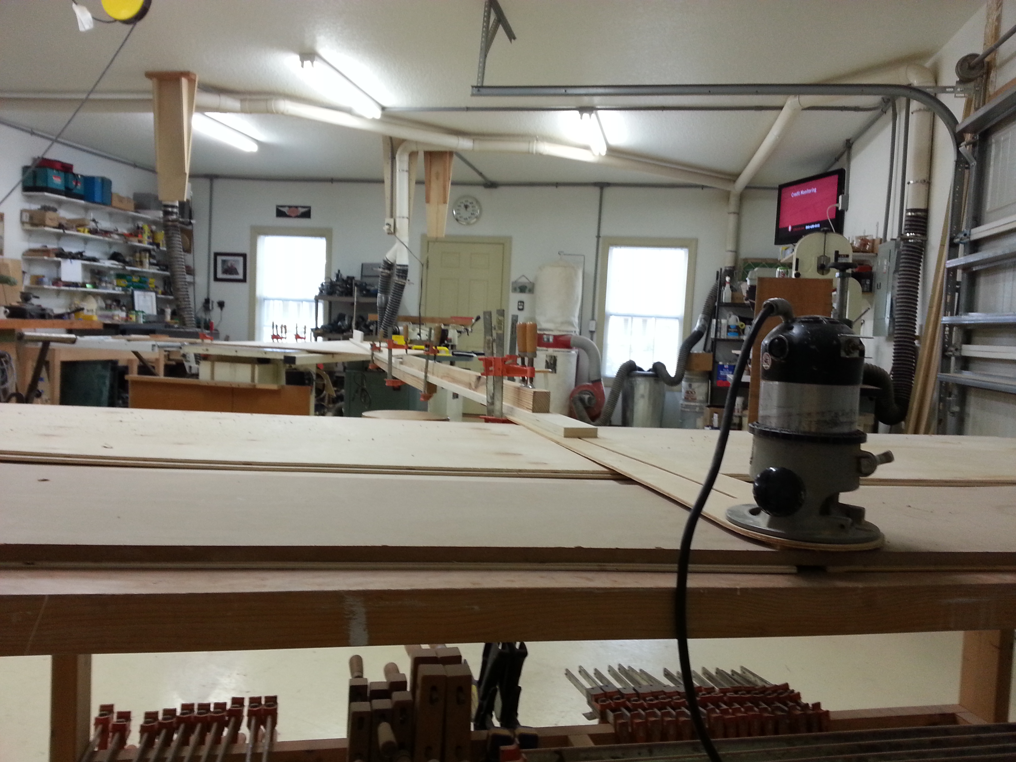

Take your frame to a CNC shop and have them cut it. I've made up to 12' trammels. 1/4" plywood with 1x3 cleats on the sides. Alternate the joints in the parts. Hot glue the pivot block on the floor.

It sounds like you are making one frame and not multiples, so "jigging up" seems like a waste of time. If your frame is not glued together, take the parts to a bandsaw and cut the curves, then sand to the line. If the frame is already glued together, I would consider cutting through the opposite miters to leave two "L" pieces, bandsaw the curves, reglue the miters and sand to the line.
Sandpaper wrapped around a flat wood scraper as the "sanding block" will smooth out the larger curves without dips, and sandpaper around an appropriately sized piece of PVC pipe will smooth the corners.

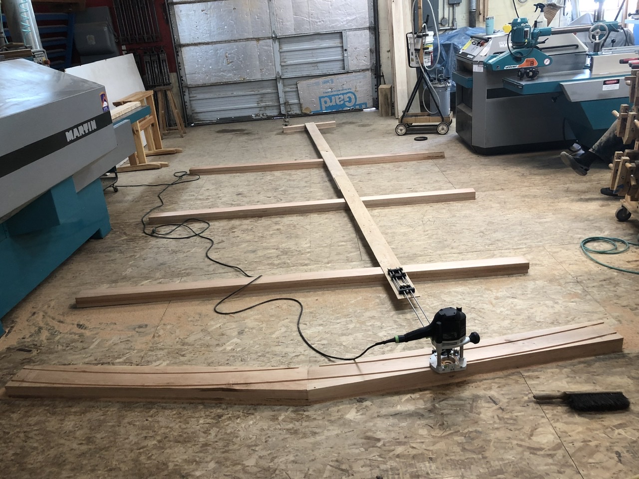

Long router tramels are awkward but possible. I used this last week to cut a 235” radius on some 68mm thick door frame parts. CNC router would have been easier but don’t have one.
I used the 2 point fixed triangle to lay out the curve but have never come up with a good way to use a router with that.

We have done many like Joe's setup with a router on a stick.
