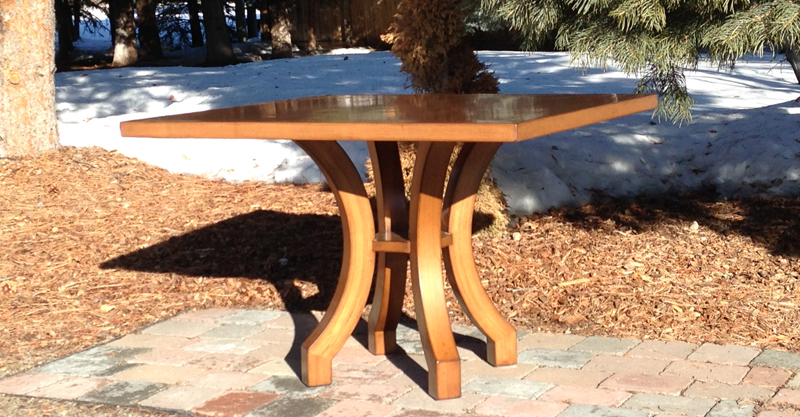

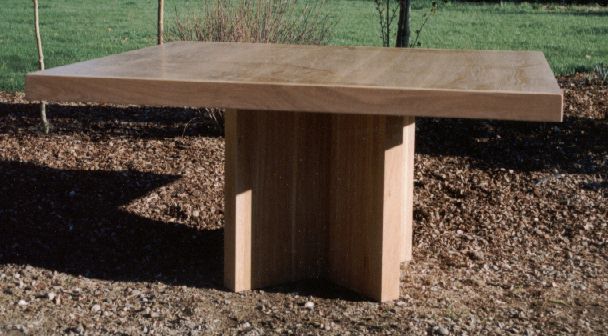

I've done a lot of these type of table tops. The only way I'll do it is with a veneer center panel, then wrap it with a mitered solid wood border. I learned the hard way long ago that wrapping a solid wood top is just a disaster waiting for seasonal wood movement to occur. Either the miters will open or the panel will crack.
The tables shown were built this way with alder and oak, and have held up for years with no issues.

Here are couple more in walnut and oak with the same construction method. As the others here have stated, it's the best way to achieve a long term good result.
