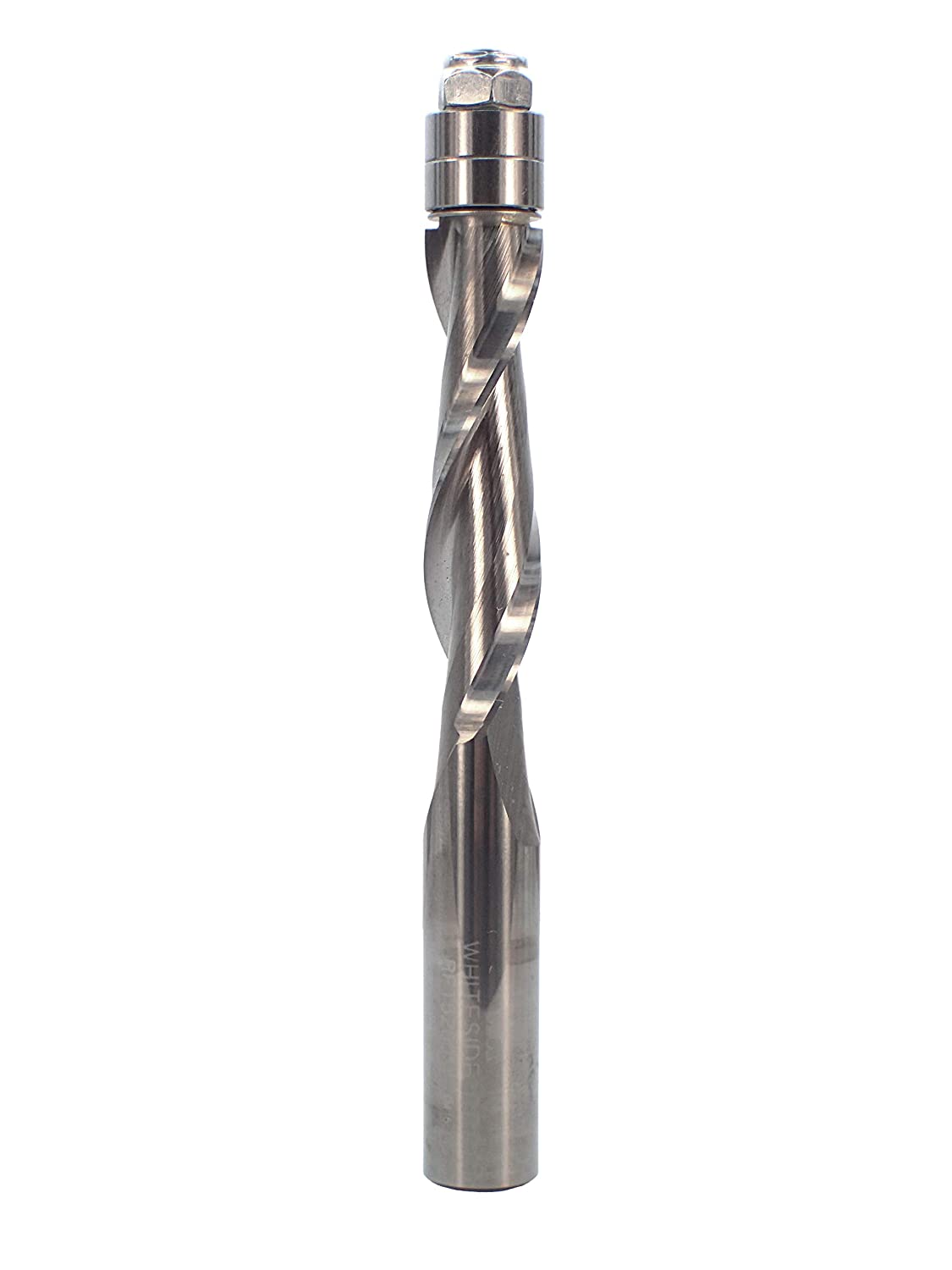

Update. I've had a lot of suggestions for a O flute upcut bit but despite all my search I don't believe there's one of these made that's designed to be a trim bit, with a guide bearing. All of them I found were meant for CNC.
The closest kind of bit I can find to what's been suggested is something like the Whiteside RS5200 1/2" shank 1/2" bearing 2" cutting surface length. If a O flute upcut can't be found would this do it?...
