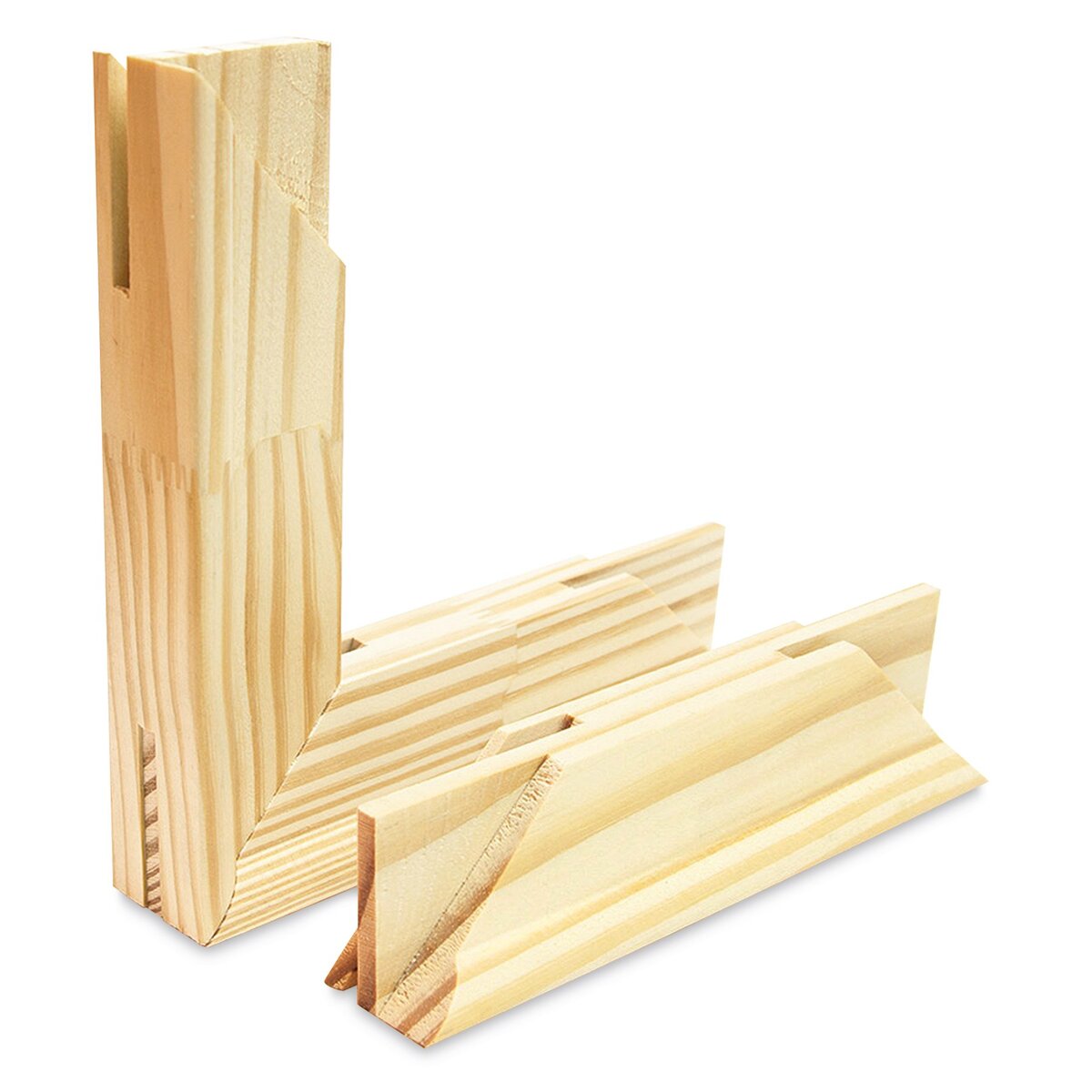

What is the problem? That rim is only 3-4" wide at the butt joints (miters??). That is what you all are crying about?
Make your tenons like you have planned, running the full width of those butted rim parts. Assemble with Resorcinol glue. Flip the bottom up, and run several 1/2" wide x 1-1/8" deep routes in from the bottom, 3-4" long, bridging the butt joint. Make snug splines, and glue them in. Resorcinol.
OR
Make a butted joint that has two long (3-4" ) laps over each other, like the Grumbacher canvas stretchers. The clue is glue surface area.
You guys are all paralyzed over 'wood movement' when you don't even measure moisture or range. Worrying over the wrong factors. Solving problems that ain't. You need to expand your view and think outside the box you have put yourself in.
I almost forgot. Gather up all those Kreg screws and jigs and especially the wood plugs, and take it all out back and bury it where you will forget all about that crap.
