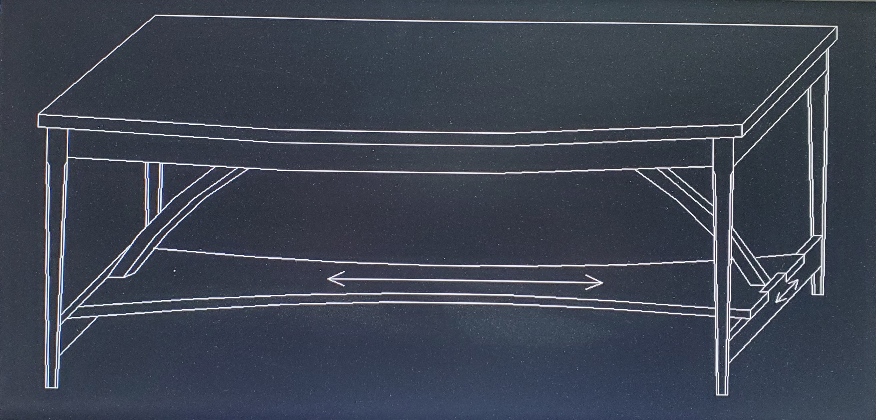

I have been asked to build this table. The shelf at the bottom noting the grain direction and that of the stretcher looks like a recipe for failure. The widest part of the bottom is 12". Any suggestions to make this work. I suggested to use a trestled beam in place of the shelf. She isn't convinced.

I think there are ways around the problem. Fasten the center only hidden underneath and let the ends float so they can move with humidity.
If you feel that is not enough structure you could attach the shelf like a table top so it can move as much as it needs to.

It appears the designer wants to make the joint to be a visual feature with the lengthwise stretcher let into the cross braces. There will be a stress riser at the base of the tenons. I would suggest fully enclosed tenons with the outer mortises lengthened to allow some movement. Glue the central joints, peg the outer ones. To add visual interest you can do through tenons but you will have to be sneaky with the outer ones to avoid showing the oversized mortises. I would make end grain caps to imitate the through tenons.
4/1/23       #4: Recipe for failure ...
If you use quarter sawn, wood movement won't be a problem at the joint.

Thank you all so much for your help. I think I can sell her on the through tenons. I feel more comfortable allowing for wood movement. I will have to get a little crafty with small tenons on the end grain caps.

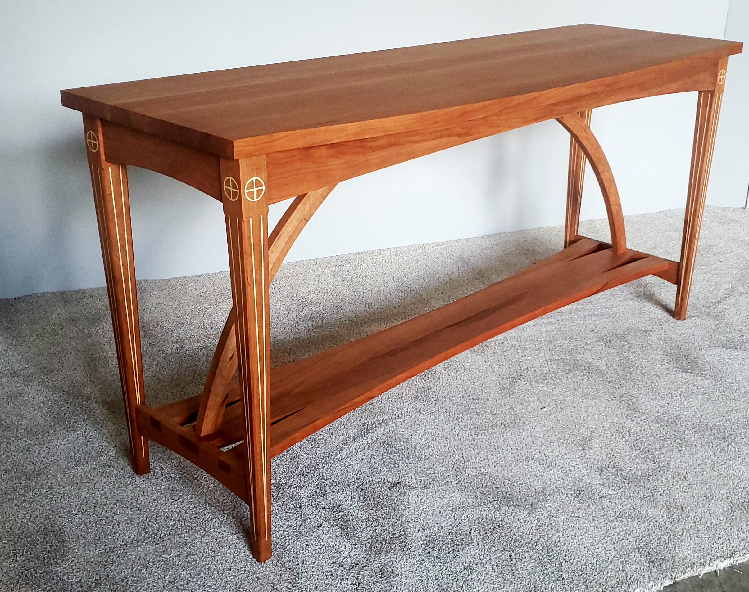

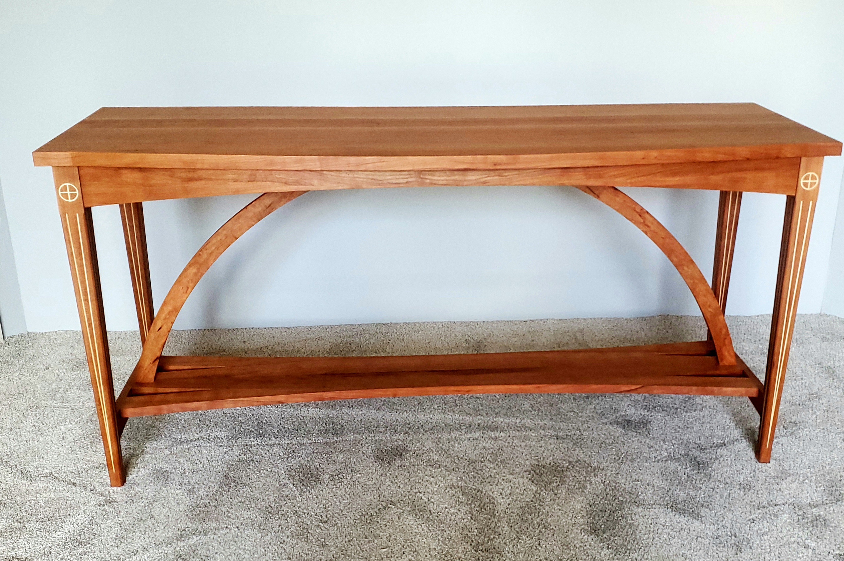

The table is finally complete. The lumber was sourced from a downed tree on the client's property. Quarter sawn and dried to 6-8%MC. I decided I would try something a little different, using relief cuts to address my concerns about movement in the bottom stretcher. Honestly I'm kinda keeping my fingers crossed.

Nice work. Your decision to make relief cuts in the stretcher is a good one. It is not hard to find precedent on the detail. Three small cross sections will have negligible movement compared to one larger joint.
