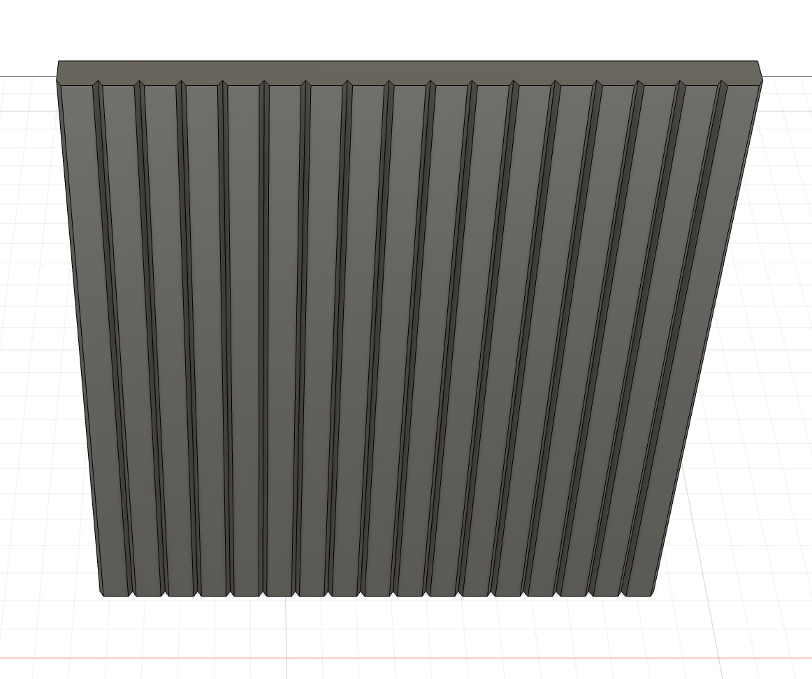

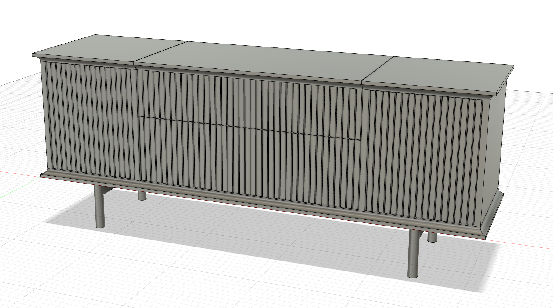

I'm about to start a build on a record cabinet that will have bevel slat doors and am looking for some advice/knowledge from anyone who has had experience making something similar. The doors will be solid flatsawn white oak with the slats running perpendicular to the grain. I'll be cutting the slats (1/4" deep 60 degree v-groove ) on the CNC. The doors are slab style so I won't be able to rely on a frame to help maintain flatness and account for seasonal movement. The largest door will be 16" x 18".
I'm a bit concerned about the doors warping and would like to avoid placing battens on the door interior. I have had issues with removing material from only one side of a solid wood panel in the past. Any tips? I'm not opposed to creating engineered panels (CLT, stave core or similar) but feel that 5/16" thick "veneers" are a disaster waiting to happen.

Isaac I have only done a similar door using MDF on my CNC but I too would be concerned about cupping/warping for the size you mentioned. I would also be concerned about the V bit splintering the material as it exits the crossgrain cut. That could easily be remedied by oversizing the doors before machining and trimming to size afterwards. Good luck

Thanks Jr. A colleague mentioned some concealed door straightening hardware from Hafele and Sugutsune that I'm looking into. They're meant for larger doors but I believe I could cut them down. Also thanks for the heads up on the splintering - I'll oversize them or use a backer to avoid this.

Give some thought to the hinges you select. You will have a very shallow depth of material in the hinge area if you use typical euro cup hinges. Also do an expansion and shrinkage calculation to estimate how much the door height will change seasonally.
I don't envy the finish sanding you will have to soften all those edges.
