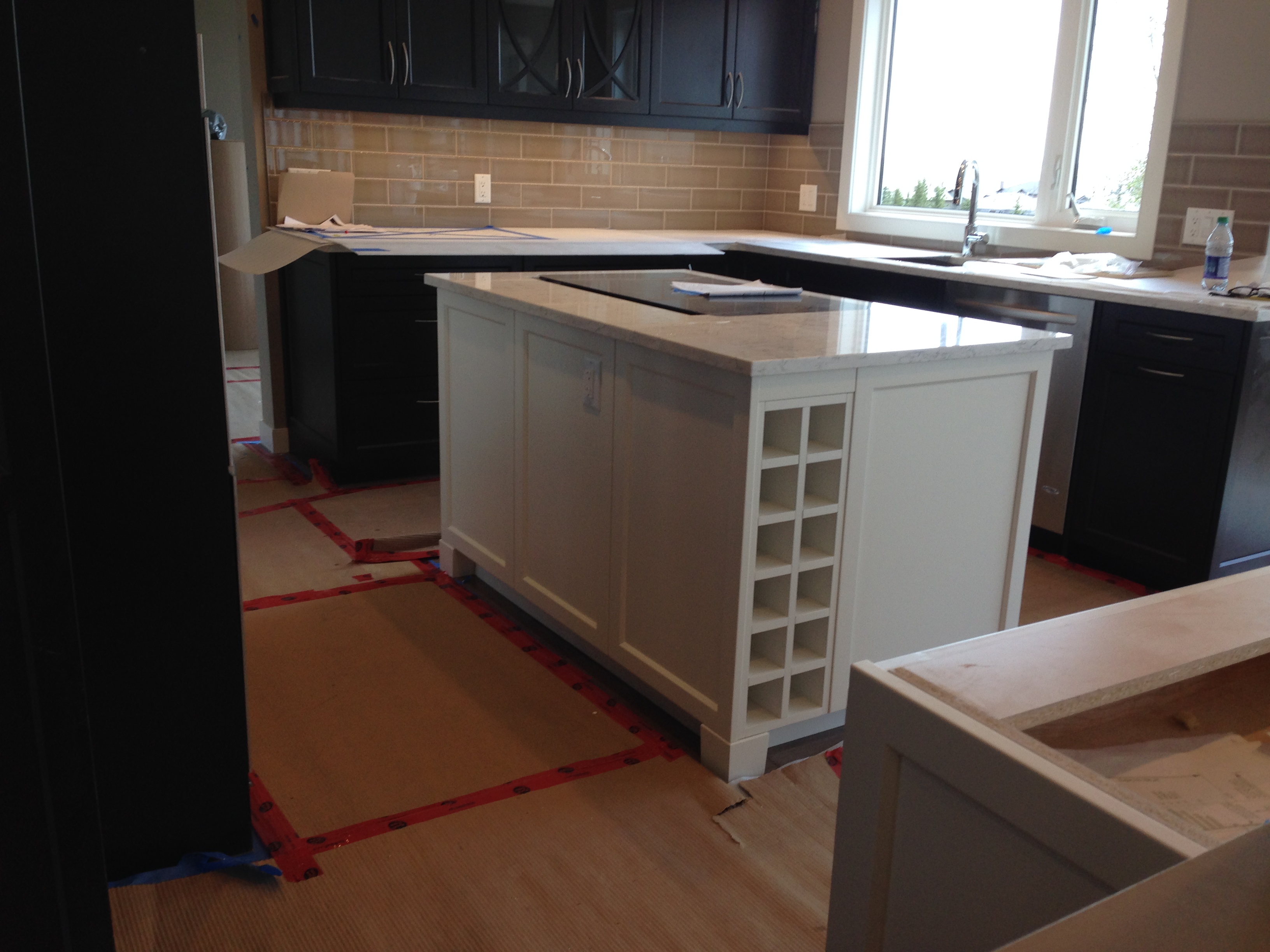

I need to make removable back panel for kitchen island that electrician can have access to fan (cook top and lit up fan will be installed in island)
Any idea what I can use for invisible panel clips? I was thinking to use magnets.
Any suggestions will help

French cleat won't work . This is full size gable and don't have any Clarence
Same for lamelo . It looks that is not removable

I was thinking about using magnets on for corners and to protect from sagging drill and insert 4 pins in corners
