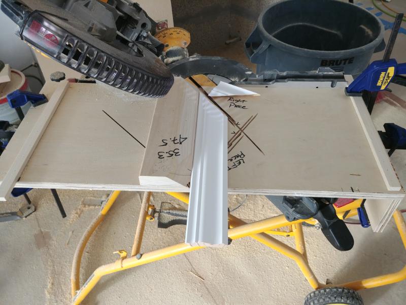

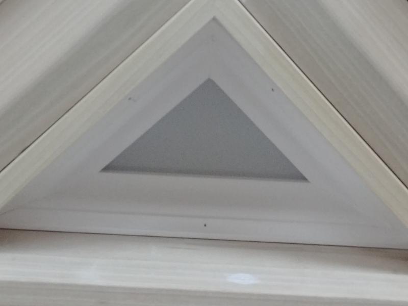

I have a question for the install guys/gals. I have been installing a coffered ceiling and came to a point while putting up my crown where I wasn't sure how to go about a situation, and if the method I used was the best one. In one section of the ceiling, the beams are meeting the wall beam at a 45 degree angle. As a result, I have areas that are triangular with 1 - 90 degree corner, and 2 - 45 degree corners. I always cut my crown flat so what I thought I needed to do was look in my chart, find the 45 degree angle between wall, set my saw and go. What I found is that from 60 - 189 degrees, there was no information on my chart. Then I Google searched and again found nothing either in a chart or calculator. So after finding nothing about it and thinking for a few minutes, I decided that I needed to set up a reversible parallel fence and approach it from that direction. I found that by setting my miter angle to 34.5 and my bevel angle to 47.5, I could get my joints to fit fairly well. Is there a better method to achieve this joint or did I arrive at the best solution? Thank you for your time.

A couple things to try that you might find easier and safer.
1. Try cutting your crown nested instead of flat which, IMO, is safer and faster than having bevel and miter your saw at the same time.
2. Make your jig with a fence so you can cut the crown nested and set the jig at 45 degrees to the saw's fence instead of perpendicular. This way when your saw is at 0 degrees you're actually making a 45 degree cut on your crown. Then when you turn your saw to 22.5 degrees you know you're making a 67.5 degree miter on your crown which is what the miter cut should be if I understand your post correctly.

That looks like a 12" Dewalt slider. Why on earth would you cut crown on its back? The primary reason for 12" blades is so you can cut 6" crown leaning against the fence.
It is so much easier & faster when making minor adjustments.
At the end of the day your method works well in that case for a couple of cuts.

Steven and Adam make good points. The way you're doing it works, but takes way too long. Spend 15 minutes and make a couple of jigs to hold your crown up so you can make all the cuts with miter angles only, no blade beveling.
After watching inexperienced guys in my shop making multiple trial & error cuts before getting it right (and often ending up with a piece of molding that's too short), I built 3 jigs for the different sizes of crown we normally use. Now, anybody in my shop can make good cuts the first time. And time is money!

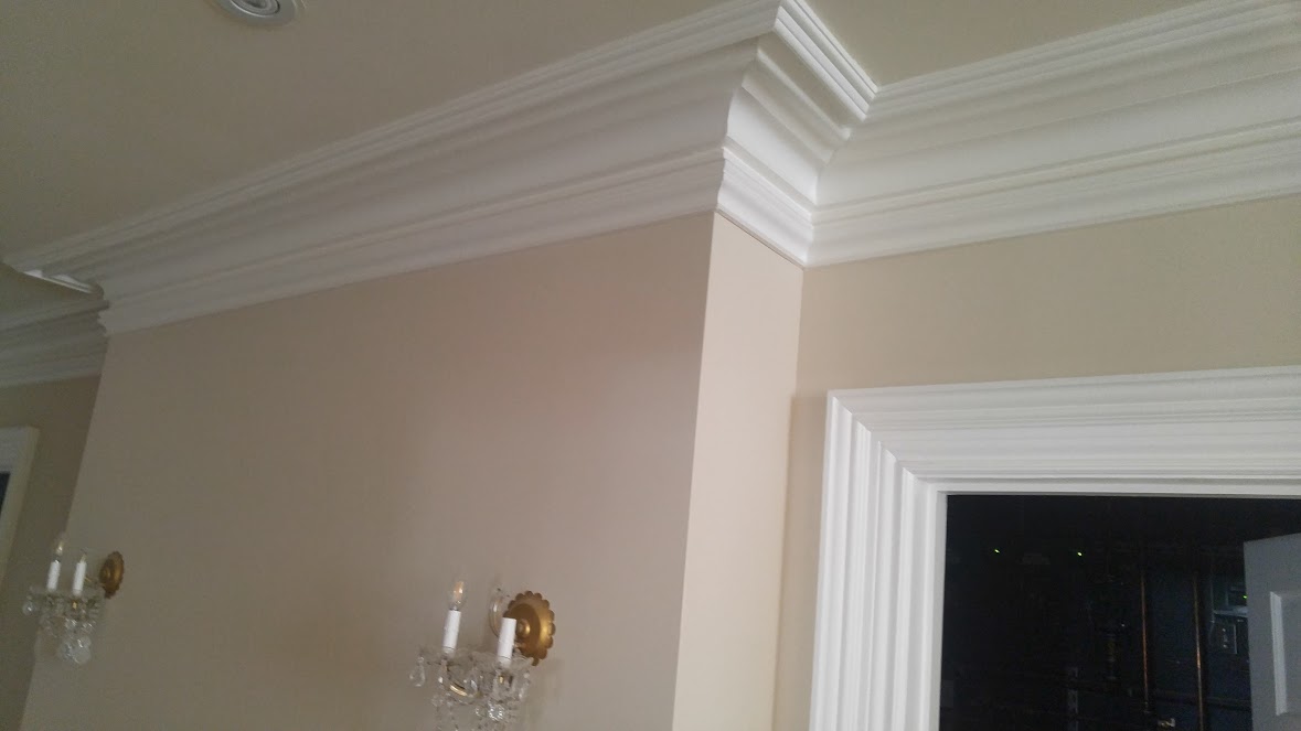

Here a photo of 5 piece crown did 3 floor in a 100 year old home .Had to be fast used no jig would have been hard to cope [ would have slowed us down ] there was no straight angles .
I reliazed when answering that you have a unique angle did you come up with solution ?
