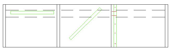

Here are three ways I would fix it. Easiest case is that you have to cut out a 4" strip of drywall and replace with 1/2" or 5/8" thick plywood depending on the drywall thickness. A good piece of hardwood scrap would be better.
It would be better to sister a wooden 2x4 to each metal stud. You should be able to sneak in a 24" 2x4, then rotate it and secure it to the metal stud, even putting in a couple through the face of the drywall. (See illustration I attached) You could then reattach the drywall piece you removed and patch the drywall, if required. Or put a piece of plywood or hardwood across the hole as mentioned in option 1.
The most difficult would be if the wall is an exterior wall and you have to lug a hammer drill down and stack some 2x4's (i would use treated one the first one) to the foundation wall and build out to the correct wall depth. This isn't my favorite, but it should work as well. I would even angle my tap cons a few degrees in each direction to help with pull out.
All three of these would probably work fine, and are better than what you have. The first option might still be on the weak side, but I don't know your exact site conditions. Are they light gauge studs? 30" On center framing doesn't really make sense, to I would probably want to error on the side of caution.
