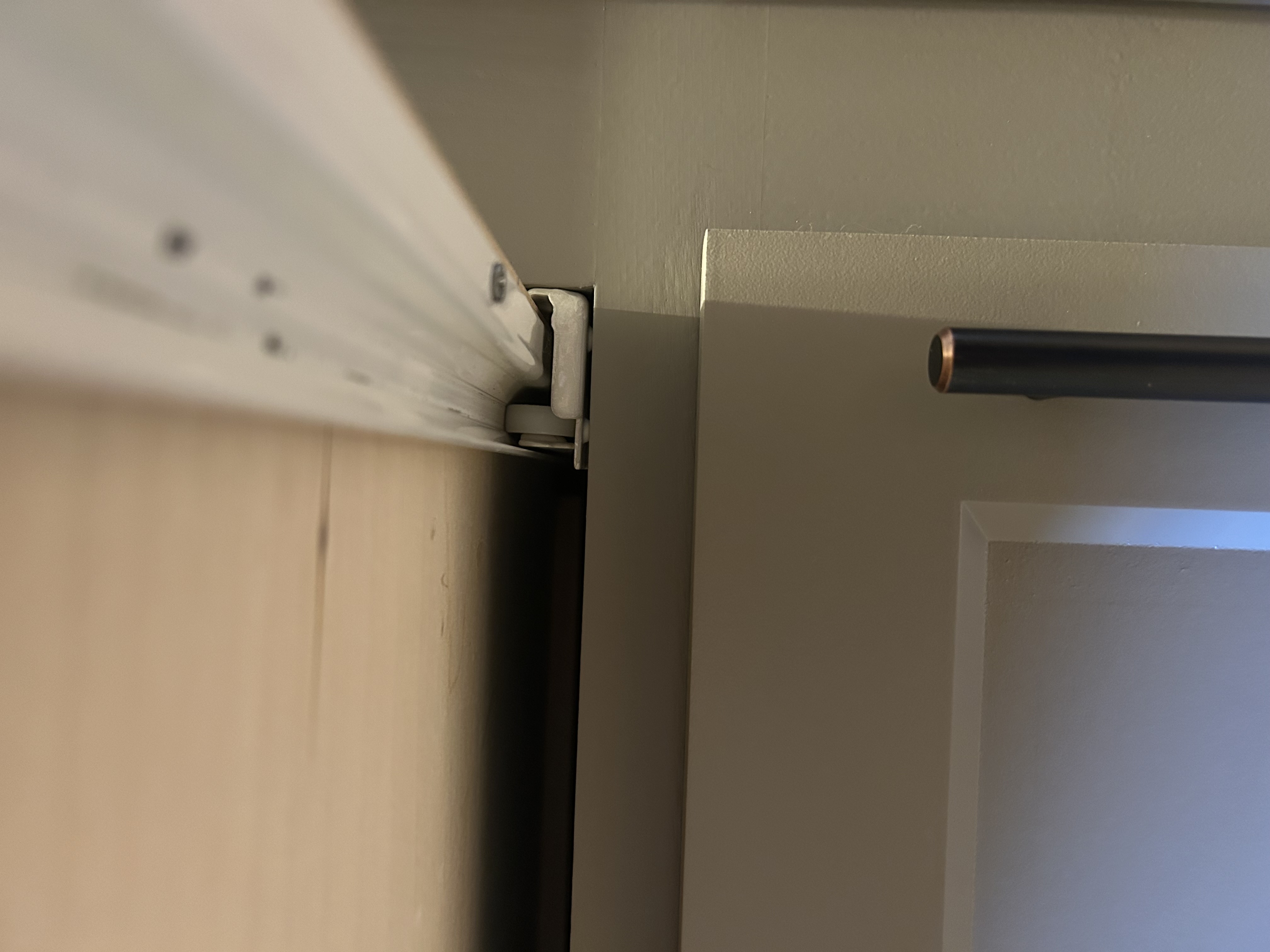

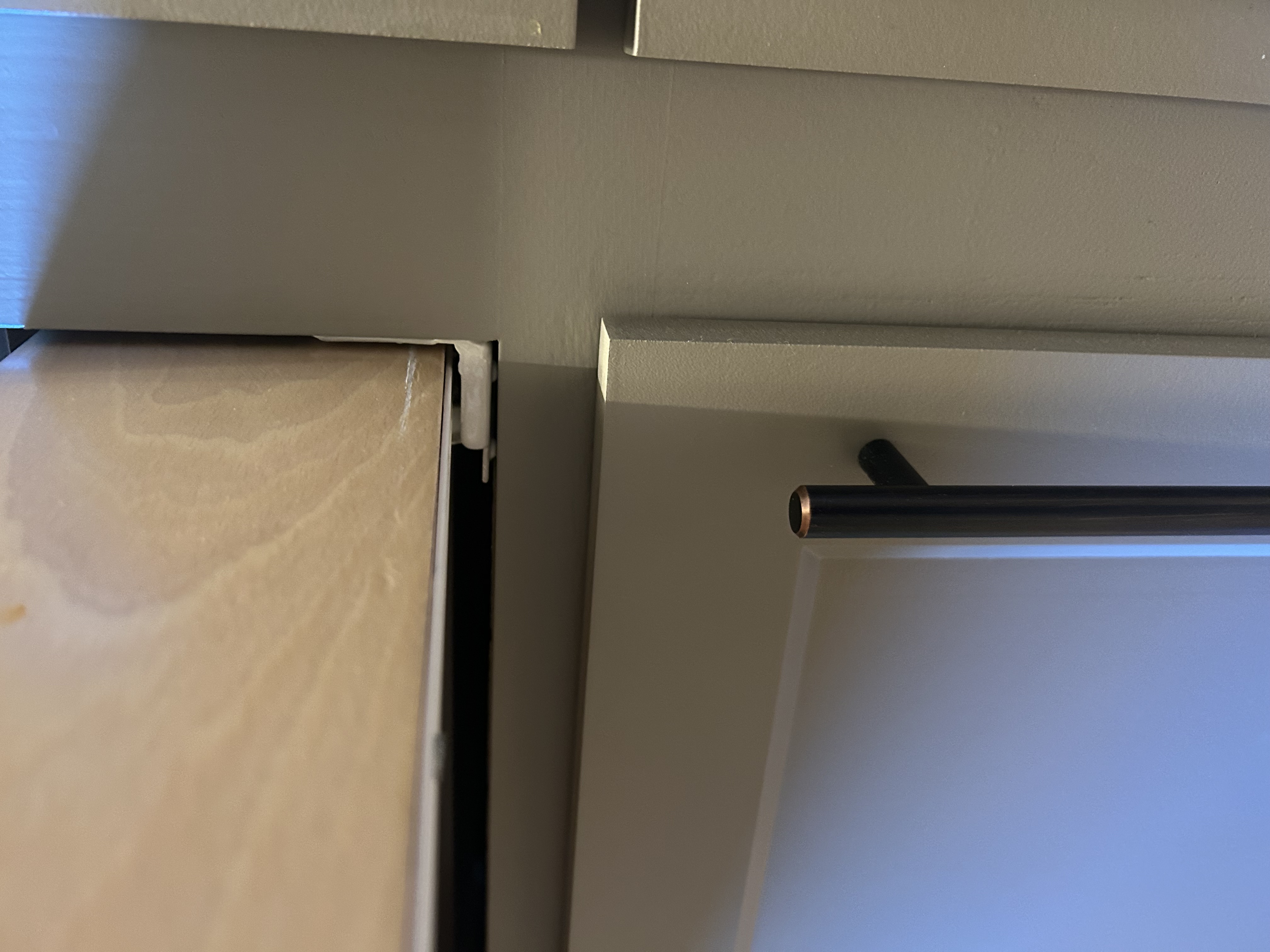

Hello
I am looking to replace these drawer slides with something smoother and nicer quality. I want to keep all the existing boxes. Can anyone help with suggesting what bottom mount slides can be retrofitted to work on this existing set up?? Thanks
12/24/25       #3: Replacement drawer slides ...
What's the dimension in between the box. Most side mounts need 1/2" on either side, undermounts depend on the thickness of the wood. What about getting the same slides but new.
