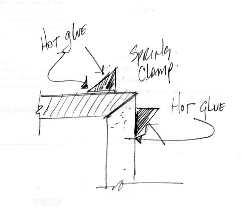

hot glue a beveled strip of wood on each length and use spring clamps. You are not getting the pressure you need by folding the edge over and you will see the seam. make the strip triangluar so that when you glue the strip the pressure from the clamp is perpendicular to the joint.

Dave Edgerton  Member
Like this

Dave, thanks you for the tip! I will try this the next time we run solid surface throught the shop, which will be soon. The only problem with that method is how much labor is added when your doing 20 tops...
