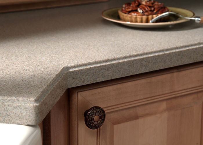

I am new to solid surface fabricating and I am attempting to duplicate a Corian edge treatment that is in the picture below. I have looked at many router bits but nothing that looks like the edge. Does anyone have any suggestions? Thanks

Thats just a partial of the appropriate sized ogee

What for you mean by a partial ogee? How would I go about that? Thanks

Can you get me a good side view of the image?

The partial ogee I mentioned was just any standard ogee bit held up high as not to get the full round of the upper portion of the ogee. Just using the bottom 2/3 of whatever cutter matches your profile.
It a pretty straight forward edge.
