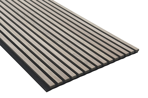

Hi, I need professional advice with laminating and veneers and I want to know how I could make a product similar to this one:
*please check attached pictures
This is acoustic panel, with mdf cubes with valnut veneered onto the top it, and the back panel is sound dampening material, I have already bought the backpanel material but I am having trouble with the mdf veneering,
Can I laminate the veneer onto a whole mdf panel and then just use a normal table saw to cut it down to cubes? Will I have to plane the cubes individually and sand them down to leave a nice finish? or is sawing them down enough?
View higher quality, full size image (591 X 394)
View higher quality, full size image (1800 X 1200)
10/31/20       #2: laminating to mdf board ...
If you have a decent table saw and blade, you should be able to rip the MDF with the walnut already pressed on. Glue it in place, then sand the faces lightly and run up and down the edges at an angle to clean up the sawn corners.
If you are buying commercially pressed Walnut on MDF, you should be in good shape. Do not count on peel and stick or similar adhesion methods as suitable for the ripping. When attaching to the larger panel, glue sparingly, but thoroughly.

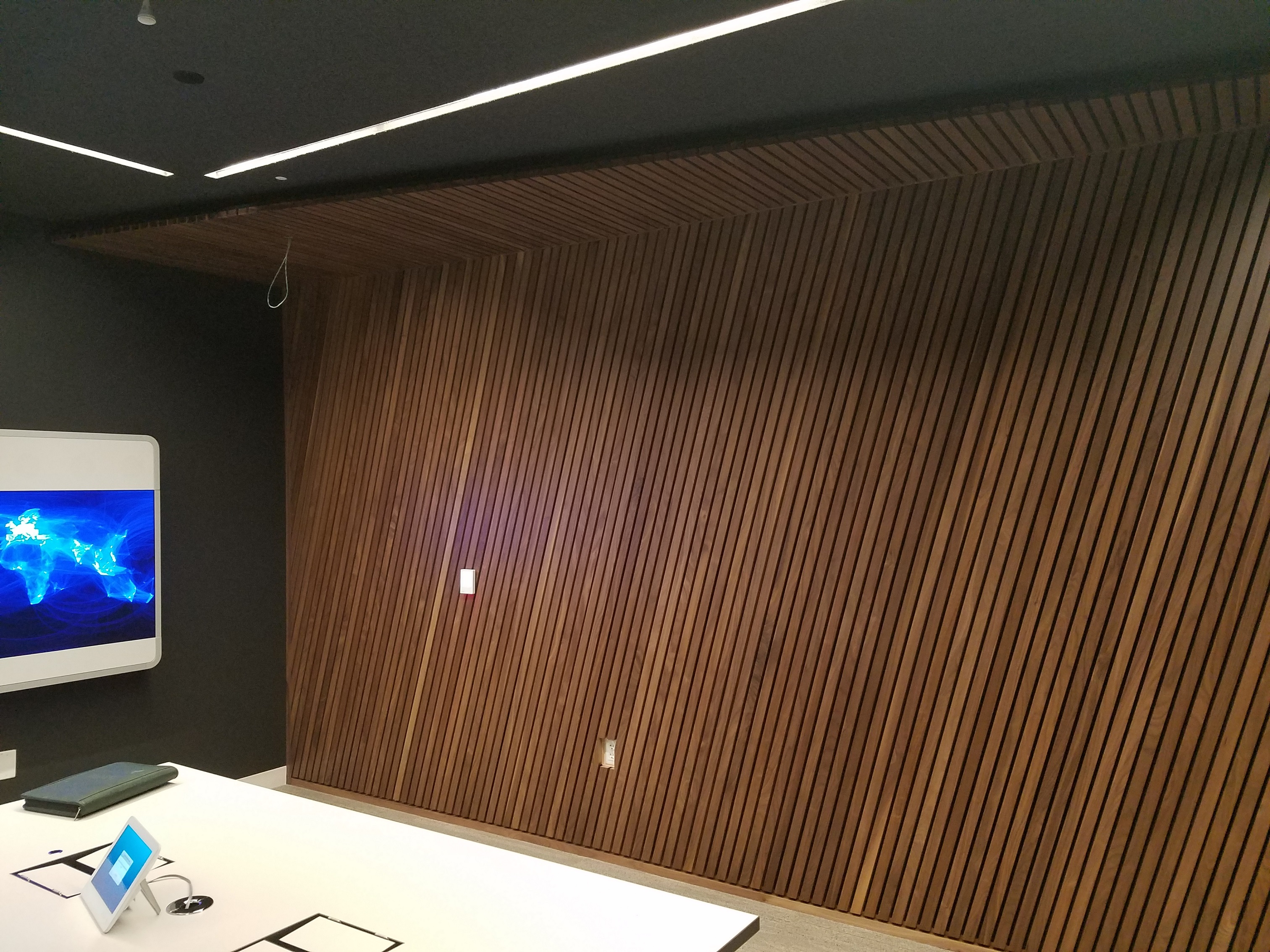

11/2/20       #3: laminating to mdf board ...
Alan F.
Fabric wrap a panel, mount the strips to the panel
A-
View higher quality, full size image (3024 X 2268)

12/25/20       #5: laminating to mdf board ...
Andy
I think laminating the substrate entirely, and ripping them down from that large sheet would make it easier to remain consistent from cube to cube, not to mention the workflow improvement
There's a crew at my current job installing ceiling grid panels that are in this same type of product category, I'll see if I can get some pictures of the pre-installed product to see what they've done.
