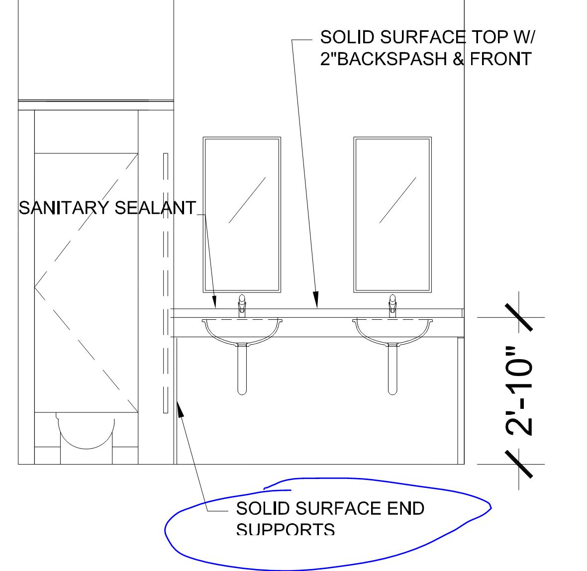

I'm bidding a project where they are calling out solid surface end panels. Anyone do this? seems like a bad idea with the somewhat brittle nature of Acrylic Solid Surface.

Get a hold of the person you're bidding for and bring that to their attention

Simple there is no warranty for chipping after installation

We do alot of commercial solid surface jobs! Hospitals, schools & 7 showers next week for a local college. If it's a 100% acrylic and not a polyester blend then it's going to be stronger than u think and solid surface is easy to repair sand & make new again.

Wilsonart makes laminate panels for this sort of application, up to an 1" thick. Same material as counter top, just thicker. Solid surface that is 1/2" thick, I'd question the edge impact strength. There is a reason that powder coated steel panels have dominated the bathroom industry.
