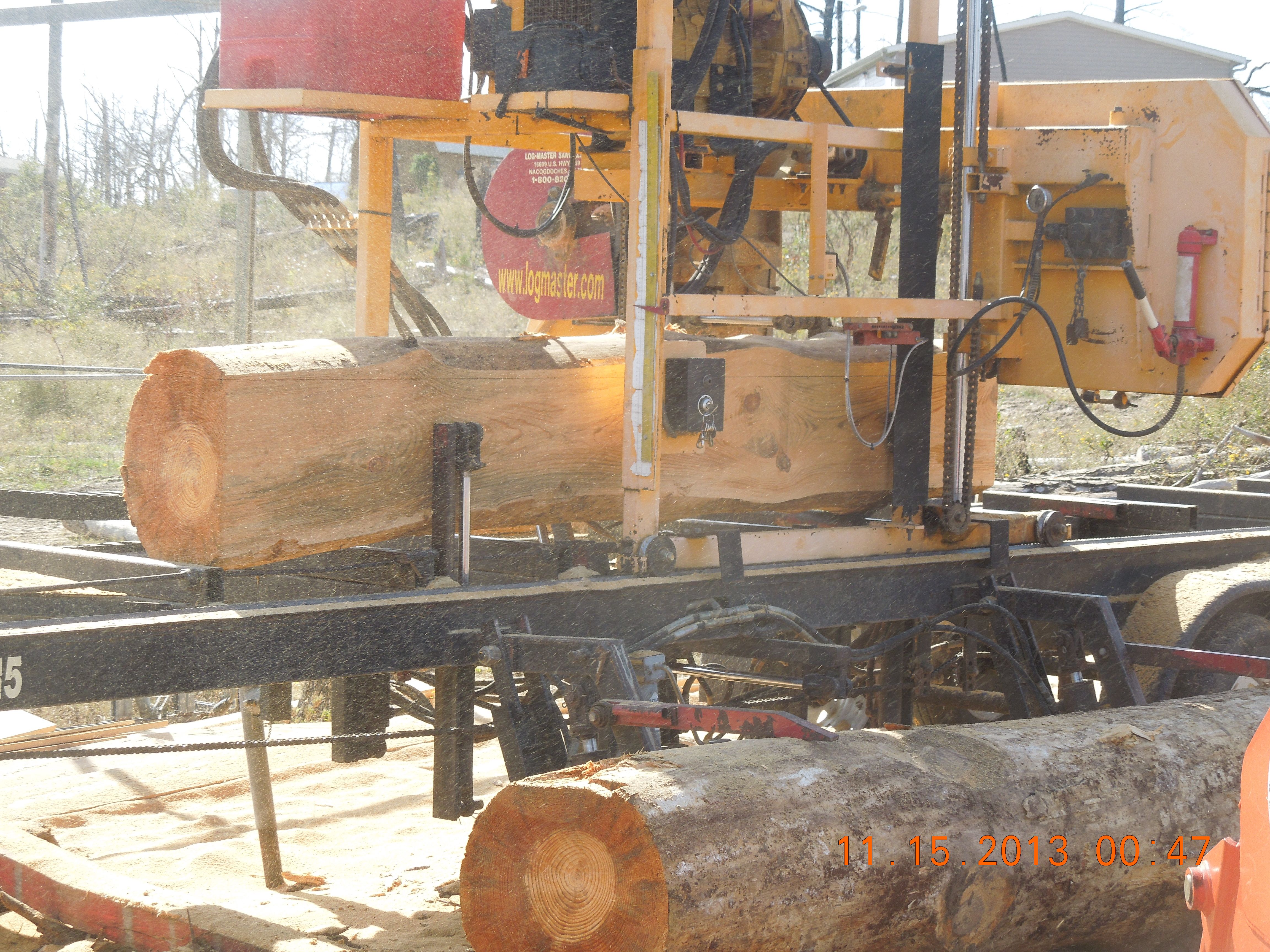

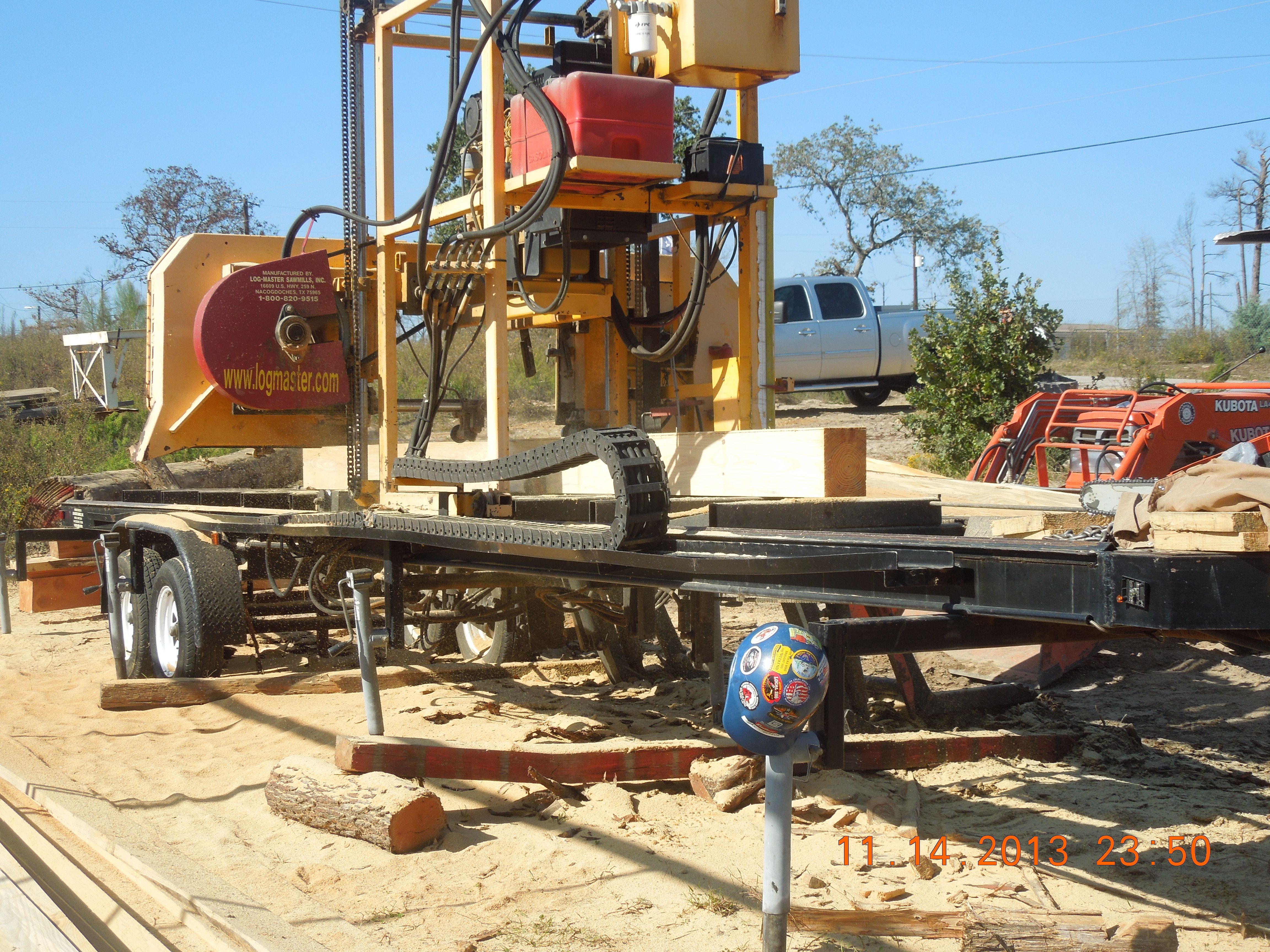

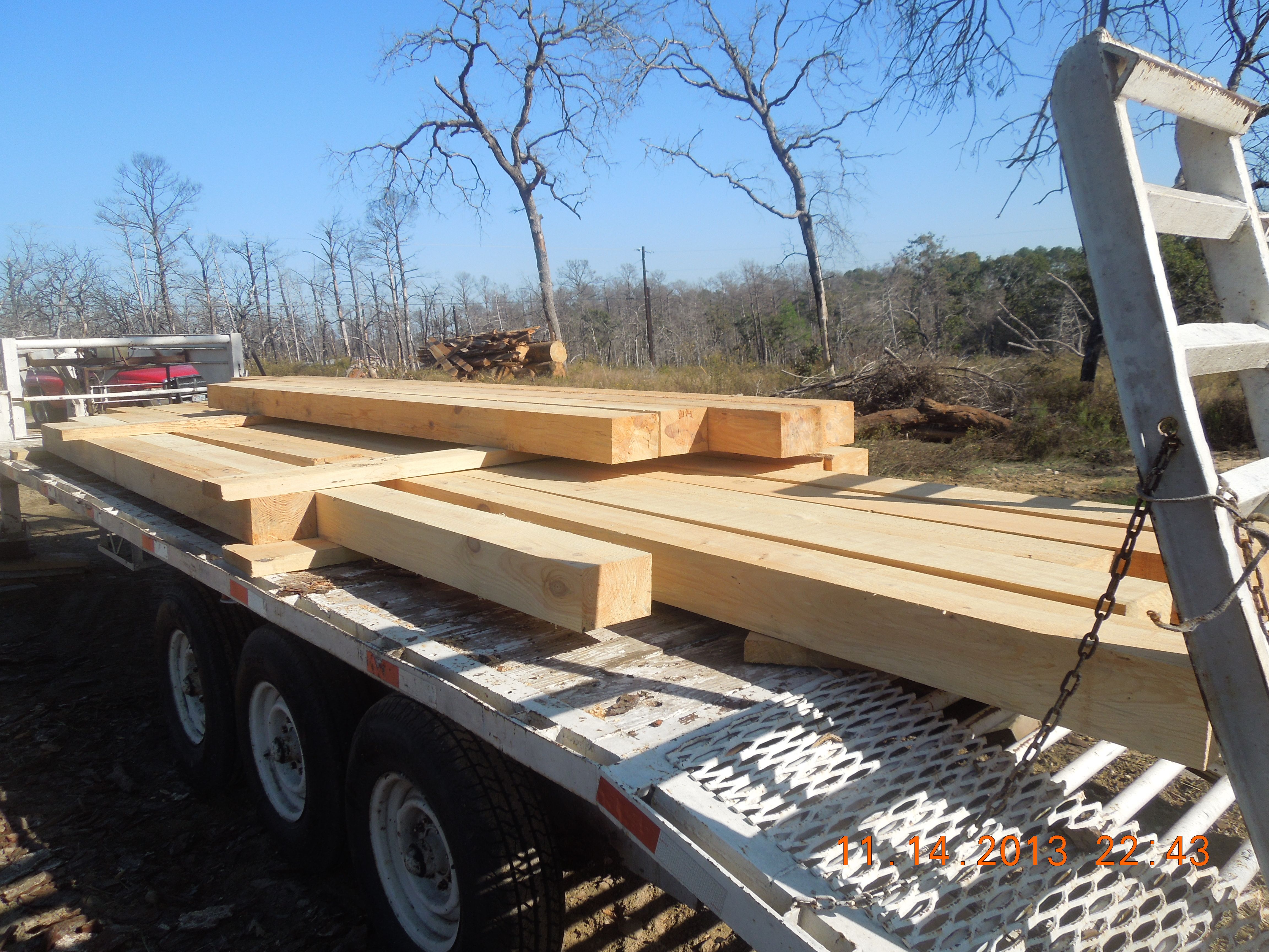

Sam
I bought a used mill about 2 yrs ago from an ad on sawmill exchange, the mill was 3 yrs old when I got it and it runs great it's a Log Master LM4 which retails for $40,500 and I got it for less than half price.I have cut a lot of beams up to 25' long for customers building new homes.

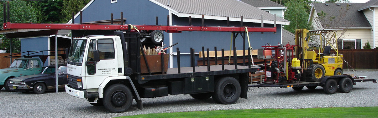

AJ Mearns Member
Just remember, you get what you pay for. Cheap mills are slow if your not worried about how long it takes. I have only seen a few mills that would be worth owning. A friend of mine has a Norwood mill, and I have to laugh on how slow it is and all the problems he has had with it. my two Cooks' mills will last a lifetime. I am posting a picture of my portable set up.
View higher quality, full size image (1206 X 377)
3/6/14       #11: I need a very basic sawmill that is ...
AJ Mearns Member
Forgot to tell everyone that it will cut up to 31' long or many logs all at once end to end. The most logs I have had on the mill at once was 8. Very high production.
Be save people!
