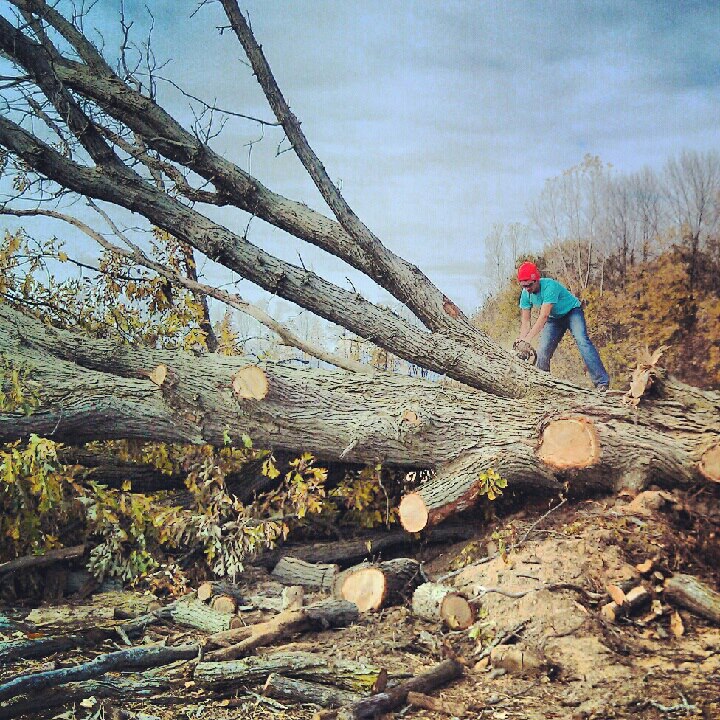

alljays
I take that back. Looks like it might be a white oak. Here's a picture of my kid working on it.

12/16/14       #8: tree trunk table top cupping ...
Rod Hays
Looks like it's an Elm or a Black Oak to me.
