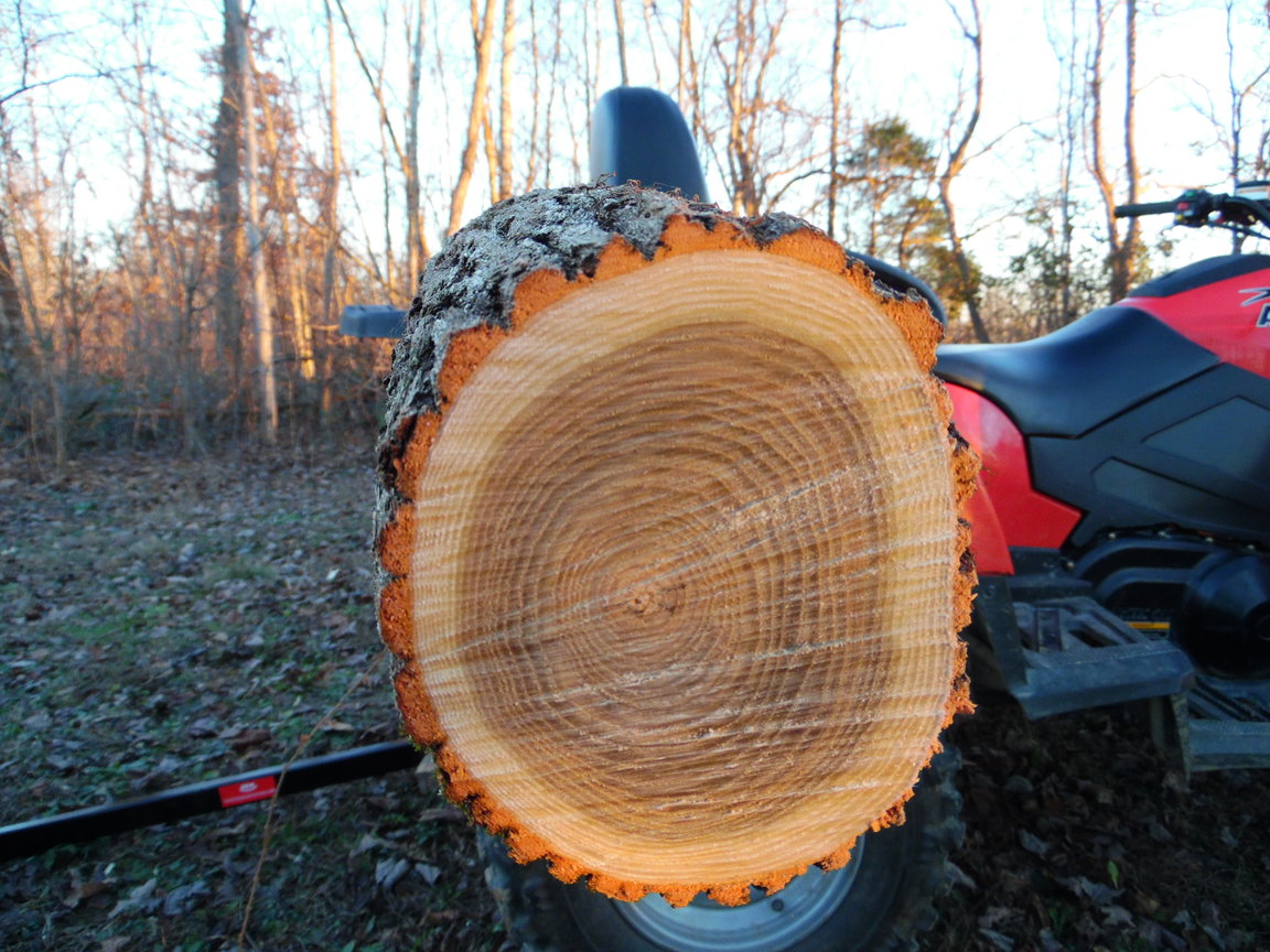

Can anyone identify this tree. We used a log to repair a door header in a log cabin. Initially we thought it was black locust but we were unable to locate any seed pods and the trees are completely absent of thorns. The bark was rough and deeply furrowed on the bigger tree. Many logs were also out of round. The bark peeled fairly easy it had a very bright orange cambium layer. The wood also split very easy green. Other guesses were gum and elm. Easy splitting makes me doubt elm.

Gabby Hays
It's gum.
12/5/15       #5: please help identify wood ...
Dale Lenz
Website: http://www.beautifulwoodworks.com
Cut/peel the bark or scratch a twig, I'm betting you will smell "root beer". Believe you have sassafras.
12/5/15       #6: please help identify wood ...
Tennessee Tim
Yep....that'll be sassafras. Just sawed my tree to logs today. Smells so GOOOOOD when sawn!!! If straight grain it will split real good. Has more rot and bug resistance than most woods IF kept where it can dry after getting wet. Alot of older farmers here used as fencepost but mostly for gates, doors and wagon beds.
12/5/15       #7: please help identify wood ...
Shaun
Forgot to mention I am in south central Kentucky. I believe it might be sassafras. Some of the leaves I suspected belonged to these trees were similar to white oak.
12/5/15       #8: please help identify wood ...
Shaun
A sawyer friend of mine thought it was sweet gum but the grove of trees didn't have any star shaped leaves that i could identify and also didn't have any woody type seed pods.
12/7/15       #9: please help identify wood ...
Gene Wengert-WoodDoc
Sassafras has an unusual annual ring pattern, which the end grain of the log also shows above.
See the link below.
sassafras end grain

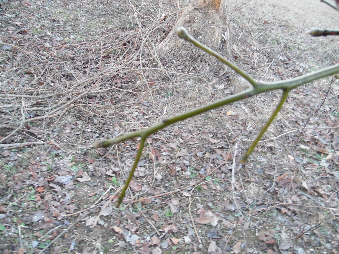

1/4/16       #10: please help identify wood ...
Dave Boyt  Member
Website: http://www.norwoodsawmills.com
The shot of the twig also gives it away. Sassafras and boxelder are the only two trees I know of with green twigs (all year).
