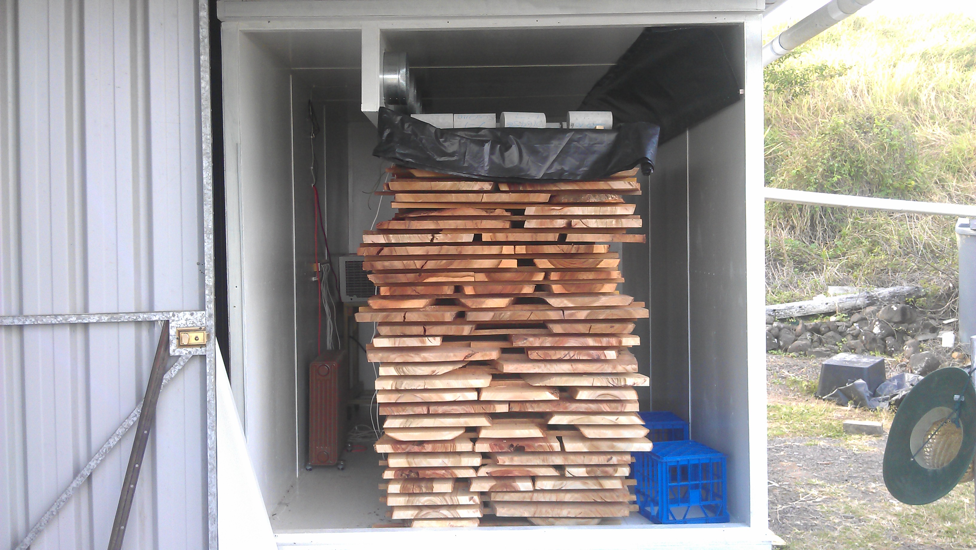

I have just finished building a simple DH kiln The size is 2.400mm High By 2.400mm wide. 3.600 long. I have loaded a stack of 35mm camphor laurel into it. With 25mm stickers The stack is 1200 wide. and a length of 3.600mm ans 1.800mm in height. I have 6 x 250 mm bathroom exhaust fans. I am concerned regarding the output of the fans. On the intake side the reading is 1250 feet per minute per fan. So the overall adding all fans together is 7500 feet per minute. This is cycling through the stack. I am not detecting much movement of air on the out side of the flow. I am not sure if I have built up enough pressure to evenly push air through the whole stack. I am concerned about getting mould problems so I havent fired the kiln up yet. All help appreciated

Your square corners (walls meeting ceiling) are part of the problem. The air hits flat into them then misses all the circulation up. Next...is there a air space down the back wall for the air to flow down and through the stacks?? Do you have a set of plans or is this guess work?? Drying is a tricky process BUT you can learn it. My concern at this time would be mould due to it sitting in the kiln and NO air movement.
I ask these questions because after seeing your website it's obvious you've been buying your "KD" wood somewhere else and haven't ever ran a kiln by your setup and comments. 7500 cfms is quite a bit BUT I don't know what is needed for your setup BUT you should be feeling air movement. Is that a Dehumidifier or just a heater in pics??? I see several lines or wires...is this part of the drying setup or other???
I own a small self built kiln also BUT I done alot of research prior to building.
Your stating KD wood is this also sterilized or just dried to a certain MC?? Yes it can be done either way and should be both.
Keep us posted.....Oh Yeah....BEAUTIFUL boards your building!!!!

Thank you for the reply, the kiln was loaded 2 days ago. I have the same amount of space on the other side of the stack, the wires are fed into the stack and attached with screws so I can get a correct reading without having to open the kiln. I basically followed a design i found online (http://dnr.wi.gov/topic/forestmanagement/documents/pub/FR-396.pdf) We sell a lot of boards a year and because of demand for camphor laurel bread boards I could not find a good supply of kiln dried timber. I have researched the subject a lot before considering building my own kiln. I am using an air conditioner with a hose connected to the outside for collecting and measuring the amount of moisture that is removed on a daily basis in conjunction with a heater to get the temp up to 60c. I also have a humistat installed for relative humidity and also temp control. I found a kiln drying schedule and intend to follow it. I lit a candle and held where the stickers are and there is a slight change in the movement of the flame, which tells me that there is some movement of air at the bottom of the stack.I took the image displayed after connecting one of the 2 large doors. I have uploaded another image of when I eas painting the internal. The walls are ceiling and doors are insulated with r4 grade insulation. My aim is the reach mc of about 15 to 18. regards Stuart

You are confusing FPM and CFM. FPM is the velocity of the air and when average air velocity FPM over an area is multiplied by the area, you have CFM. I am sure the area that has 1250 FPM is much less than a square foot so you have much, much less air flow than you calculate. A typical toilet exhaust fan is usually 75-100 CFM. But don't worry about it. See how it dries after this load. The volume of air has more to do with the amount of water the dehumidifier takes out and you have a small one. It will be slow but might work out.

Thank you Don for the response, I looked up the specifications on the fans and the air movement is 294 CFM per fan. So by multiplying 294 x 6 =1765 CFM. I started the drying process 12 hours ago the temp was 60°F (16°c) and now it is up to 82°F (28°C). The amount of moisture in my bucket is 2.9 gallons (11 litres.). The drying schedule says for camphor 140°F (60°C). I am aiming for 104°F (40°C) to start then slowly work my way up to 170°F (76.5°C) dry bulb for 20% to 15% MC. The wood is measuring above 50% MC at the moment. All comments are appreciated. regards Stuart

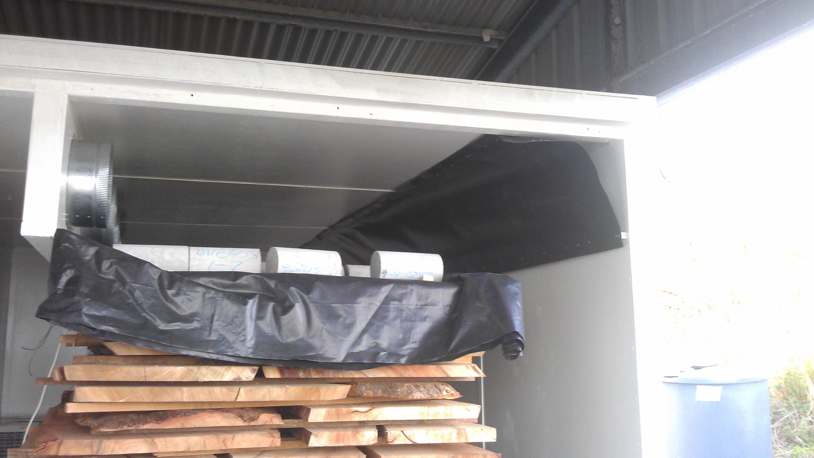

Thank you for all your help Tennessee Tim, I upgraded the fans and did what you suggested and install a 45 degree baffler which has helped enormously, the breeze is actually going to the floor,which will help the bottom of the stack catch up to the rest. Then I may need to turn the fans down a touch so that it is even through the whole stack. Regards Stuart

The temperature limit on heat pumps (which is the name for air conditioners, refrigerator compressors, dehumidifies, etc.) is not for fire control, but reflects that performance of the gas used in the compressor and its lubrication. Most cannot run above 115 F about.
The original posting says that the lumber pile is 8 feet long and the stickers are 1" thick (1/12 foot) and there are about 30 layers. So, this means that the air space is 1/12 x 8 x 30 or 20 square feet. So, then take the cfm and divide by 20 to get the velocity. So, 1200 cfm means 60 feet per minute. For white wood drying and pine, we need over 600 rpm velocity. For most hardwoods, 300 fpm.
We also need a good sized space between the wall and the edge of the lumber pile. I suggest at least four feet. Plus as mentioned, using a curved baffle in the top corners will help flow.
Do you reverse air flow?
It is fundamental that the volume of air going into a load is identical to the air coming out. So, if you have 300 fpm air velocity going in (which is extremely hard to measure accurately without spending thousands of dollars), you must have the same average coming out (which is easy to measure). If air flow out is low, so is the incoming.
Note the the original posting says that width is 2,400 mm. (In the US, we use a comma and not a decimal.), but it looks closer to three or four feet...1000mm. So it would seem that this load is about 900 to 1000 BF and so it will be about 28 pints or 3-1/2 gallons of water per 1% MC loss. So, your one liter per hour is about 7 gallons per day or 2% MC loss, which is fairly low for this species, and most species.
8/11/16       #21: Dehumidification air speed ...
Gene Wengert-WoodDoc
I think I have it wrong...the chamber is 8' wide, but the lumber stack is 4' wide and 6' high. The air flow data is still correct.
Now with 6 fans, if there were perfect air flow, we would have 360 fpm which is fine for many wet hardwoods. However, with the fans blowing directly onto a flat wall, you will not achieve the rated vales.
The plenum space is just two feet (and the photo shows that some places it is even less) which means that air flow at any fan speed will be variable with a pile this high.

Thank you for responding, I have upgraded the fans which are rated at 1125 cfm for each fan, I have six fans which take the air flow to 6750 cfm. I installed some black plastic sheet on the rear wall to help with air flow and have some metal sheet coming to attache at 45° angle to help air flow. My output of moisture is now up to 12 gallons a day since I changed the air conditioner. At present I am not reversing air flow. Is there a auto switch that will reverse the fans? regards Stuart
