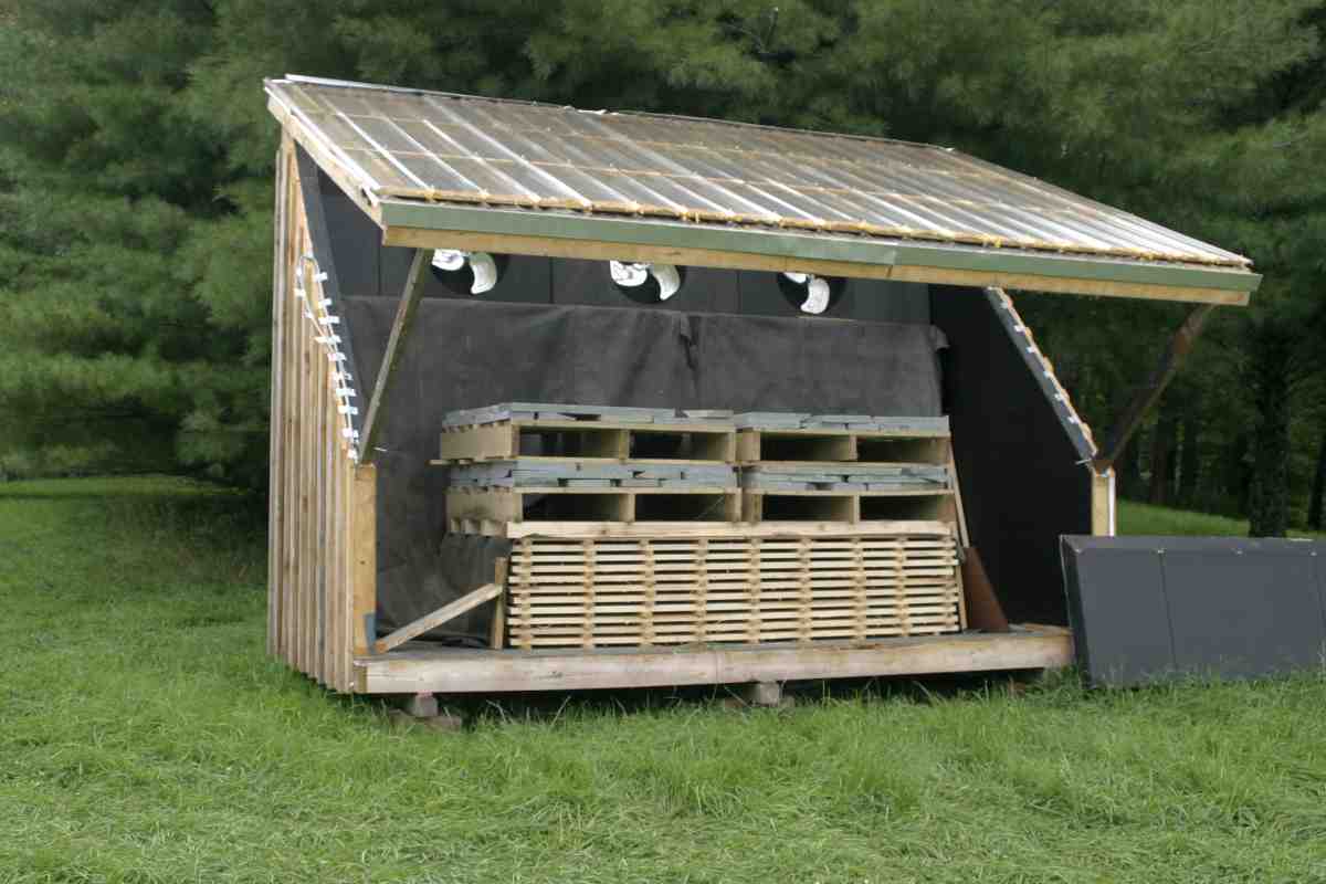

I've got a Virginia Tech design solar kiln
operating along the PA/NY border. This
summer, at it's peak, I recorded temperatures
of 129 degrees and 19% RH. I have a temp and RH
rig with both sensors located near the middle
of the stack of lumber, and keep a daily eye
on them

View higher quality, full size image (1200 X 800)

Sounds to me that under your winter conditions you are in zero gain situation using a solar kiln. Maybe you should consider adding a heater of some kind along with a small dehydrator to keep your drying process going.
Be easy enough to revert to solar when it's effective. Just depends on how big a hurry you are in to get your wood dry.
I use the upper level of my metal building and run several fans. I'm in Texas and in the summer months the temp up there is 115 to 120 during the day. This month it is 60 degrees during the day. My stacks dry amazingly fast in 60 degree temps using fans.
12/15/18       #3: Solar kilns and cold cloudy days ...
Gene Wengert-WoodDoc
As a rule of thumb, 50 F or warmer dries wood at a somewhat reasonable rate, if there is a low RH and air flow.
So, the VT kiln does not work well in cold weather.
A dehydrator, called a dehumidifier, needs about 70 F or warmer to operate. The VT kiln is not well insulated, with the clear roof, so heating in the winter to 70 F OR HOTTER is not practical. That is why dehumidifier kilns are well insulated buildings.
