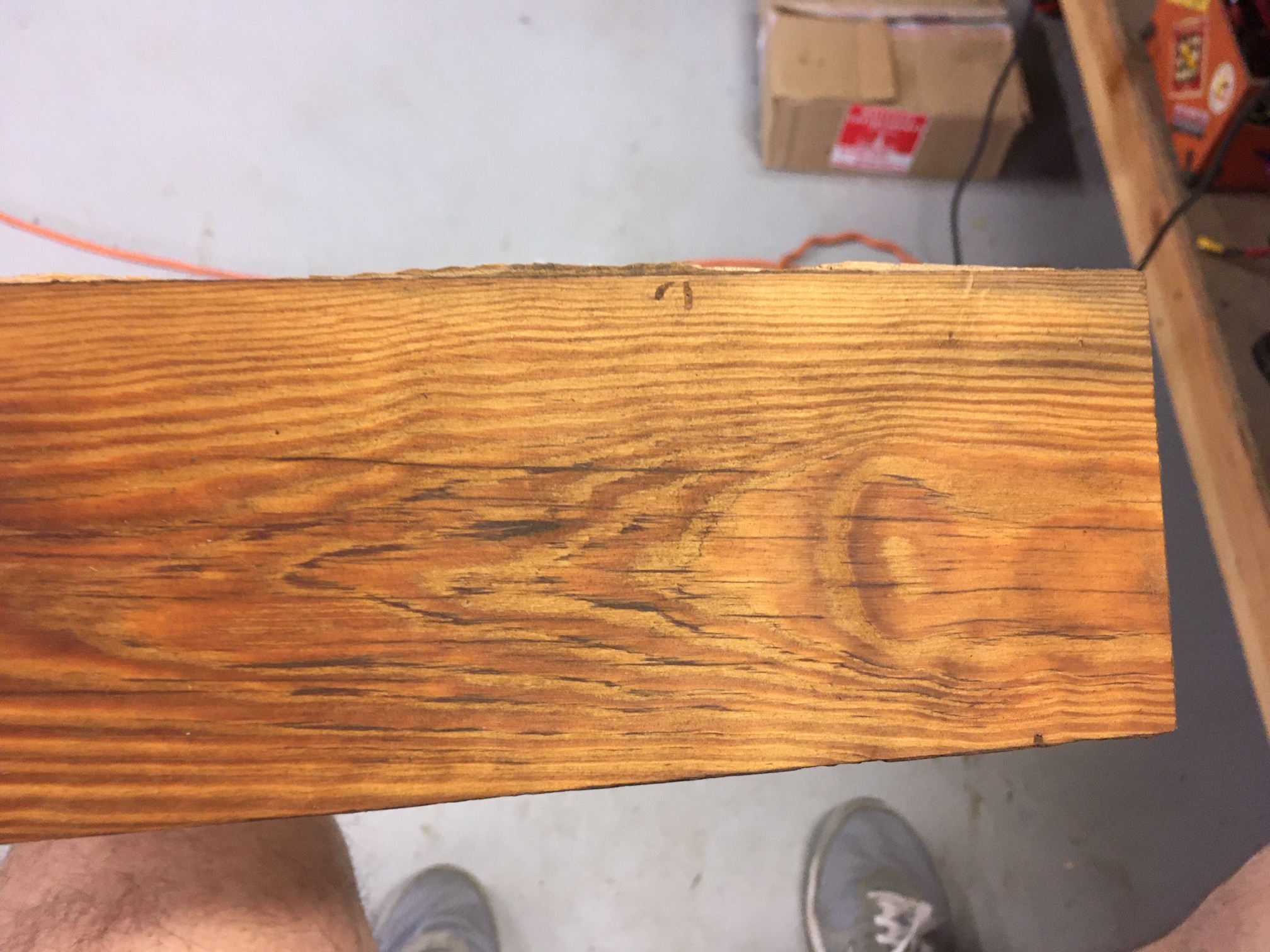

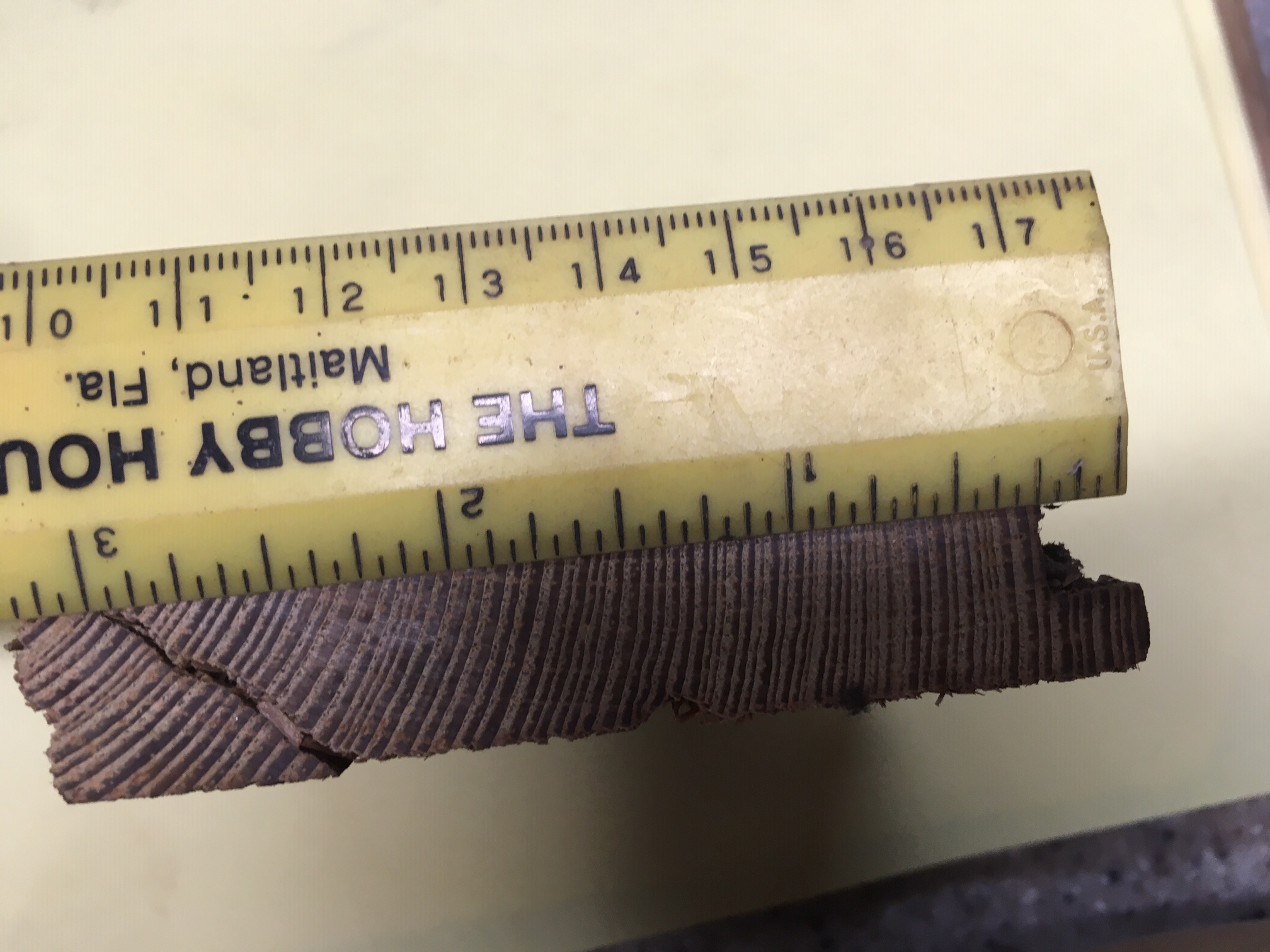

I have some nice 100+ year old heartook T&G flooring. It's 3.25" wide exposed, boards are 14-16' long for the most part, nice and straight and without knots and 17+ rings per inch up into the 20's. When sanded and a little olive oil put on the raw wood it is pretty dark for pine. With it's age, rings and characteristics we believe it's Long Leaf Heart Pine.

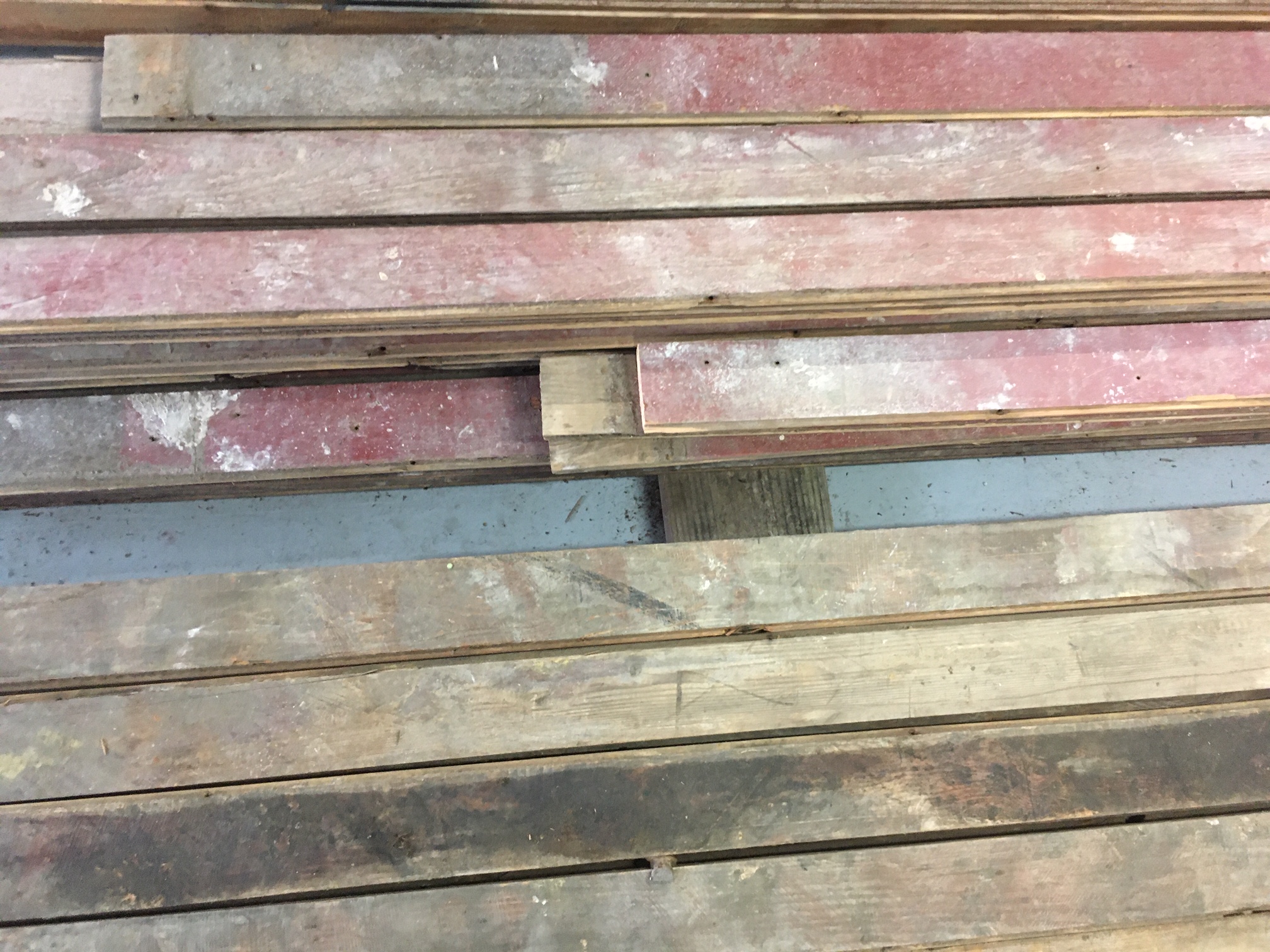

Problem is, some of the floors were painted with what we believe is a lead based paint (just one coat) as we tested it wit the 3M kit and it seemed positive.
SO, my question is, should I try and plane or drum sand the paint off the wood before trying to sell it. I only have about 1000 square ft total so not that much.
OR should I leave it as is and let the new owner deal wit the lead painted surface?

GeneWengert-WoodDoc
Appreciate that there is no way using appearances even with a microscope, to identify heart pine or long leaf pine. There is no way to specify the age either. So, a key for this wood is to have as much documentation as possible, thereby giving the wood the overwhelming evidence that it is heart pine. Use a phrase like, "based on the appearance, the historical evidence, etc., we believe this to be xxx year old heart pine...the wood from the long leaf pine Treeo that was so prevalent in the old Southern pine forests."

Brendan Meyer
Sell it as-is. Or bag it in stripper. Heavy duty poly tubing from Uline. Soy Gel stripper from Franmar. Dwell 48 hours. Turn every 12 hours. Scrape, rag off excess, rinse with mineral spirits. Goop and rags in normal trash. No dust or sanding. Can re-use Soy Gel two or three times if you really want to.
