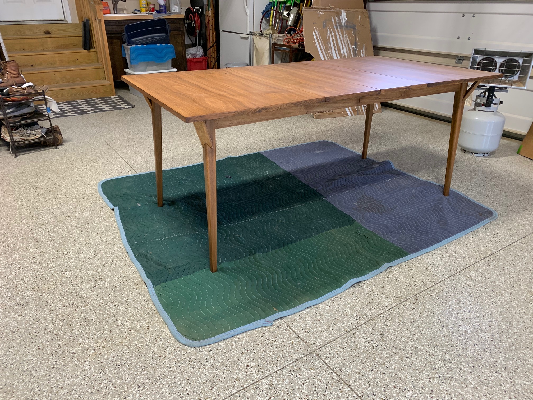

I built a dining room table for my daughter from Poplar lumber that was approximately 8 years old and had a moisture content of 9%. Unexpected shrinkage (by me) has occurred evidently due to the wood continuing to dry out due to dry natural gas heat. I cannot get a new RH reading as she lives 7 hours away. Question / issue: I understand the shrinkage of the top as it has reduced each half of the table has reduced from 24 inches to 23 5/8", Skirt staying 24" (in total 48" to 47 1/4"). The leaves have reduced from 12" to 11 13/16" (skirt staying 12") My question concerns the skirt did not shrink causing the skirt ends to hit before the top edges close, leaving a ~3/4" gap. 1) I can remove the skirt and trim back to match the table, but I am concerned that when the gas heat is turned off in the spring, the table top will grow and the "cut off" skirt will not come together. Granted it is better the top to close than the skirt, but I would prefer the top and skirt to stay together. The climate is Arlington Va. where AC will be used in the summer. So what do you think? Would you expect the top to grow in the spring? Please assume good home construction and HVAC operation. Other Options? Please note the pictures are before unexpected shrinking. thank you.

The answer to your question is yes, expect the top to expand in the summer as the relative humidity rises. It will not expand to it's original dimension though.
The skirt can be mounted with fixed screw locations at the top joints and slotted screw holes towards the ends (you now know how much movement to allow for)
You will have to live with the gaps from the skirt on the leaves after trimming back to the winter extents of the shrinkage.
On the good side, the top didn't split from being restricted by the screws.

Many tables are purposely built with the skirts too short to start with leaving a gap of about 1/4" between skirts. A trim piece is added to the end of the skirt face to hide the gap and allow for wood movement. The trim needs to be wide enough to attach to one skirt, hide the gap in winter, and overlap the skirt beside it. The trim is usually about 1/4" thick. The covered gap acts as a slip joint to accommodate seasonal wood movement.

Of course it's going to expand in the spring, that's what wood does. Shrinks in low humidity and swells in higher humidity. The top and skirt ends can stay together if you hard fasten it by the ends of the skirt, and then allow the rest of the top to float and slide over the other end of the skirt. FLOAT is the key word. Fasten it hard and both ends and you get a couple more pieces in the top when it splits the next time it shrinks. Do some research about the material. Wood movement has been a know issue for centuries. Probably when the first slab doors fitted too tight when built, wouldn't open in the spring, and they could see light through the cracks in winter.

Knowing that wood moves, I find it helpful to plan ahead. If the top to apron connection was through tight fitting screws where the apron /top come together in the middle, but elongated or other fastening methods which allows the expansion and contraction to transfer to the overhanging ends wouldn’t show.
But then I can’t tell how those angular struts are fastened.

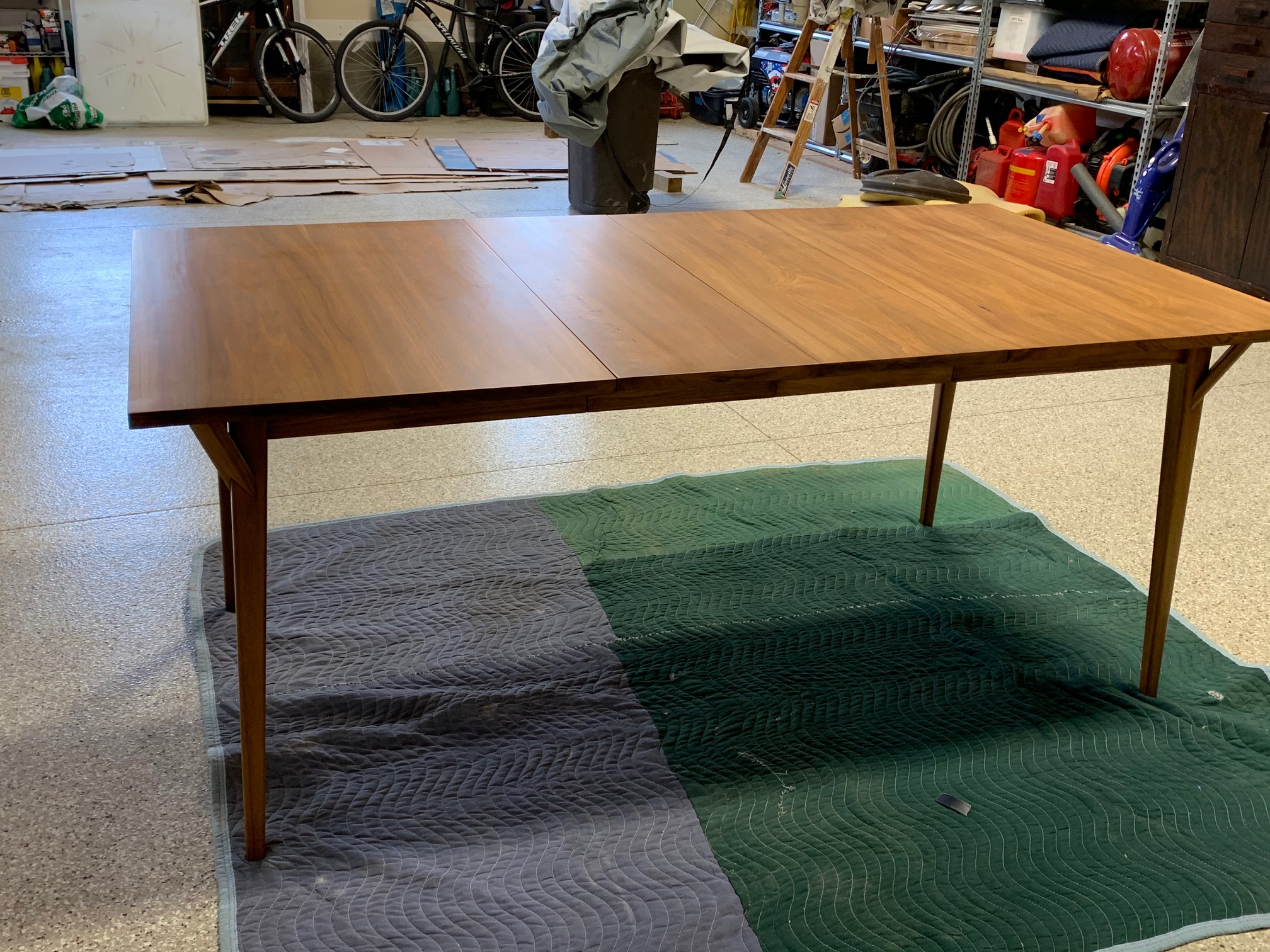

One issue with a table with the grain running as shown is that the leafs will not fit as tightly, but will have a small gap at the ends or in the middle.

MOST of that UGLY movement CAN be adjusted for in the designing for movement...RULE # 101 WOOD MOVES...Learn the directions and design for it.....IF you'll anchor solid to skirt at the split open section only and design for float/slide towards the ends towards legs around the skirt then when top shrinks and expands it will do it at end of table and not at the sliders not interfering with that joint as those are large panels. The leafs need to be anchored tight in the center of them and float both edges with skirt even or a touch short in my opinion at the time as you IF it loses moisture it will shrink approx 1/8-3/16" and I'd personally rather my top meet than my skirt so the crack will always be hidden below view. JUST my wood experience opinion.

One trick to consider, if the look does not bother you, is to make a slight grove in the top when the leaves join. This channel will make any gaps less obtrusive and obvious.
