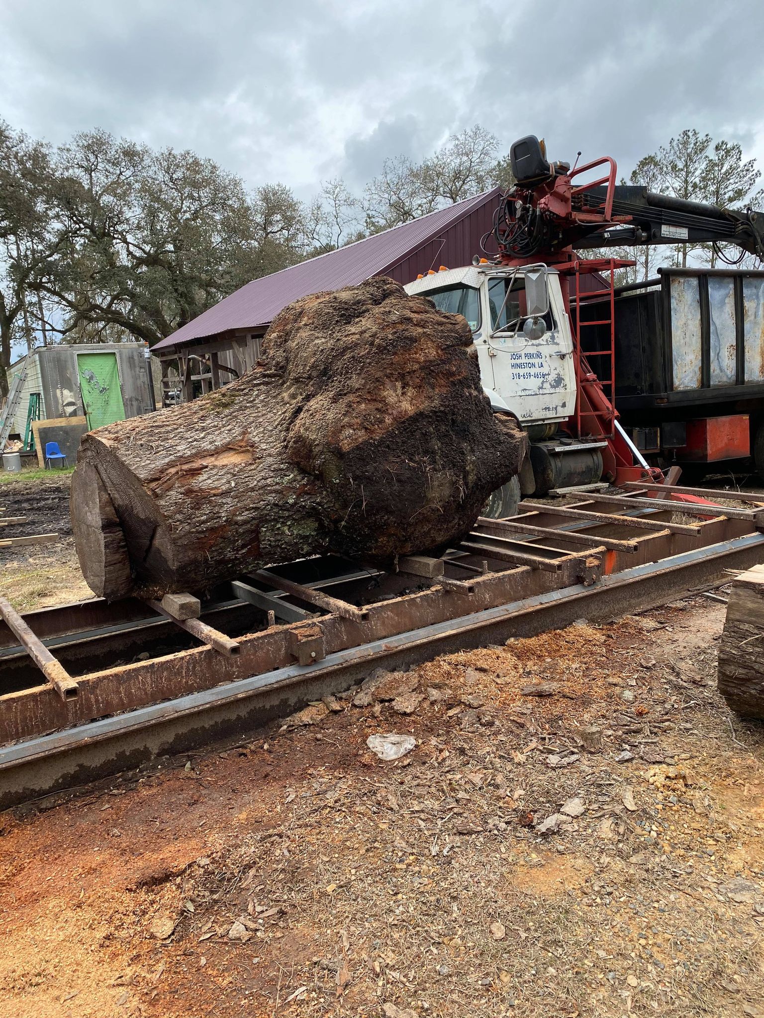

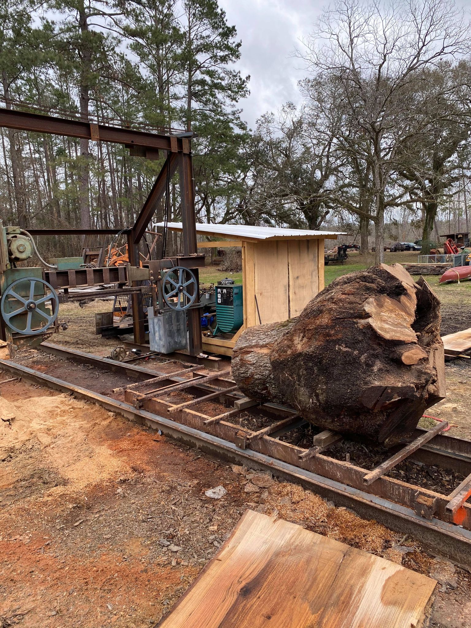

I have this Oak Burl that it 6ft x 6ft including the Stem of the tree. I've never cut one before of any size. I need advice as to how thick I should cut the Burl Slabs off the stem ?.And any ideas about worth.

Might be too late since it is already on the mill, but your best bet might be to see if the closest veneer mill would want to buy it.
3/2/21       #5: Huge Oak Burl ...
Mark B Member
You may also find that the main stem of the tree runs down pretty far into the center of the burl and the juiciest material may just be out in the burl itself. Ive only sawn a few far smaller than that on my little mill but something I would think about would be slabbing something relatively heavy out of the pith (junk anyway) like perhaps taking a 3" thick slab right out of the center of it first to open it up and see what it looks like.
If the main stem (not very spectacular material) does extend down into the center you could then maximize the burl material outbound once you see what youve got. If the burl is primarily out at the edges you may be better off getting a mix of smaller slabs and leaving off some large heavy burl turning blanks (likely more value).
Would be really neat to see some shots of what you find when you open it up.
3/2/21       #6: Huge Oak Burl ...
Keith Newton
Most of the time when someone tells me about a big Oak burl, if it doesn't turn out to be a canker, it is just a big bump without any interesting grain, like the little bud-knots. However, from what I can see in your pics, this may be the real deal.
Before you saw, I would suggest you think about how you might market it. There may be a better buying market out there for bowl blanks than for slabs.
Do you have any close shots of the areas where the bark is off? If it looks like it's got the good stuff, I'll pass them along to some turners that I know.
