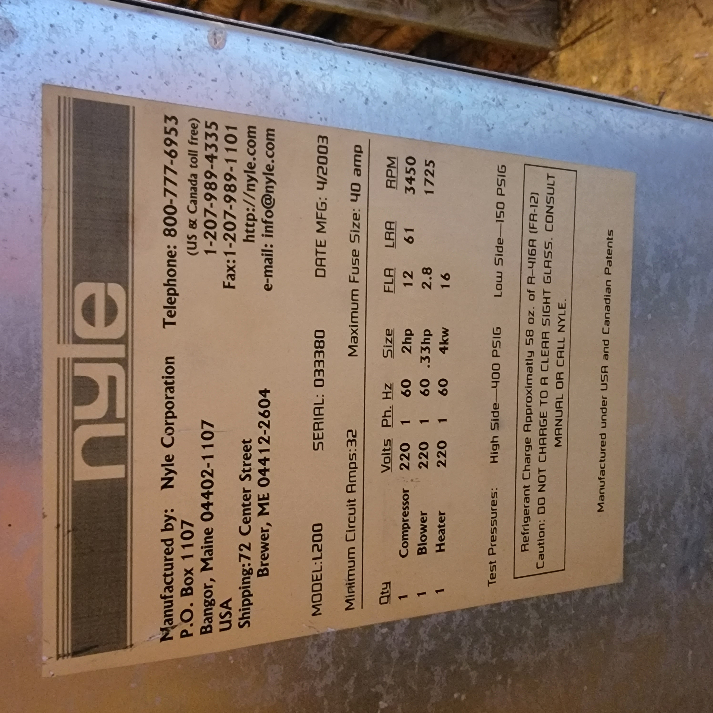

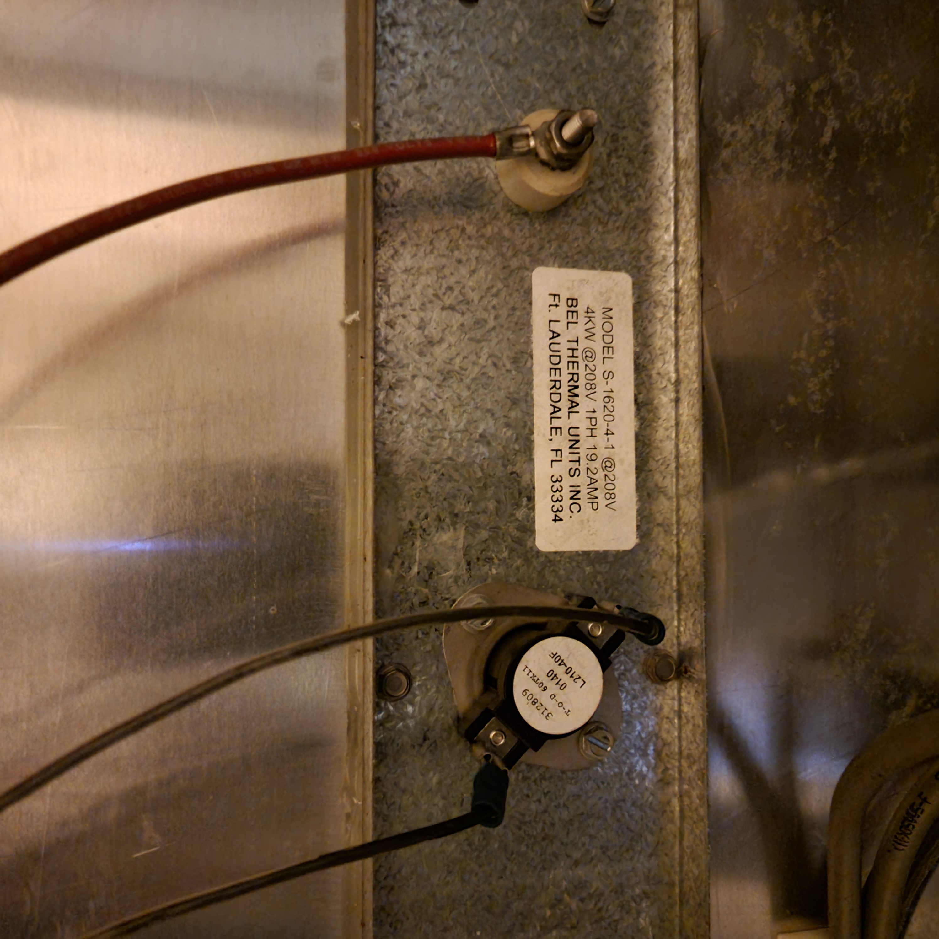

I purchased an older L200 nyle kiln last year and it was a game changer for our family eustic furniture business. It worked perfectly last season and has sat dormant since last winter. We loaded it full after our yellow Birch harvest this fall and flipped it on. Fired right up, electronics came to life, fan ran beautiful. Heating element inside did heat up. I contacted nyle and there answer was "that's probably the end of its life expectancy, you should probably buy a new kiln unit" unfortunately that is not in the budget so my question to you is this. Can I just cut the silicone,
pull a few screws and remove the element (it actually looks kind of like a plug and play situation) then slide a new one in. Any advice would be greatly appreciate thanks.
