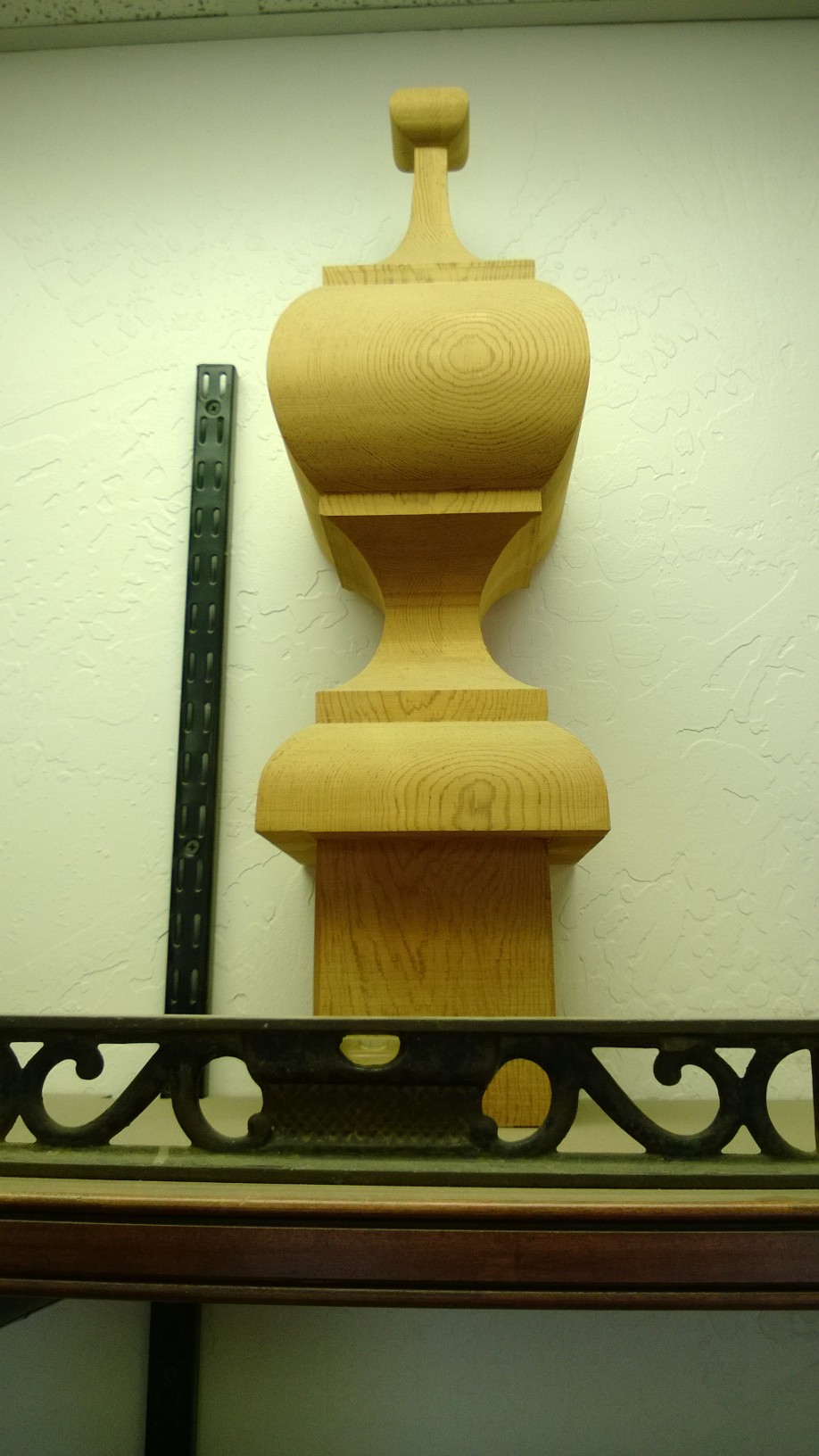

We cut a bunch of these roughly 8" x 8" on the Rockwell.
