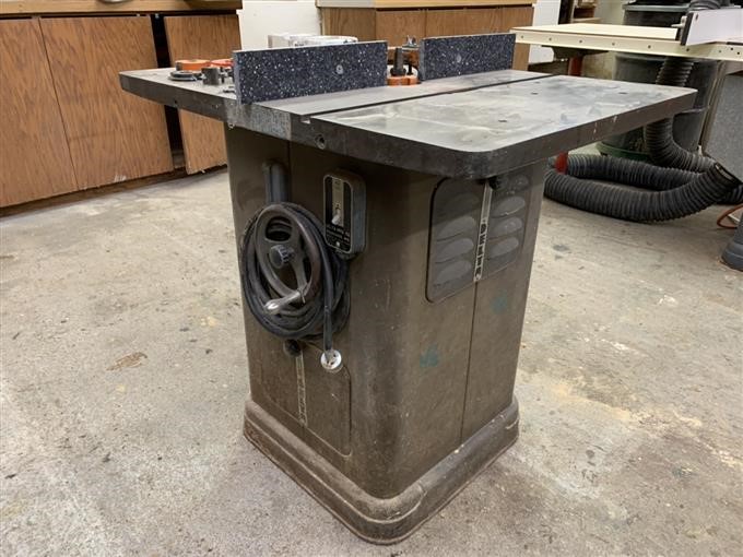

A router table is a poor choice if you are planning to do any amount of cabinet doors. If you are primarily concerned with cabinet doors and light molding you would do well with a used Delta/Rockwell heavy duty shaper. Although not "heavy duty" as the name implies they are very capable and robust machines (think of a Unisaw version of a shaper). They can also handle a full size feeder. I would look for used American made machines vs the imported new ones.
Rob

I have one just like Rob posted that I'd be willing to part with if your interested, just drop me an email and we can deal.
