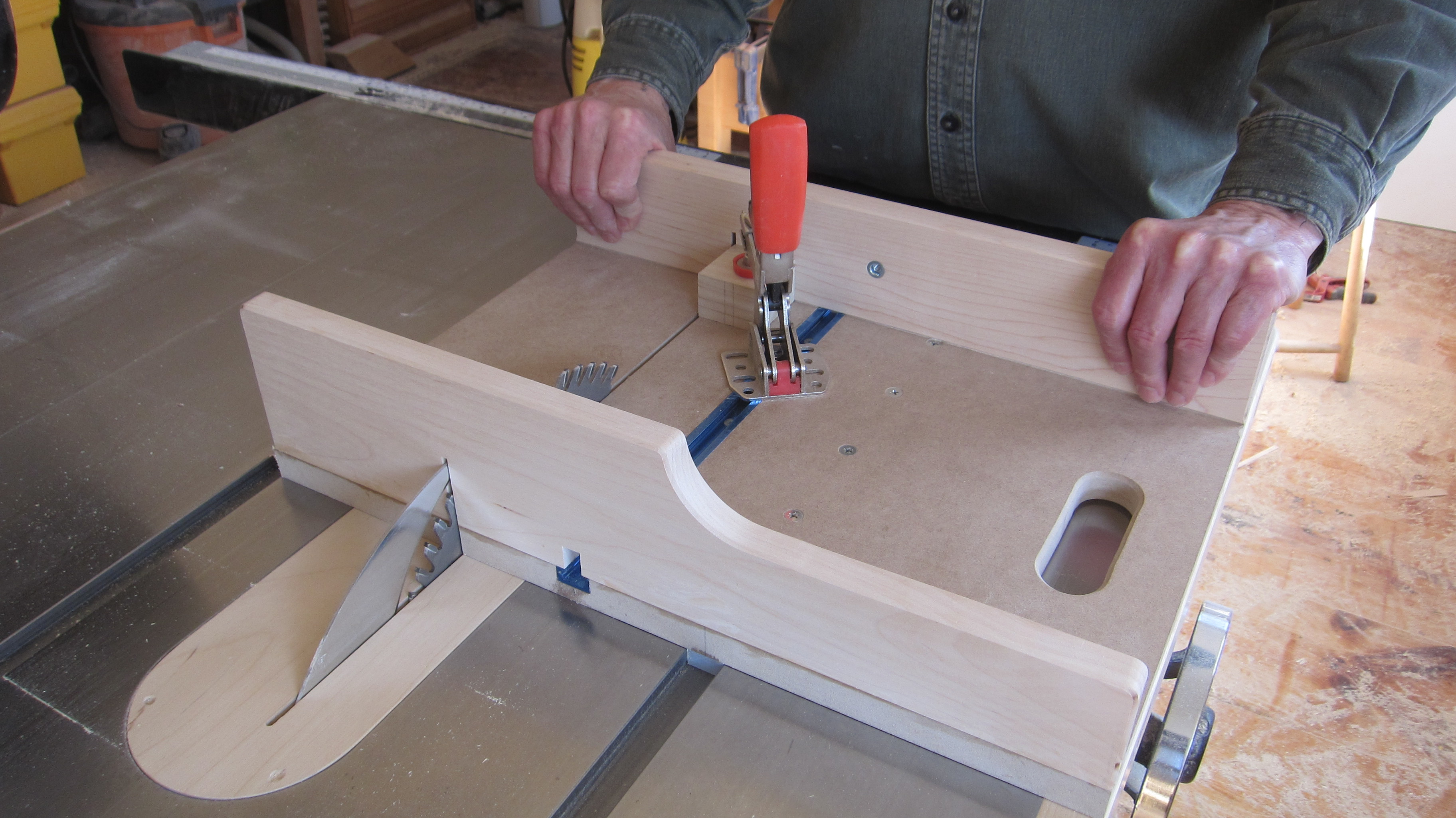

I made a standard size crosscut sled, then found that I was often cutting smaller pieces that would be better suited to a smaller lighter sled.
Some features implemented on the small sled:
1. Fence was aligned using five cut method, with a sacrificial fence.
2. Bessey clamp to hold small pieces that would be unsafe to hold by hand.
3. Clamp slides in a T-track that is secured to base with epoxy
4. Fence is designed so that accessories can be swapped between the sleds
