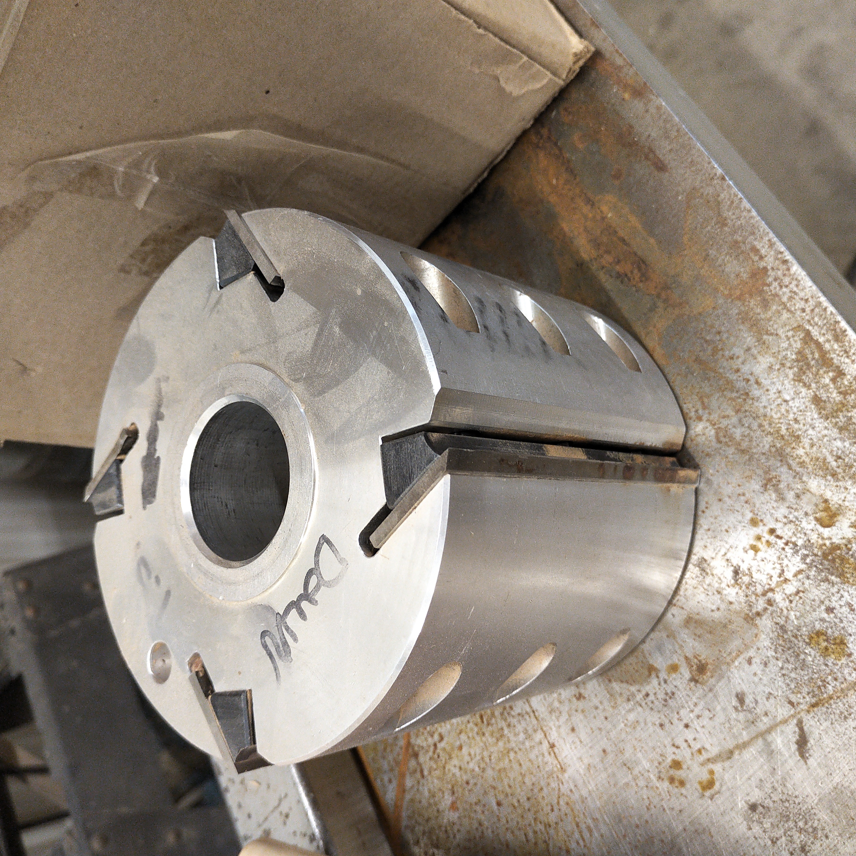

I know very little about boulders but we bought this one. It came with an additional set of heads. We are usingthe machine for s4s but can I do other than things with these heads? Asking for a dummy.

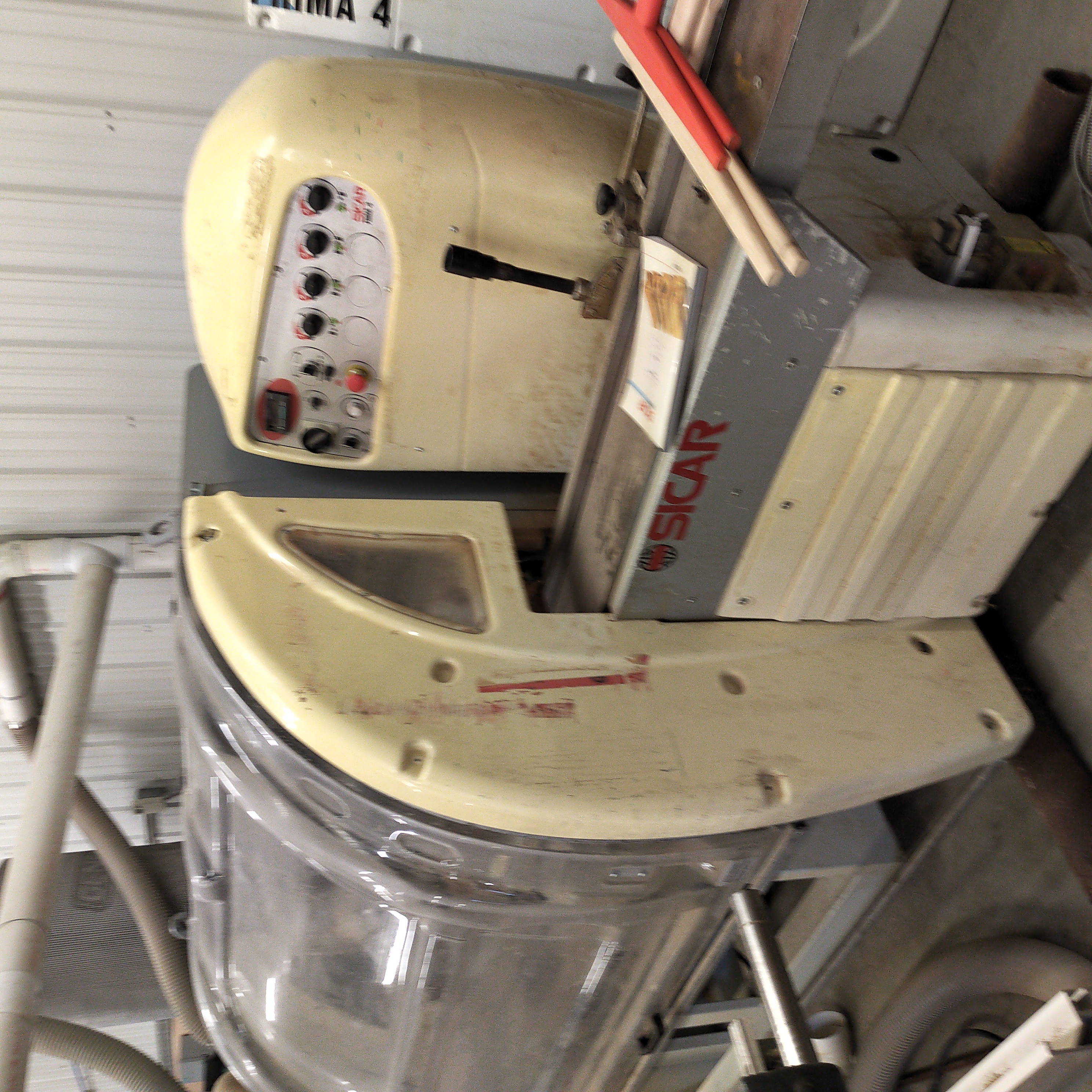

You need to check the maximum swing of each head, what you can cut and find the HP for each head. Once that is done you can answer your own question. Would I cut this on a shaper with the same HP and feed rate? What is the spindle diameter? That head doesn't look like a standard corrugated back knife head. Are the knives a carbide insert? Looks like a smaller SCMI 4 head meant for S4S. Don't know the particular specs on that machine, but most of the smaller machines can run small profiles due to limitations on both spindle HP and swing diameter.

This also looks like a Weinig Quattromat.
A basic S4S molder that could do T&G, beaded ceiling, small moldings, etc. The Weinig had digital readouts on everything so you would set the thickness, then the width, and all the hold downs, etc. moved. The first piece was perfectly on size.
Straight knives were a knock out type quick change that could even be changed on the machine.
It looks as if your machine has a jointer infeed and edger. The first bottom head infeed table can be set like a jointer to straighten lumber. The side cutter also straightens the side.
The digital readouts made this an S4S machine el fantastico. It was so easy to set: we would walk up to it, turn on the motors, set height and width and run just one board. It was faster than face and edge on jointer, them thru the planer: on edge 2-3 passes, then thickness 2-3 passes.
You have a real diamond in the rough. And despite what they tell you, Sicar is not Italian for Sucker!
