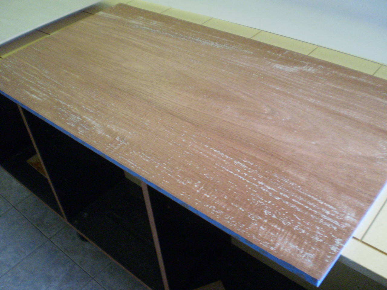

Another useful aspect of MDF is that its grain is very laminar parallel to the face. You can use too much glue (easy w/ quarter sawn) and, while seemingly stuck solid, the MDF will peel off the veneer. The image is my worse experience w/ bleed through (wasn't thinking quarter grain).
