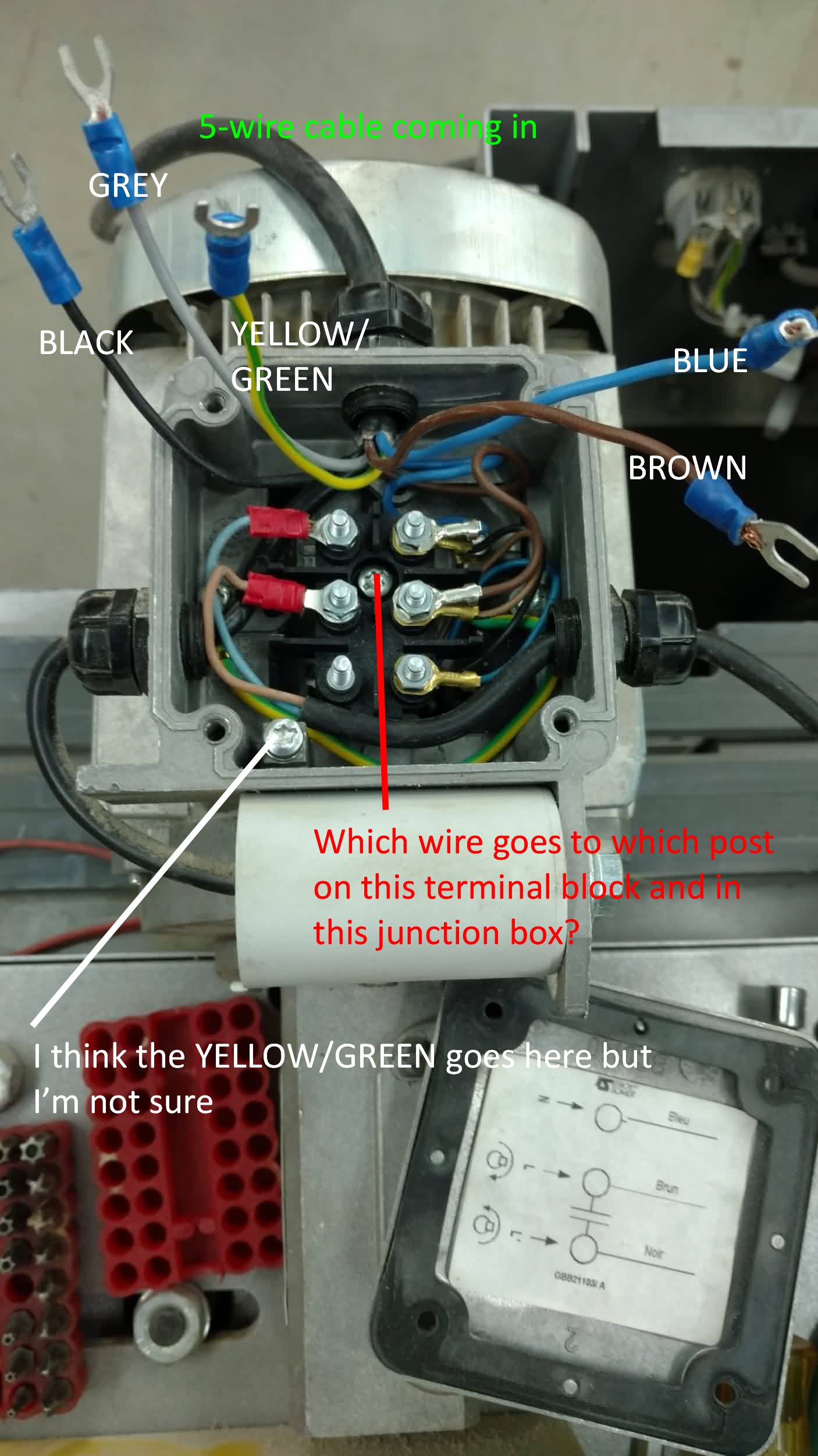

I have the Virutext EB25 edgebander. It has now been inoperative for over three months because of lack of response from "customer service" at Virutex.
Mounted on the side of the feeder motor there is a junction box. There is a cable with 5 different colored wires coming into that junction box and posts in the box to attach the wires to. The wiring schematics on the EB25 do not clarify which colored wires go to which posts. I've attached a picture of the wires and the junction posts.
Are there any EB25 owners out there that might be able to help me get this wired together so I can start using it again. Virutex won't or doesn't seem to want to be any help on this issue. I have been getting some limited help from one gentleman but it seems he's been getting stonewalled in his own organization.
THANK YOU in advance.

Don Thomson Member
Thank you Tony.
I've got that diagram but it's very unclear about which wire goes to which post in the junction box. Plus the wire colors in the schematic don't match the wire colors on my machine. That makes it really tough to figure out what goes where. I'm working with a guy that is really trying to help me. But his boss is completely unhelpful in getting the information needed and the guy I'm working with has no other phone numbers to call in the company for tech support. It's so frustrating.... :(
I guess what I would be really helpful is if someone that has an EB25 to take a picture of that junction box on their machine and tell me which wires go to which posts. That would be a thousand times better then tech support from virutex.

TonyF
Don:
If I had to guess, the yellow/green goes to the grounding screw. The position of the block on the schematic is your photo turned 90 degrees clockwise. The brown and blue are shown in their proper position, and you would need to determine whether the black or the gray is the wire from the microswitch.
But of course, you don't want to do this based on my guess. You might try an inventory search of some used machinery dealers, see if any have this machine on the floor, and see who would be willing to photograph the wired junction box for you.
Good luck.
TonyF
12/17/17       #7: Help with Virutex EB25 wiring issue ...
MarkB Member
If you are unable to do so yourself do you not have a local electrician who could trace out the leads for you? Micro switch and motor control doesnt look to involved to diagnose with a multimeter and a sheet of paper.

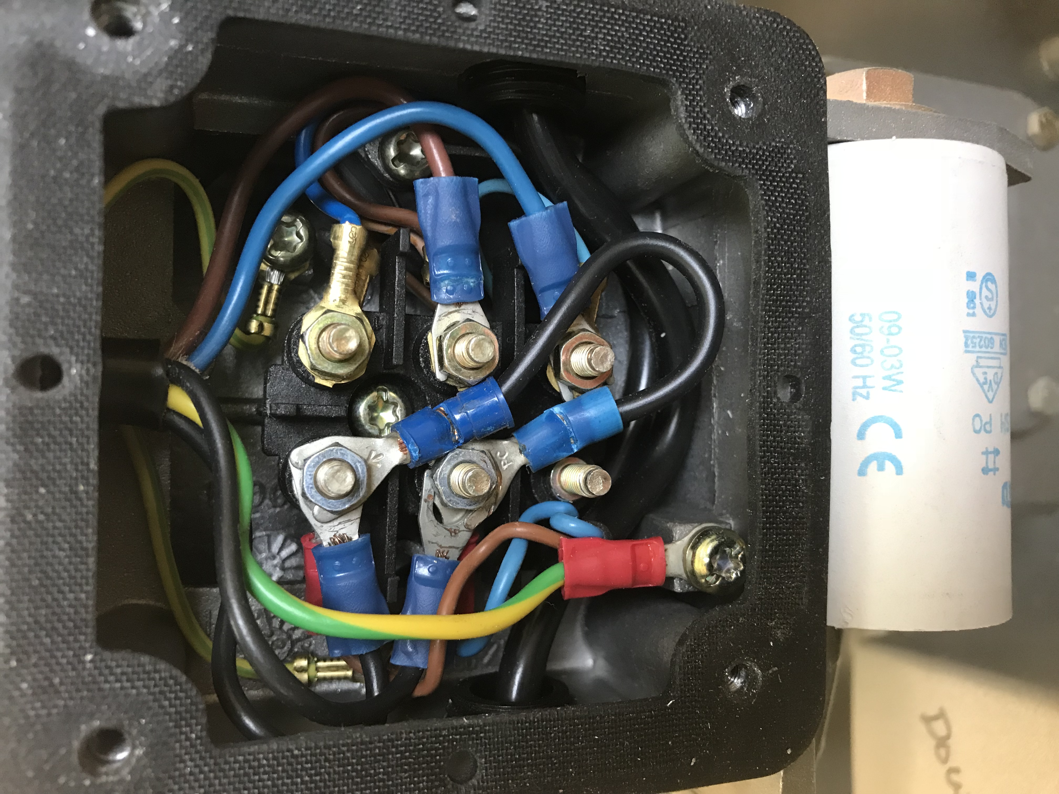

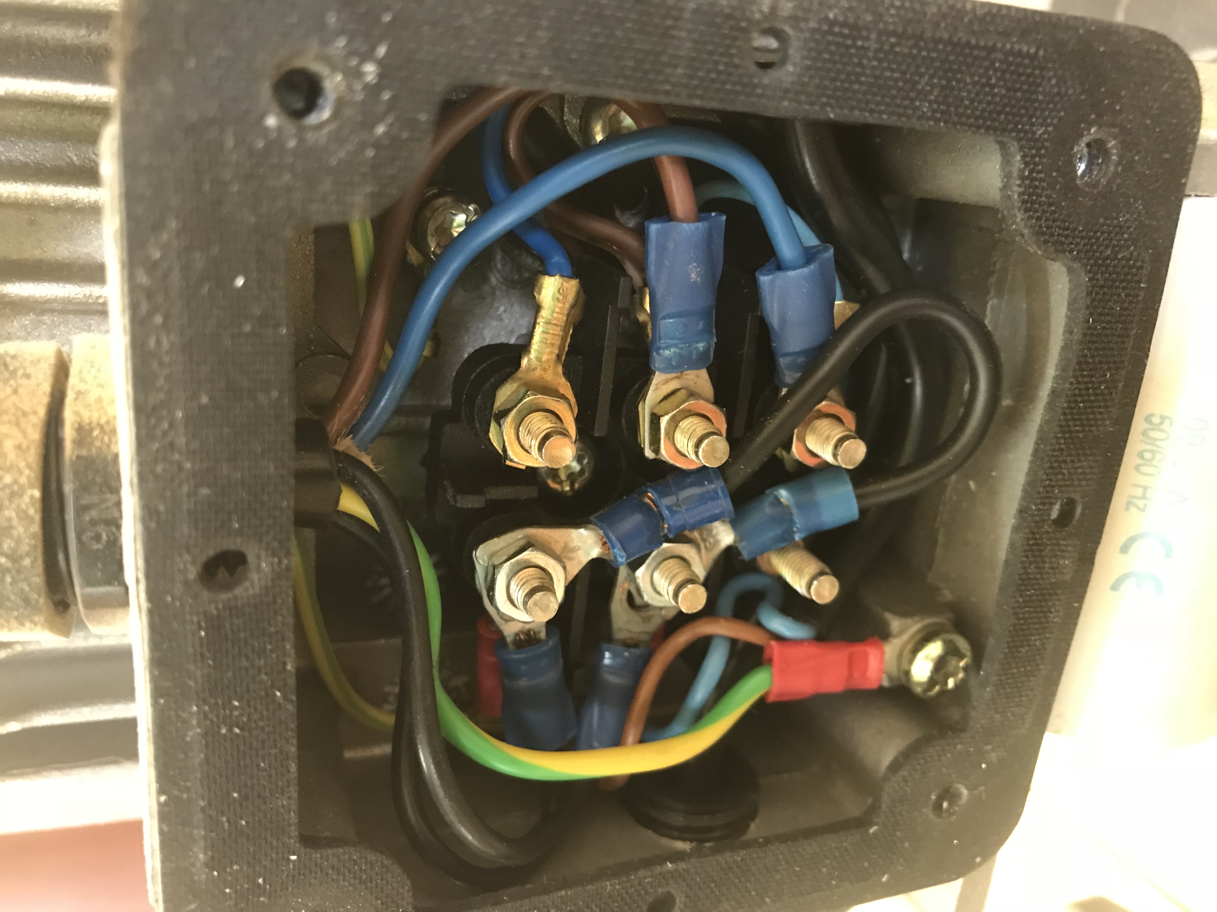

Matt Calnen
Wish I could have sent this sooner
12/21/17       #9: Help with Virutex EB25 wiring issue ...

12/21/17       #10: Help with Virutex EB25 wiring issue ...
Don Thomson Member
Matt, YOU ARE A LIFE SAVER!!! Thank you so much. I can now get my door stop of 3 months operating again.

Don Thomson Member
Matt,
I hate to bug you again. I'm having a difficult time determining which post the black wire goes to and the grey wire goes to. The other wires are good.
Could you please help clarify where those to wires go? If you could maybe just let me know which post they go on. For reference, you can say the post with NO wires on it is #1. And go clockwise around the terminal block so the lower right one is #6. No picture needed. Thank you sir!!
12/26/17       #12: Help with Virutex EB25 wiring issue ...
Matt Calnen
Well, we have alittle problem. I don’t have a grey wire on my machine, but I think that’s ok. Now I’m not an electrician so, maybe someone with more knowledge than I could help with this. I have two black wires coming out of the 5 wire cord. One is connected to 2, the other is connected to 3. I assume on of those black wires in mine is your grey wire. If you look at my picture I sent, there is a separate black wire connecting 2 and 3, so I assume it would not matter which wire goes where. Again, I might ask someone with more knowledge than I. Hope this helps, and when your up and running I have a few operational questions for you. Happy New Year.

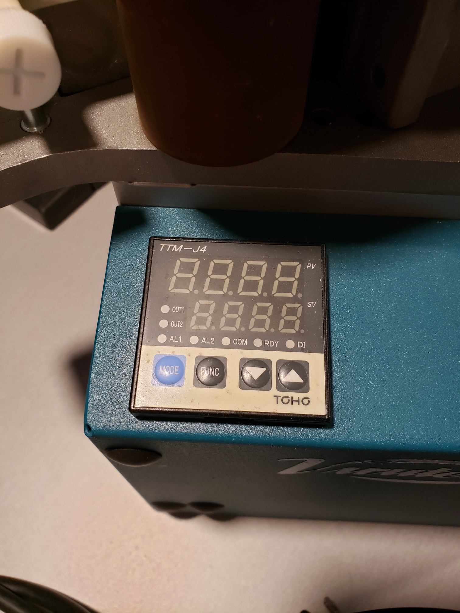

Mark Giesbrecht Member
I bought a new Virutex PEB50 in fall and it is still not running, seems to be a control panel issue. Anyone know anything about this? Virutex is no help at all!
Mark
