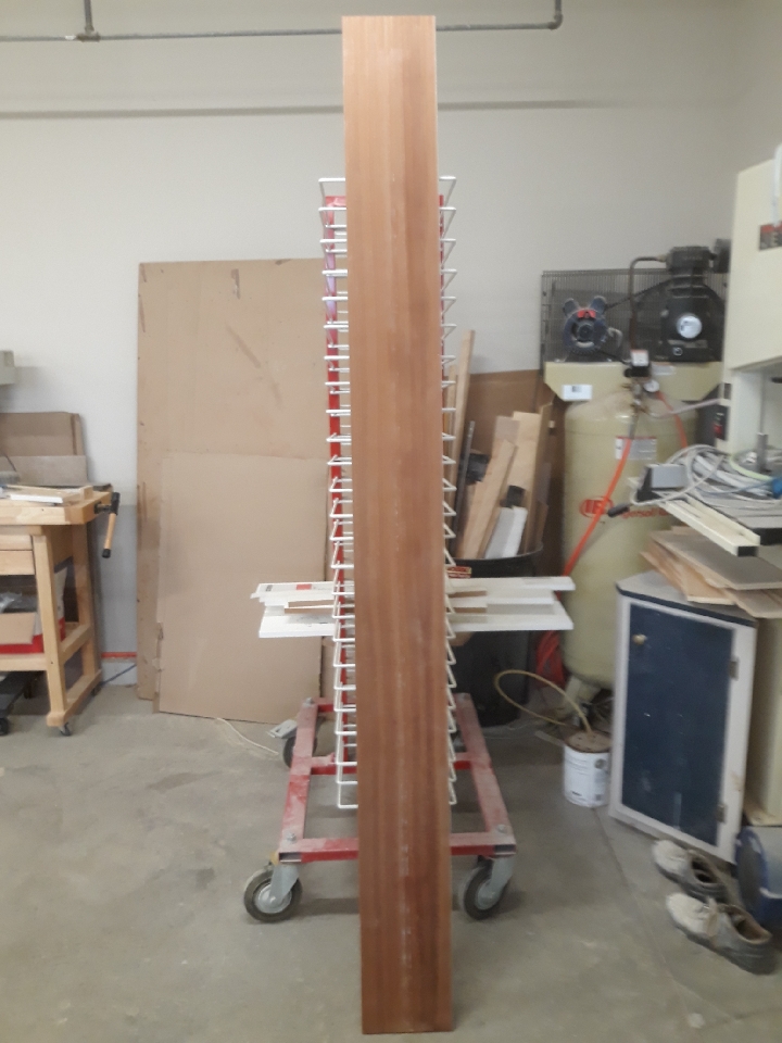

I have never worked with African Mahogany, but had a piece in my shop that a client saw and likes. (Not sure where it cam from) Its a few years old and has a nice reddish brown color. Looking at the stock at my distributors; the color is really pale in comparison to the aged piece.
Is it fairly certain that African Mahogany will darken to the "old" sample piece I have in the shop? See "old" attached photo.
Many thanks for any advise. John
View higher quality, full size image (720 X 960)

Will it darken? maybe. But if you pick from a pile and the wood is not all from the same tree, then every piece will be different. May not be much but maybe you will need to stain instead of leaving natural.

African Mahogany is one of the woods that will oxidize on exposure to air, and darken over time. Honduras Mahogany does so only slighlty. Cherry is also a wood that darkens. As does Poplar, Teak and others. Most Cherry buyers want their work stained dark ("rich looking") to get that color without waiting. More sun darkens faster.
It is reasonable to caution buyers that their wood table in the sunny window will develop a 'shadow' from that vase or runner or whatever is on the table and in the sun. These are very hard to get rid of, short of a sand and refinish.

Thanks for the responses. Khaya mahogany is what we have available. It would be veneer on MDF core for a kitchen, so all vertical slab panels.
My concern with staining is... wouldn't the wood color continue to get darker under the stain?
