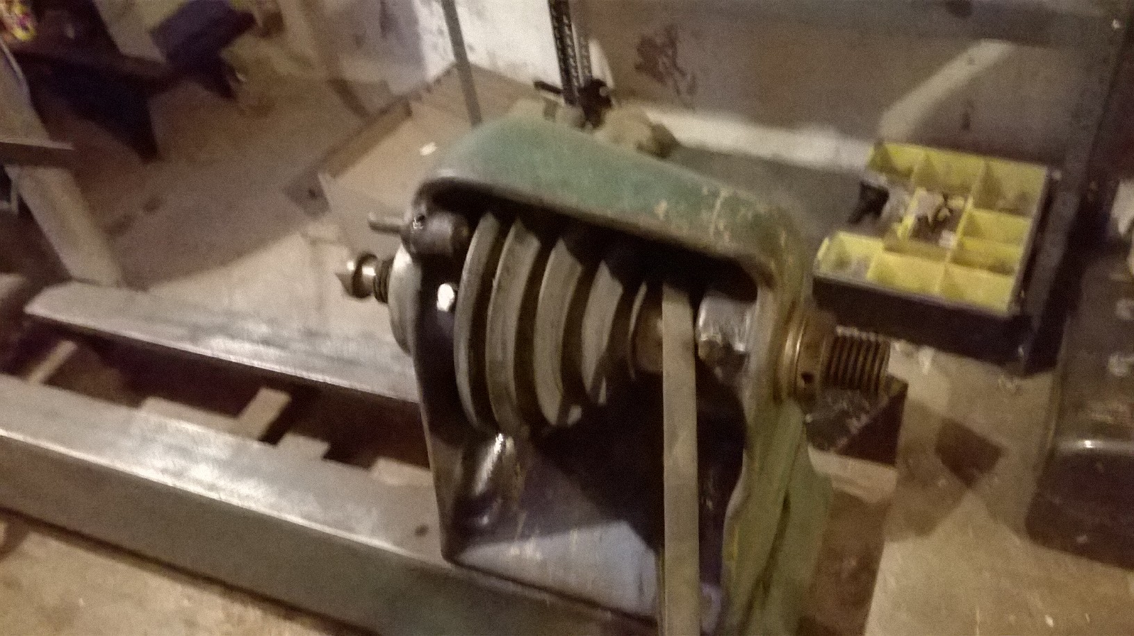

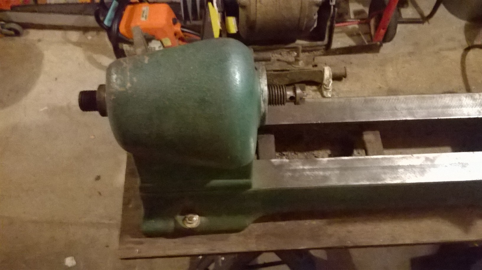

Hi all,
I picked up this dinosaur recently and was wondering if anybody happened to recognize it. Name plate long gone. Also, the last one I had te headstock shaft slid right out to change belt. This one appears to have modern bearings. I hit it with a hammer and the shaft barely moved. Afraid i need a bunch of punches and such I don't have. Any advice appreciated thanks...Joel

Try VintageMachinery.org.
Lots of info about old iron.

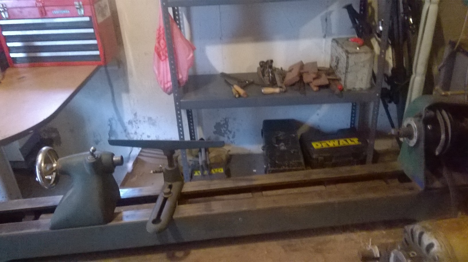

Thanks Dave I will. Here is a better pic if it jogs anyones memory.

It looks like an old Sears.

FWIW, if you can use a "Power Twist" drive belt, you can spare yourself the agony of trying to get the shaft out, and back in, assuming you only need to do so to change the drive belt. The bearings may be a press fit on the shaft, and you may damage them in trying to remove the shaft.
I second the Sears theory, as to manufacturer.

If anyone is interested it turns out to be an Atlas, Powerking, Crafstman. My new friends at OWWM.org helped me out.
