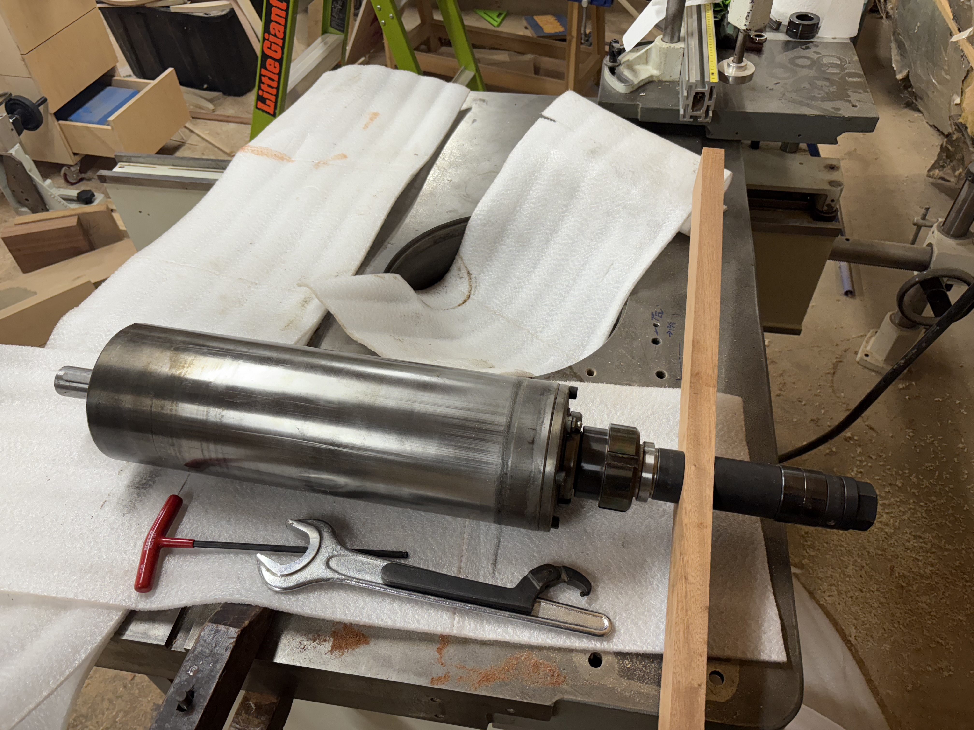

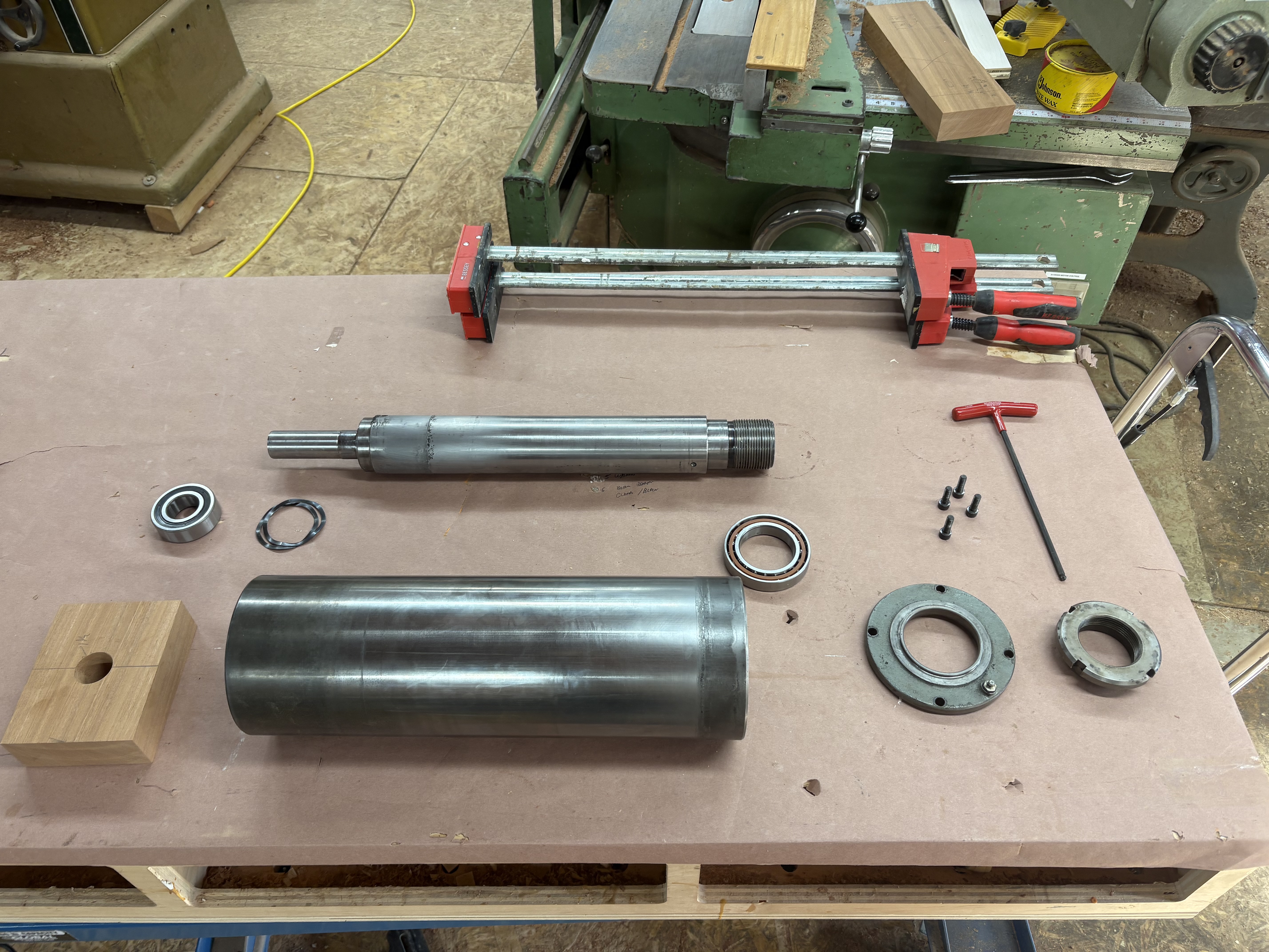

I replaces the bearings on my t120 two years ago.
Pulley needs to be removed off the bottom of the cartridge.
The whole spindle assembly can lifted out of the top.
Yours being tilting idk if there are any extra steps.
Pretty straightforward to replace.

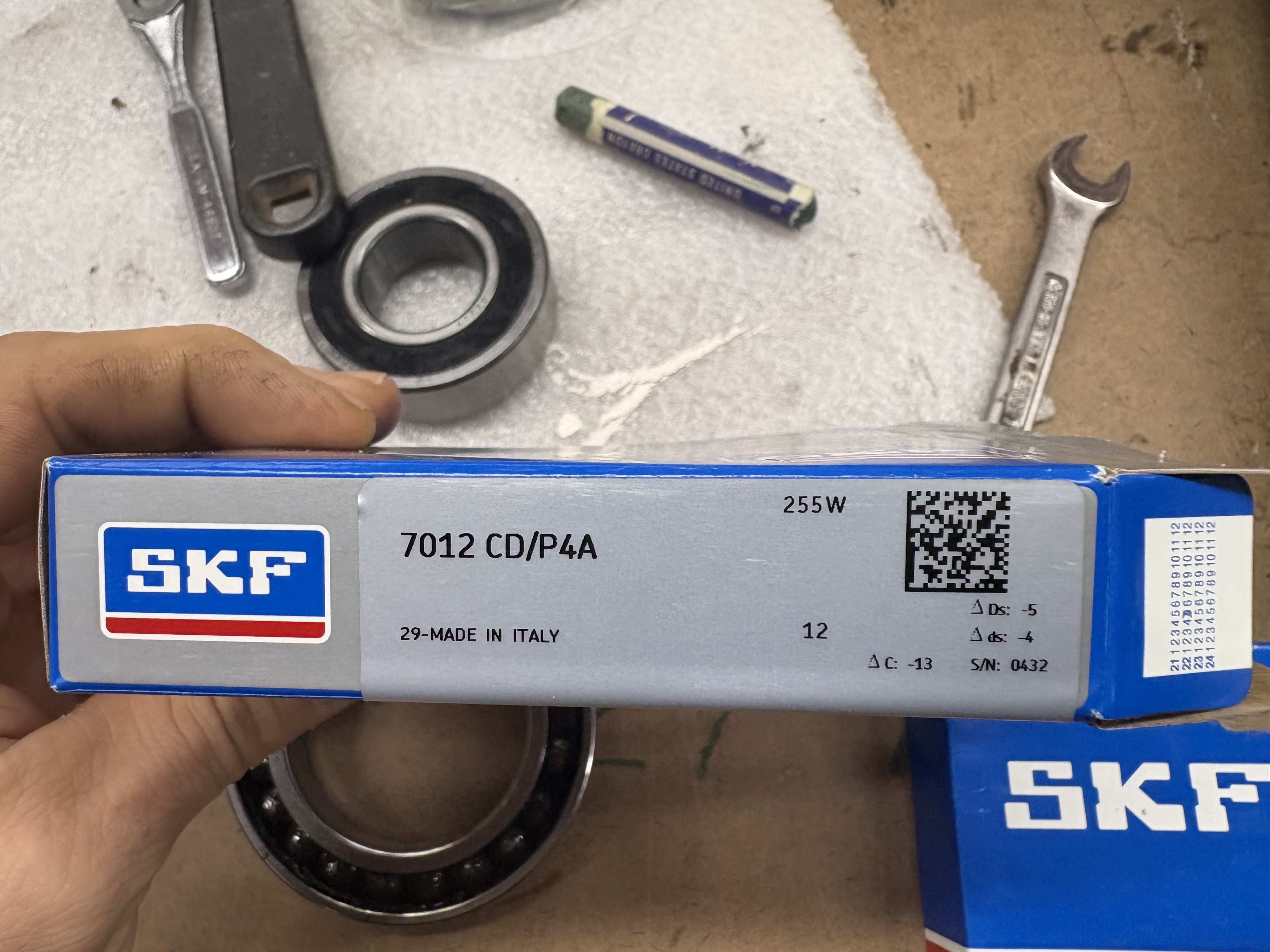

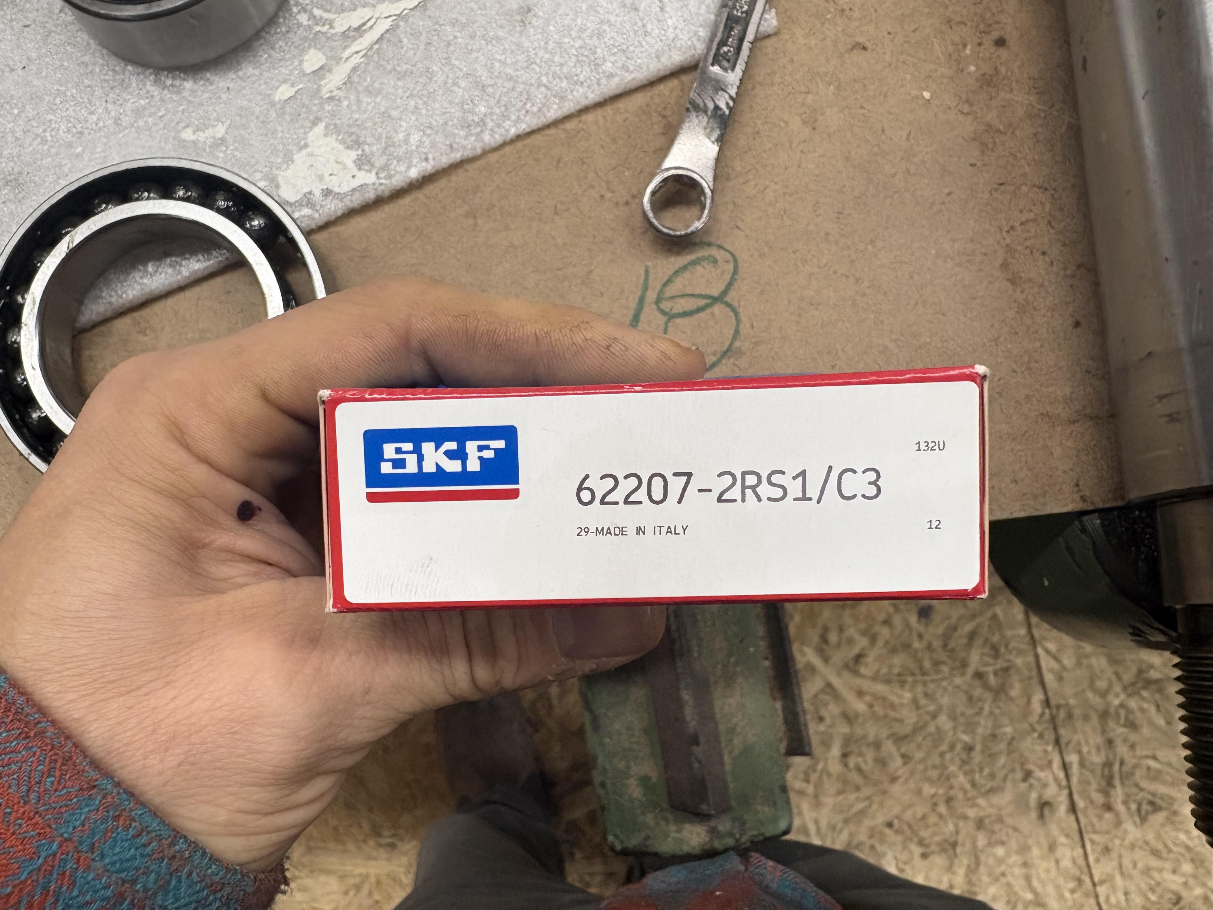

I used dry ice to shrink the bearing to replace because I do not own a press.
5/11/26       #3: SAC TS145 Shaper Bearing Replacemen ...
Tyler
These are the two replacement bearings
