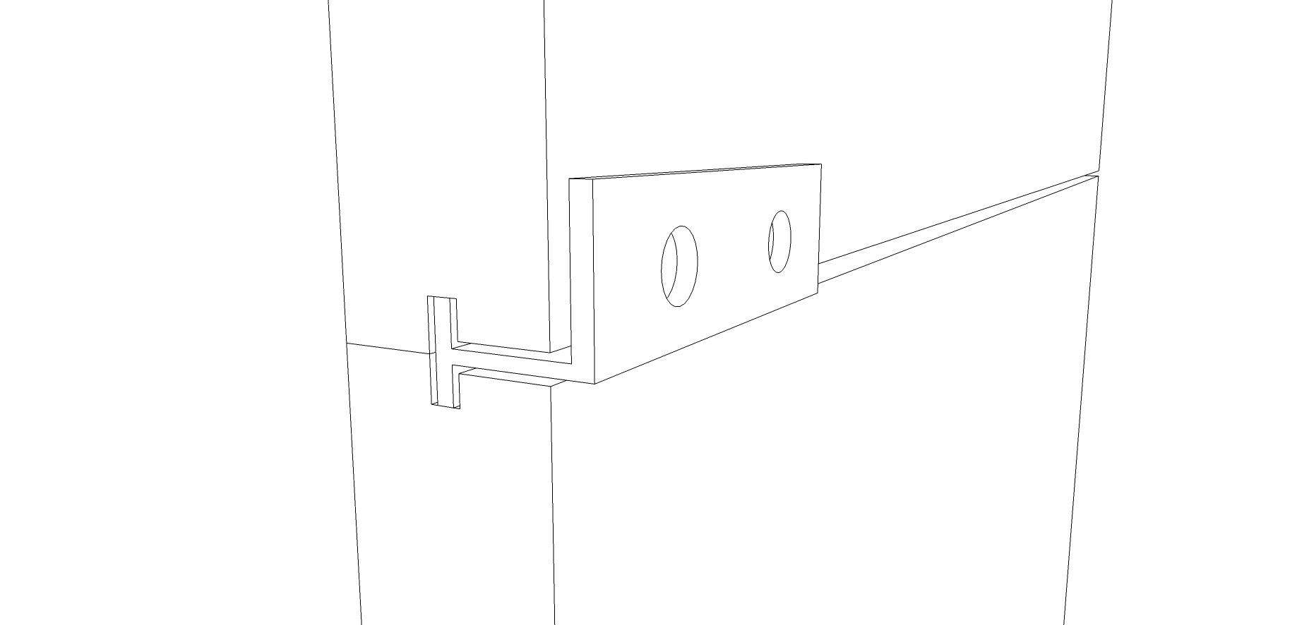

Could someone point me in the direction of a supplier of various types of hardware/clips for mounting wall panels? These are for a bunch of 1/2" thick x 12"w x 36" long dimensional wall tiles. We can groove the edges of the tiles accordingly. Picture is an idea of what we were thinking with screws through the holes into the wall behind.

Thanks Stuart,
With these tiles being so thin we were looking for an edge grooved holding system. Im not sure we could get any fasteners that we would trust in 1/2" thick materal

Rick W
If you can't find a suitable clip from a commercial source, you could make a clip like the one you show. You could make it from an "H" shaped aluminum extrusion by trimming off the flanges with a table saw, cutting to length, and drilling and countersinking the screw holes.
It might be worth making it if you had a small section of wall to do. If you have a whole building to do, then obviously it would be better to find some commercially available hardware.
