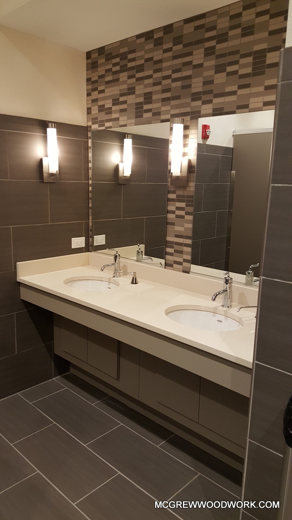

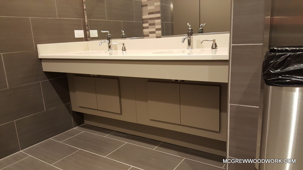

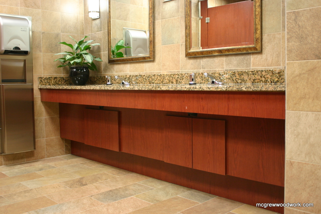

you can see in these pics the notch done under the sink to make the panel work.
The inspector on this one was a real right out of class who made us move the panel back 1/4 inch. and yes he was right to do so.
We are hanging the front panel on with "star Hangers" so if a plumber has a problem the panel can be removed without damage, the doors allow workers to change soap on electronic dispensers with out having to remove an angled panel.
pretty sure the 27" leg ht was approved here

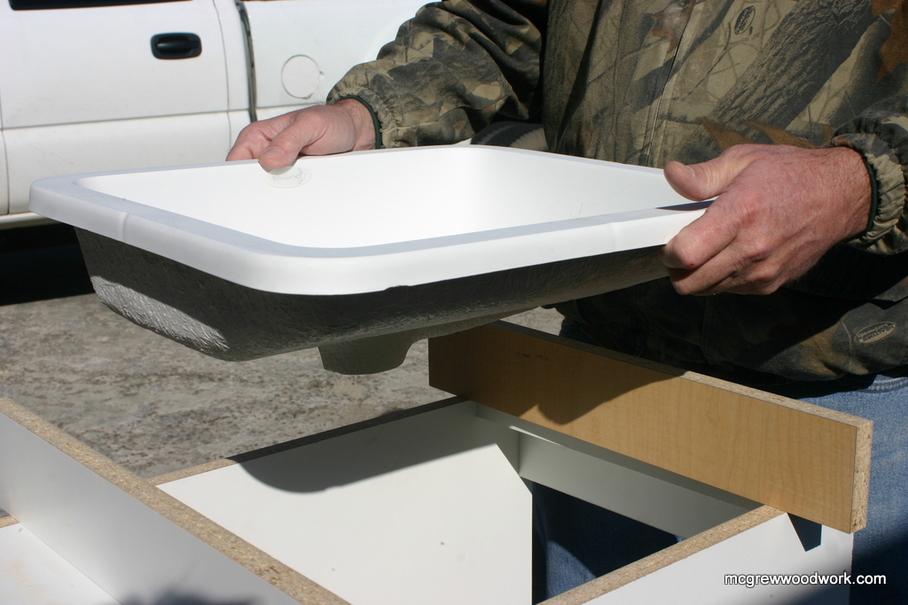

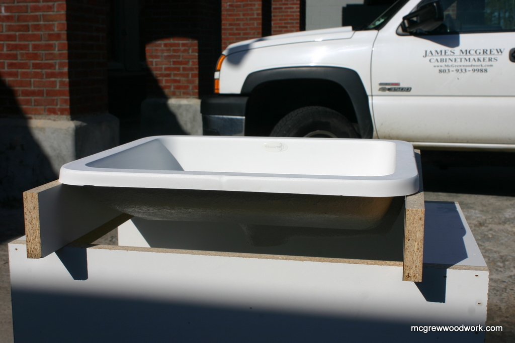

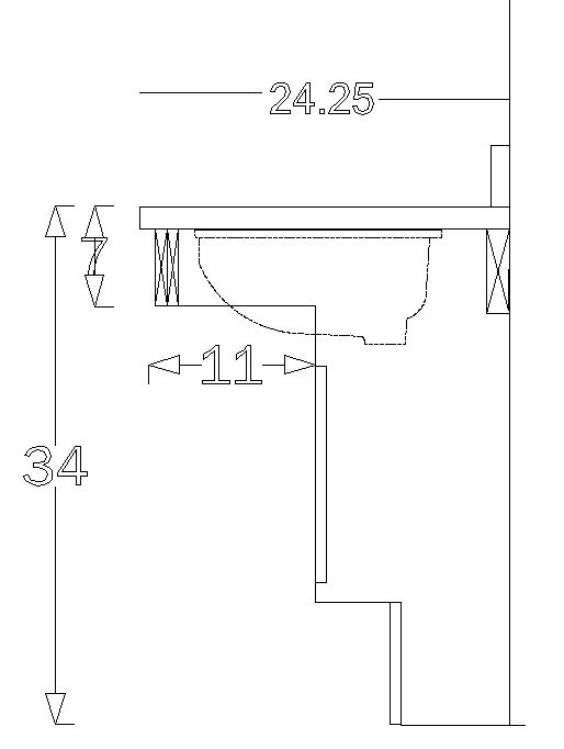

this is a cut profile of this style of ADA vanity.
I created this because we had major building clients with multiple floors who switched to electronic soap dispensers, the effect of this was lower paid cleaning personnel were damaging the angled panels by having to take them on and off every few days, most times it was not even the same person.
one new building asked us to re panel all 23 floors and refused a retrofit, we declined another company did this for them and withing three months they again asked us as the new panels were again damaged. again we refused as by this time we were way to busy and they had lost sooo much money on this they wanted a discount. (cannot fix stupid saving too much money)
previous to this soap dispensers were pump models and could be refilled from the top.
the dxf of the sink shown is the Kohler claxton, a most popular here in Columbia and claimed to be ADA by kohler. honestly they could do a lot better.
the notch you see is not the entire width of the sink from the front, it is an oval underneath, the most profound part is the over flow for the sink which if kohler would put on the side or back like wilsonart did would make this even better,
SOMEONE SHOW THIS TO KOHLER, I have not been able to get their attention.
1) this design has met the 27" rule x depth by federal, state city and county inspectors In my area.
2) do not do this without approval, by a certifying person. IE: architect engineer or code approval person.
We built a sample vanity for them to see before we built anything and we still get the sceptics. the landlords and designers love it. we put in few angled panels and we have done this at a major university, government and federal buildings

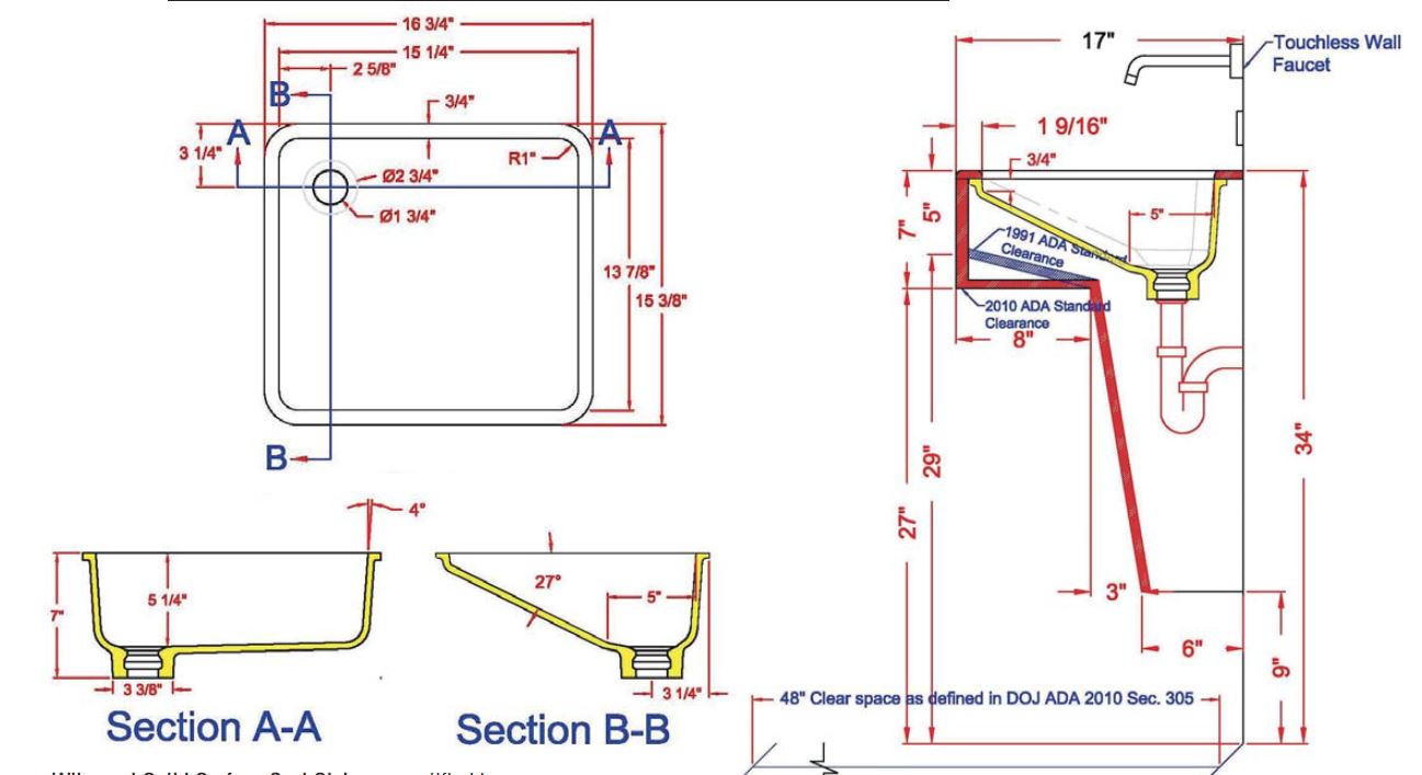

Wilson art got it right but it is an acrylic sink
View higher quality, full size image (1297 X 707)
wilsonart_bv15141.pdf
